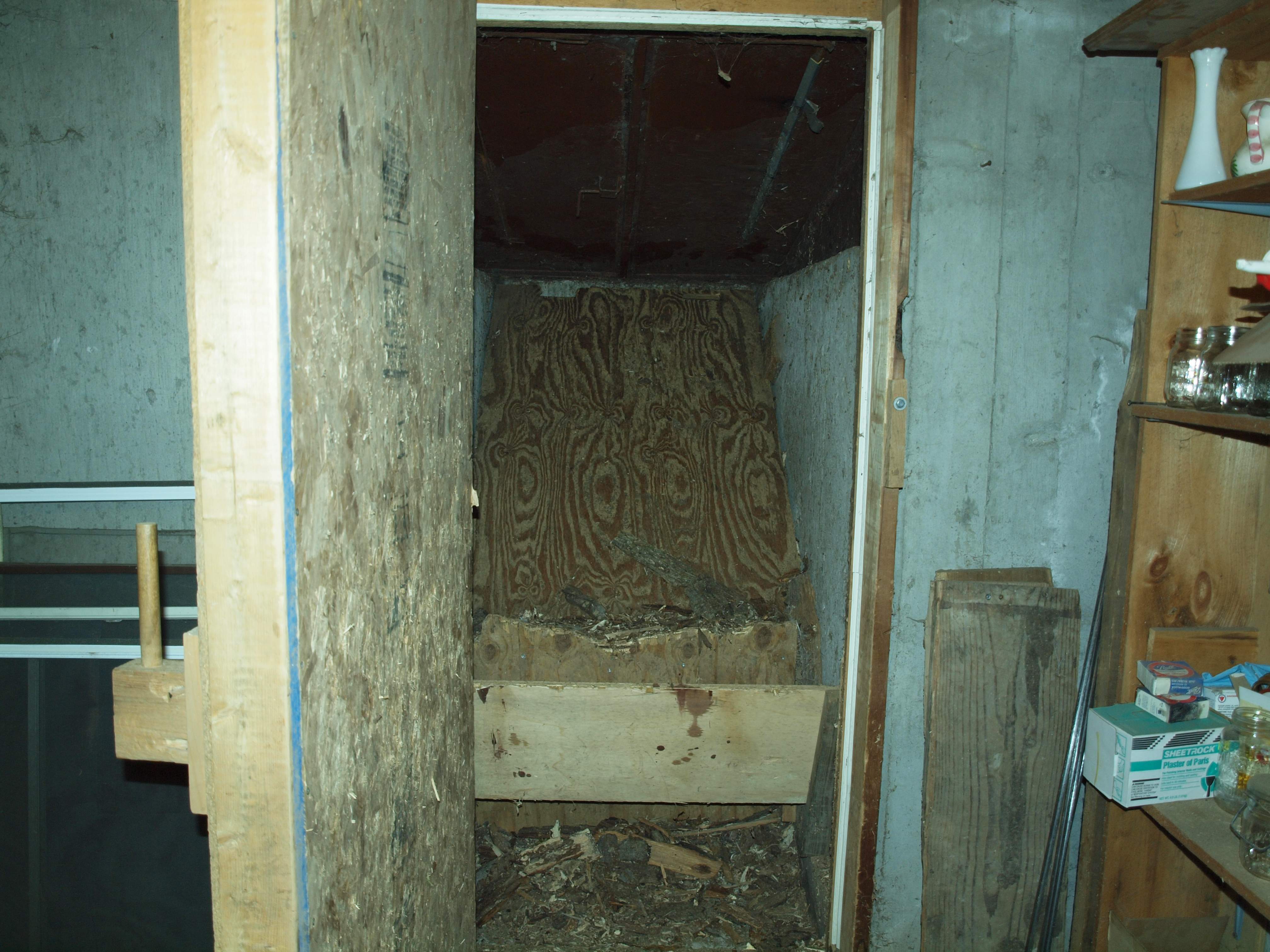

Pat, I do something very similar to your use of the bulkhead only I do no stacking. I built this door instead and insulated it. I just dump the wood in the bulkhead, open the door and feed it into the stove. No mess or insects coming into the cellar as the wood remains cold as it is behind the insulated door and then is popped right into the stove from there. Eliminates the whole stacking thing. The plywood is resting on the stairs and I just take out the two bottom treads so there is a space and a "blocker" between the door and wood so it all doesn't come tumbling out when I open the door. Because of the slant, the wood comes right to you as it is removed. I just place it in a small cart and throw the wood in the stove from the cart. After the season, I just screw in the treads and its a bulkhead again. Yours may be cement stairs but I'm sure you could rig up something.
