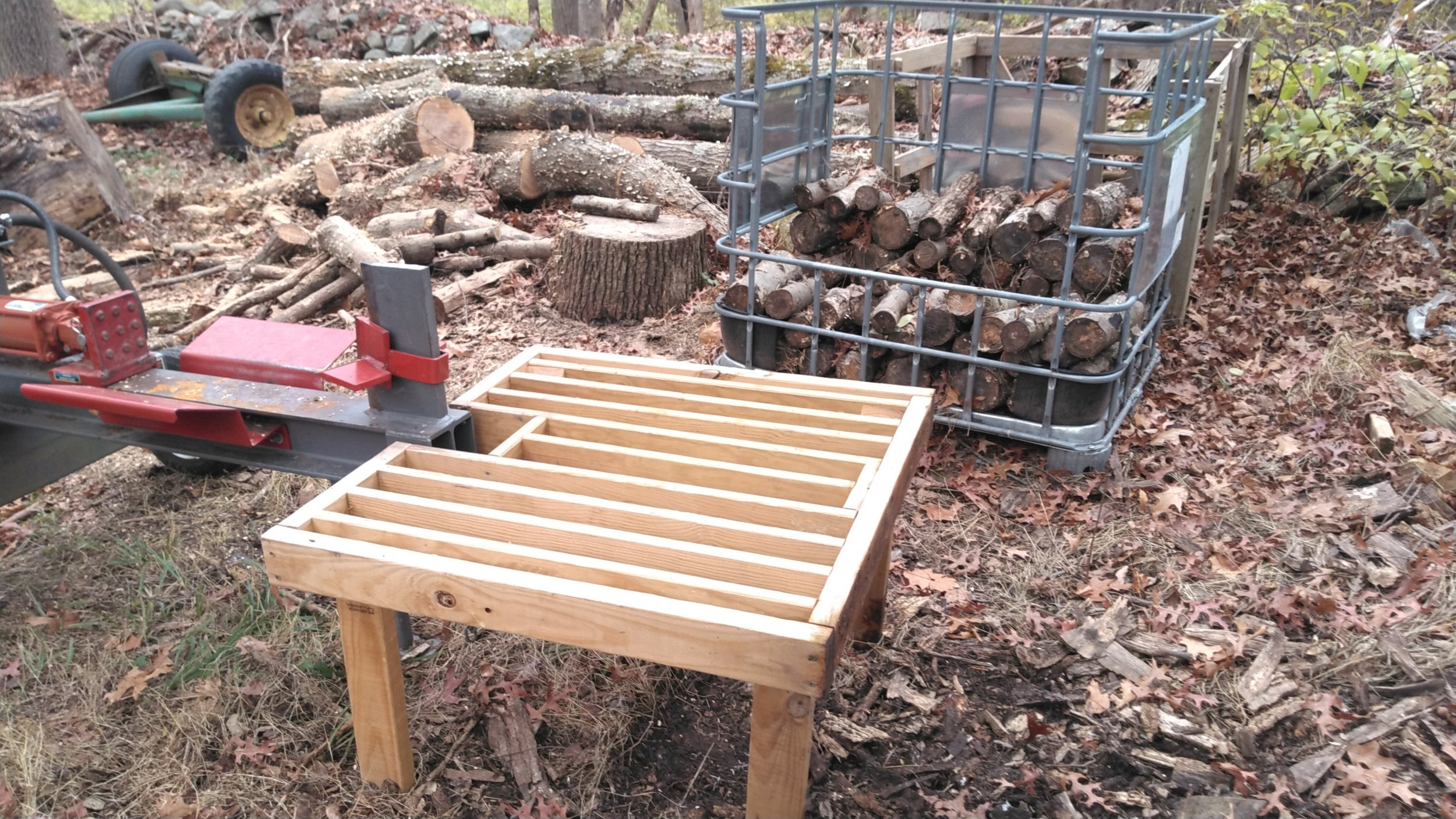

Not to derail the current topic path, but I spent some time outside splitting this weekend.
This was Saturday just as I was getting started:

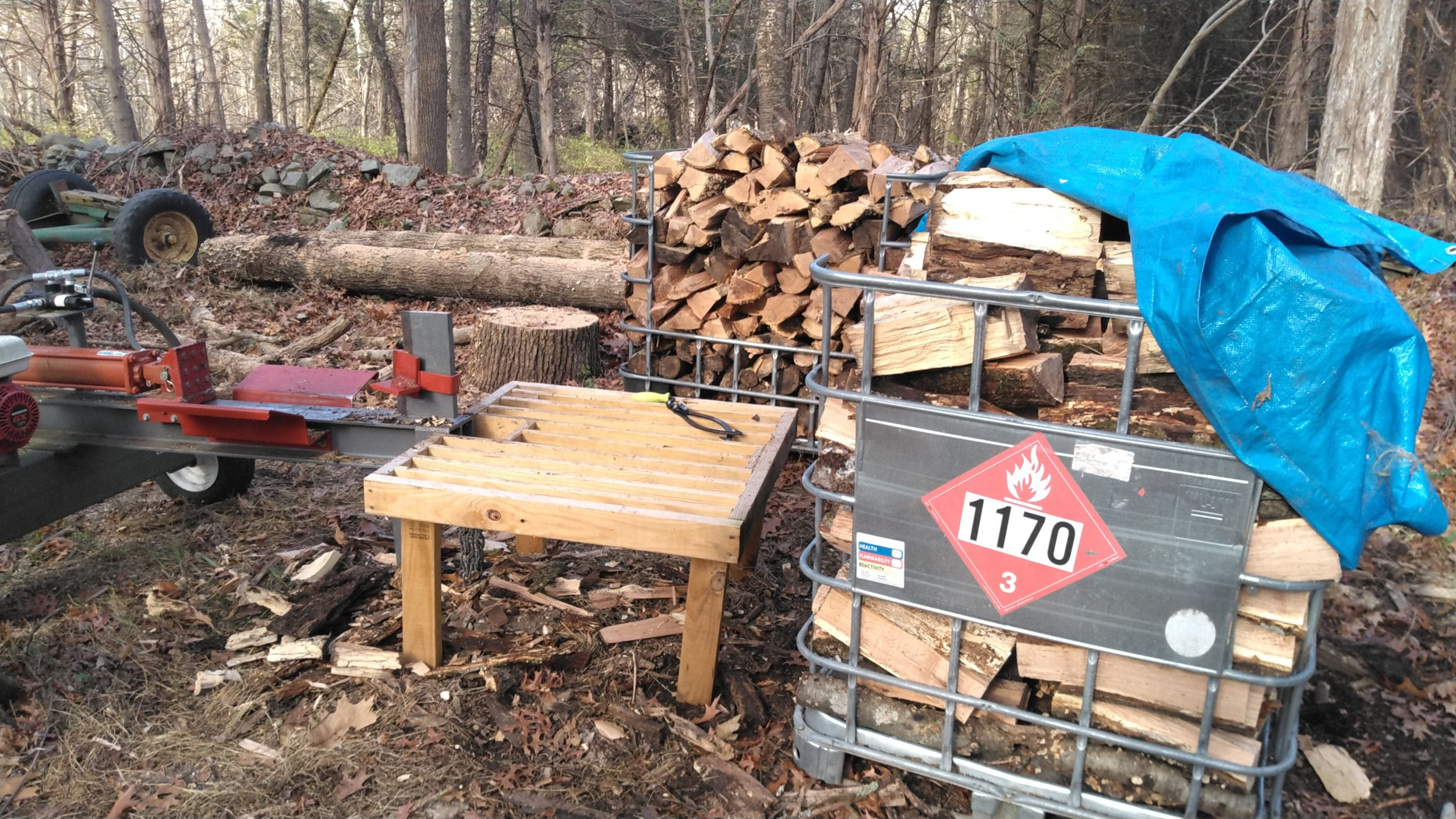

Then when finished, pretty much all red oak that's been in that pile since early spring. It got lighter, but still not dry, so I figure drying in the racks should get them there.

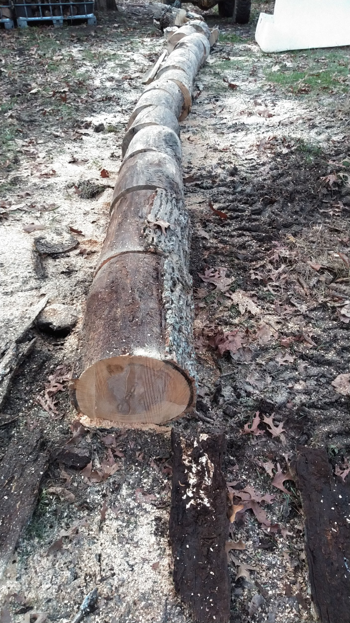

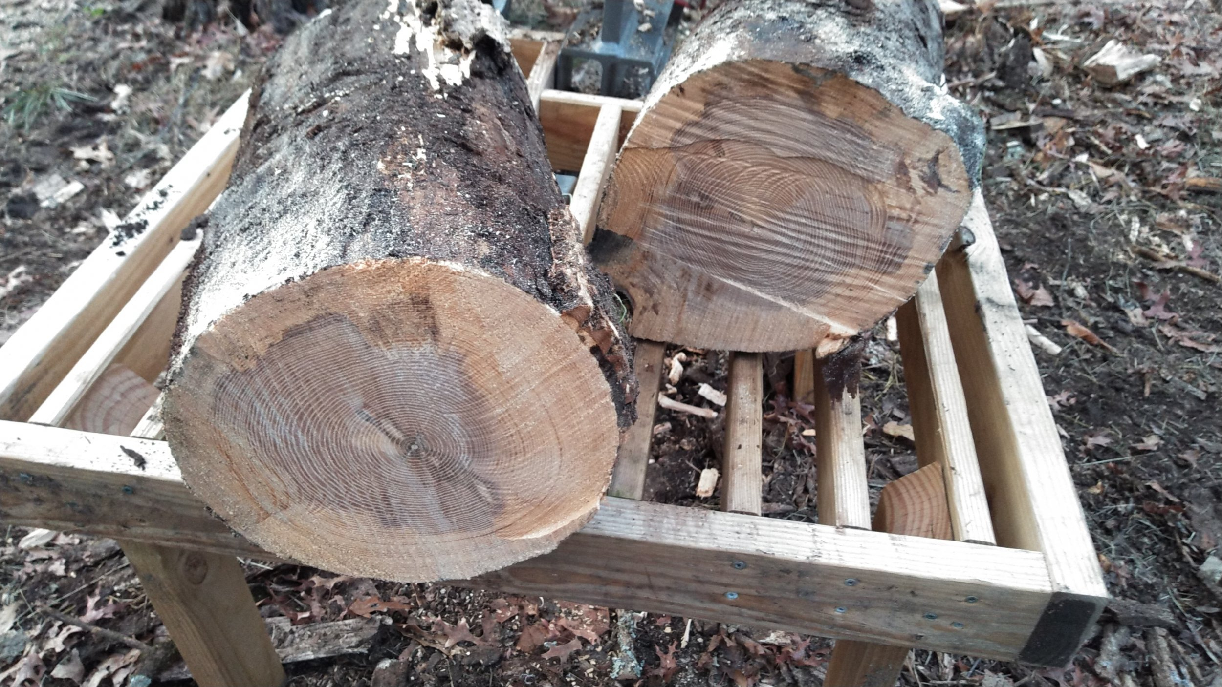

Then today I dragged this buete up out of the woods, it was about as much as the old loader could manage, at times I had to rock the bucket forward, then back up to tighten chain, then rock bucket back to get her to move, I guess I need lockers in the axles!!! The hill was a tad too steep and wet under all the leaves I blew off first.

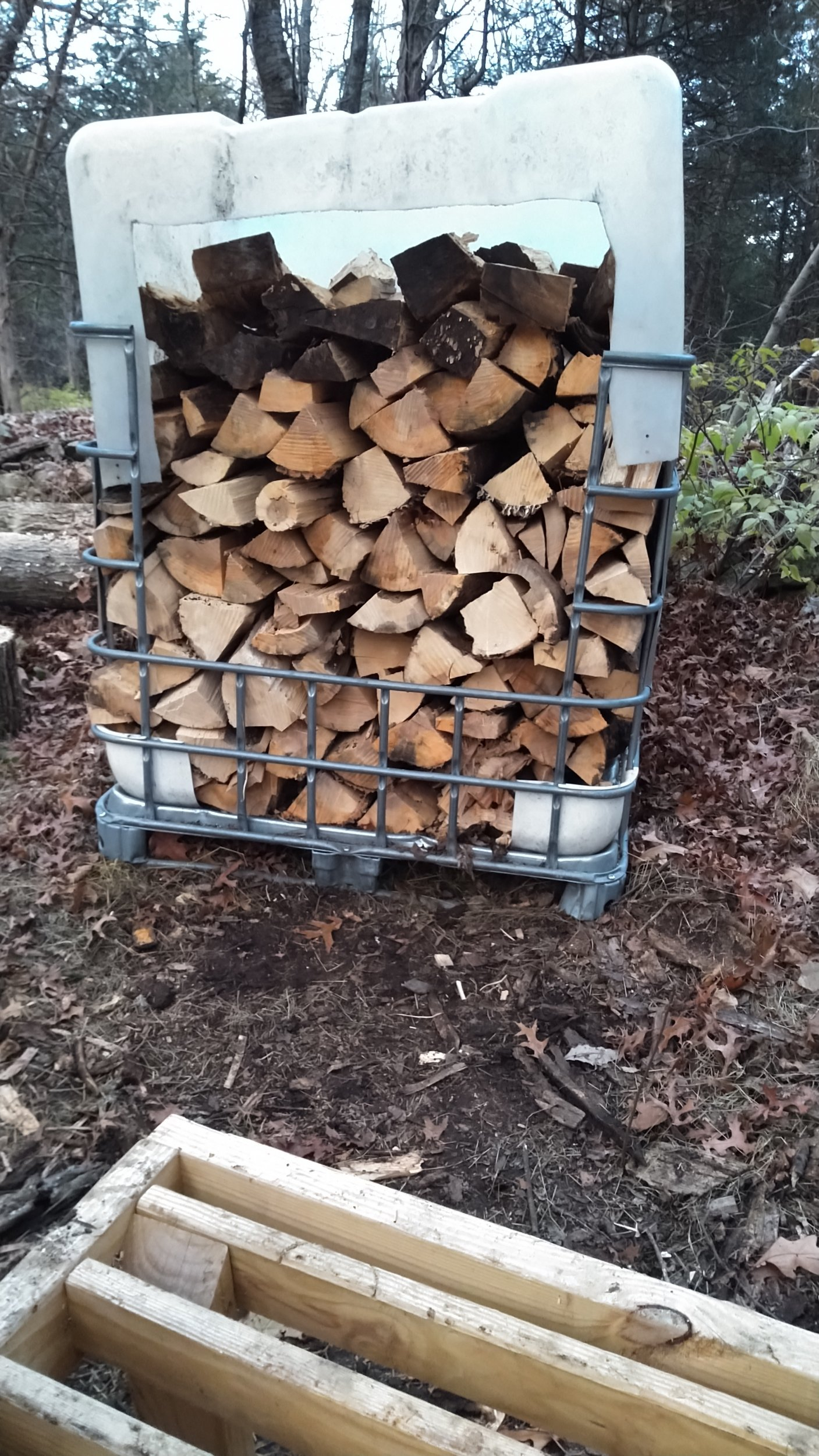

Then all split and packed in the tote. It's only 2 layers deep, and needed a few pieces of borderline punky maple to level off the tote. I'm thinking it's a dead Ash, the 9' totem pole is still down there, that'll be next weekends job.

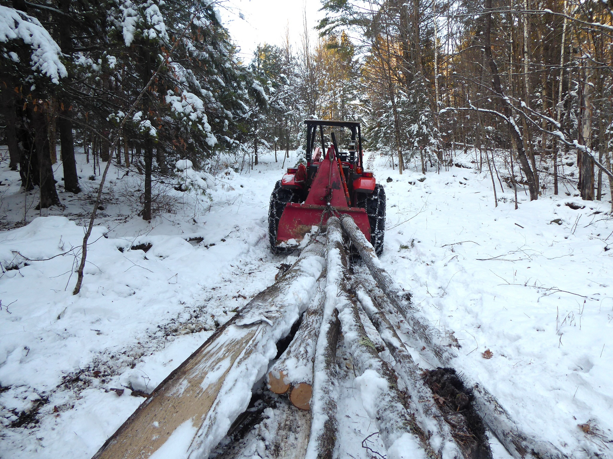

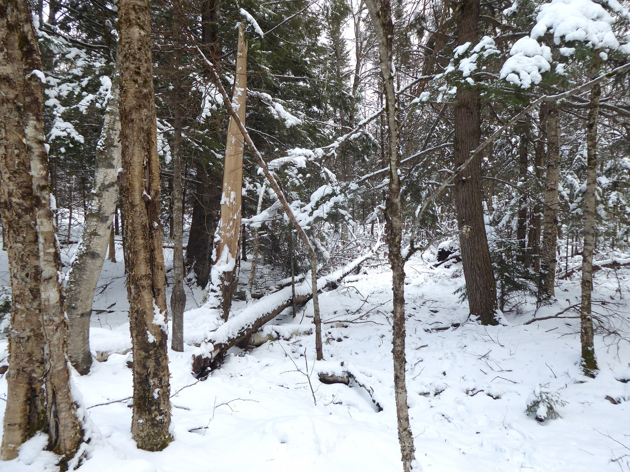

This is the time of year I like to pull out my firewood. It was warm enough today to fiddle with a camera. There was a good sized white ash in a boggy area that got blown over barber-chair fashion last summer. The top was back in ankle deep water.

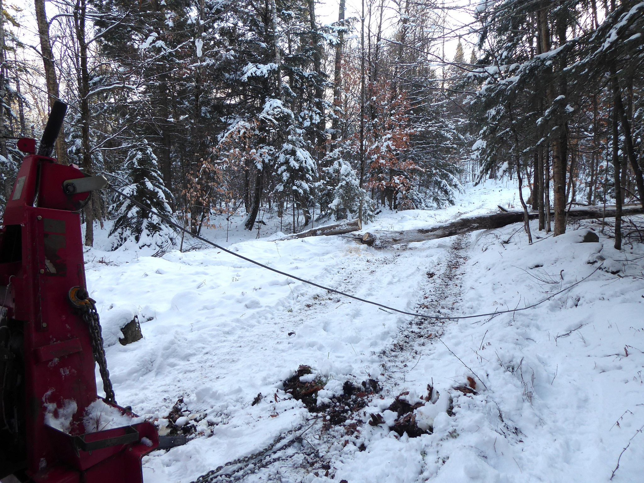

My plan was to pull it out as far as I could and then limb it out on dryer ground. I set up a snatch block on the far side of the road. I put out the camera to take a video of the set-up and winching. I thought it would make a good video if I was lucky enough to get it up over the bank and across the road. But if you have to depend on luck working in the woods you don't get very far. The tree got jammed just before it came in to view. Here is the anti-climax video anyhow. It shows the snatch block set-up and cable pull and an idea what I was trying to do.

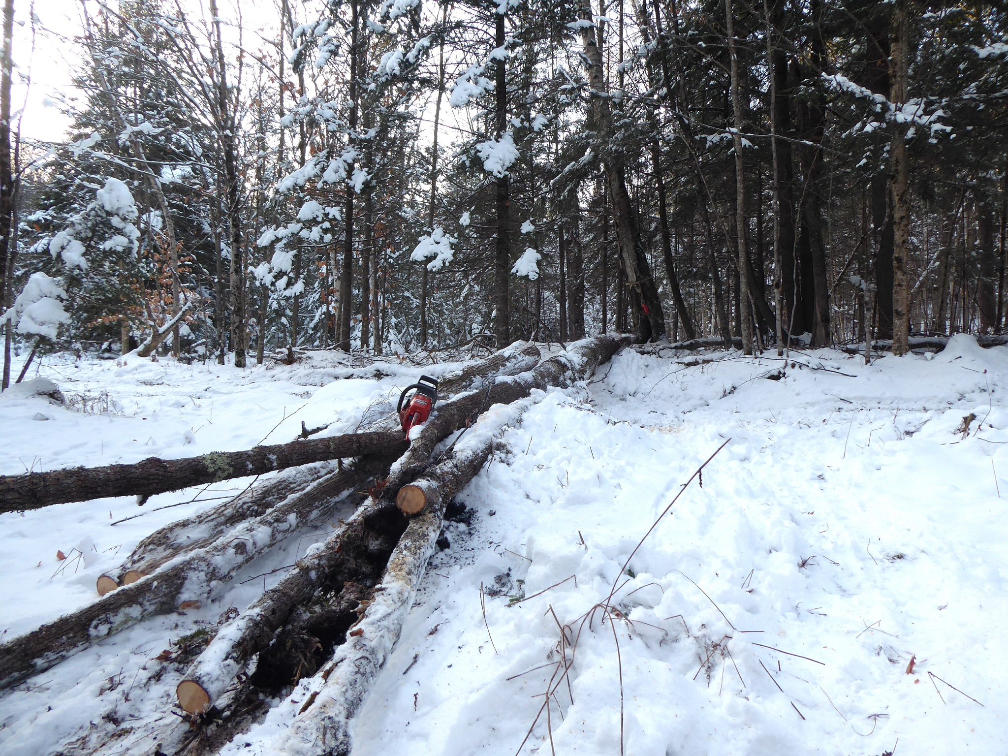

After the tree got jammed in a stump coming up the bank I limbed the main stem so I could free it and pulled the stem across the road. I cut it where I was going to pull the hitch.
Then I pulled the cable back and pulled up some big limbs.

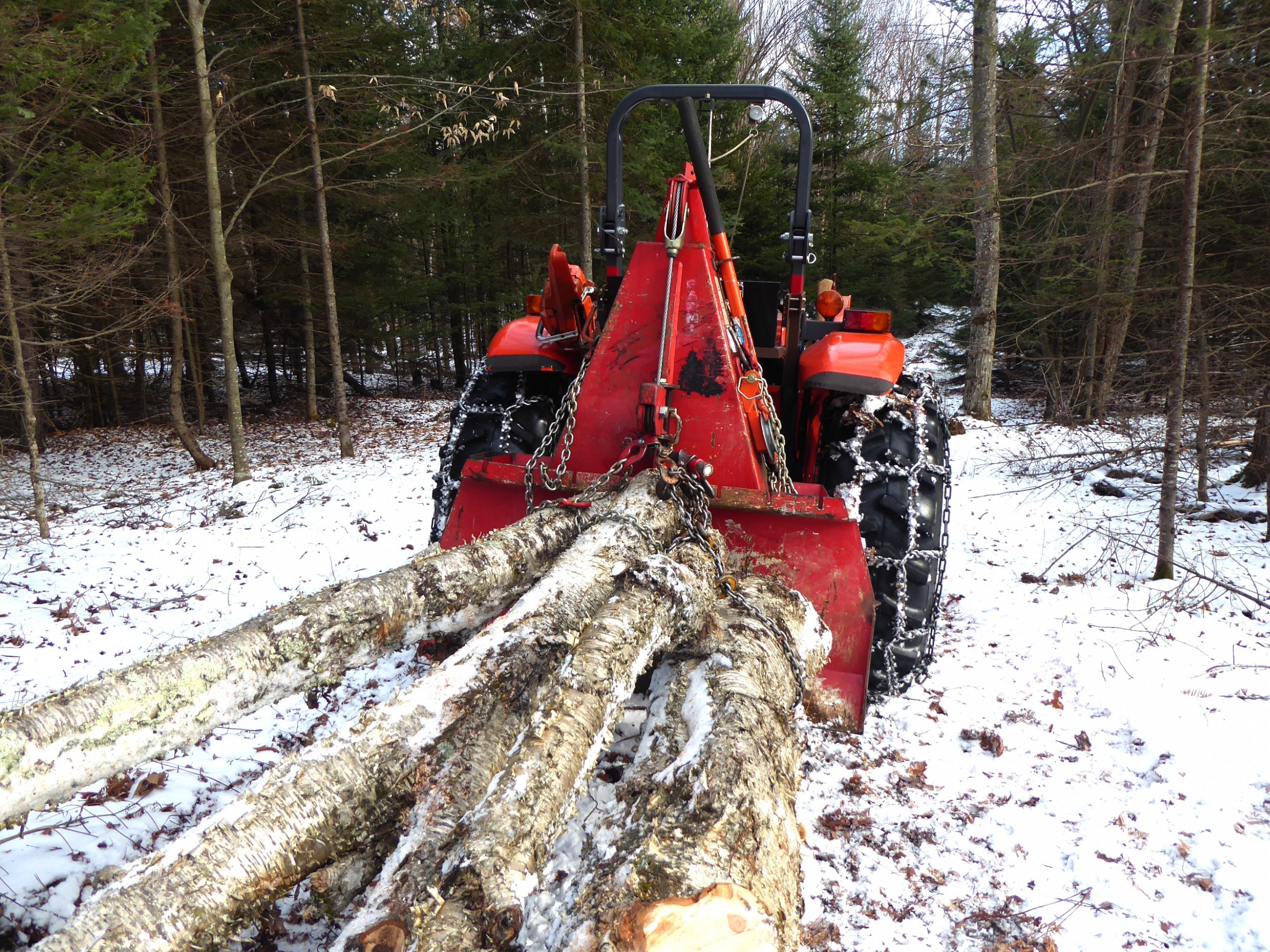

I pulled that all together to make a hitch.
Next trip I'll get the snag, another big branch and a maple that got taken down when the ash fell.

Good post Gordon. I thought I was the only one to get logs hung up!
It looks like you are skidding pulling on your lower pulley . I try to do that on hard pulls when I can. However I am not always able to raise the butts off the ground from the bottom one. And as I raise the winch it rotates forward slightly at the top and kicks out slightly at the bottom. Doesn't raise straight up. I have attached my top and lower links to minimize this issue as you suggested to me a few years ago. And hooking the choker chains directly to the winch hooks is no better. Sometimes it works and sometimes I pull from the top. I have a Wallenstein winch.

Some times I use the top pulley to skid with a light hitch and a straight trail but if I have any sharp turns I make sure that I use the bottom pulley. I almost pulled myself over sideways going around a sharp turn pulling from the top pulley. I have my lower pulley in the third notch up so it might be higher than yours. Maybe you can move it up with a little welding.
I also try to use the top sliders first so I can get the hitch high as possible. I almost never use the hook way down at the bottom end of the cable. I get about a foot more lift on the top slider vs the hook. It also leaves the lower sliders free so I can stop, drop the hitch, pull out the cable and winch in another log to add to the hitch.
This may not be your problem but one thing I see over and over is that people want to buy the biggest winch they can. There are many problems with that and one of them is that a bigger winch has higher lift arm connection points so that you can't raise the winch as high as you could one with a smaller geometry.

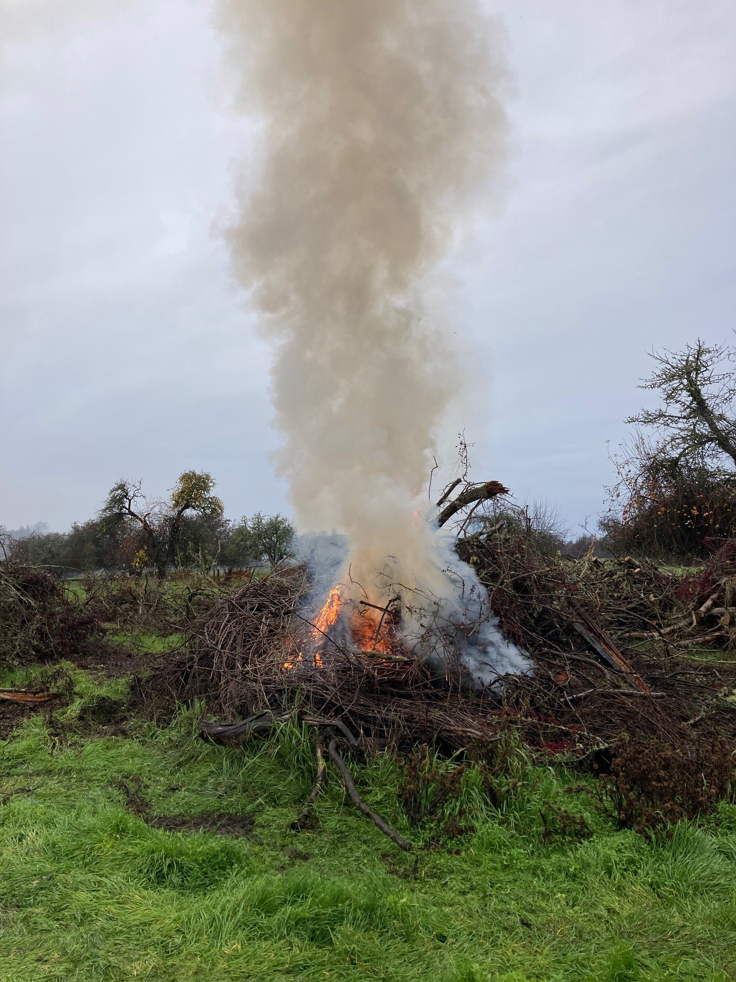

Burning debris piles. Rain, smoke straight up. Perfect day for it.
