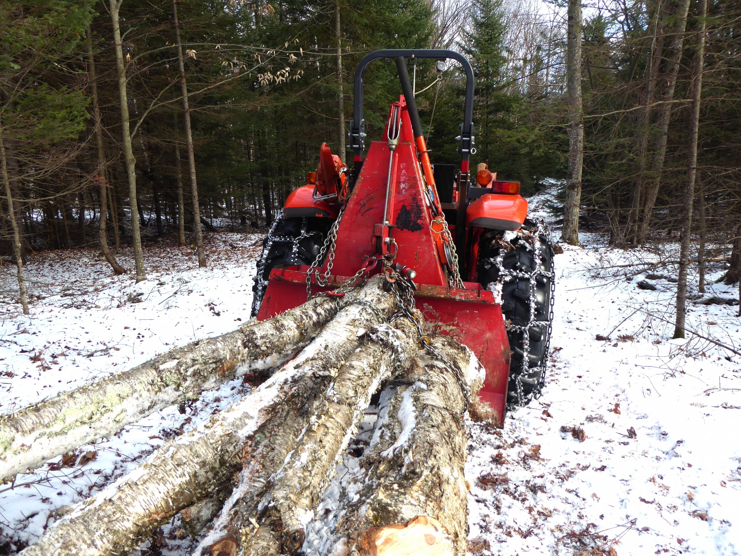

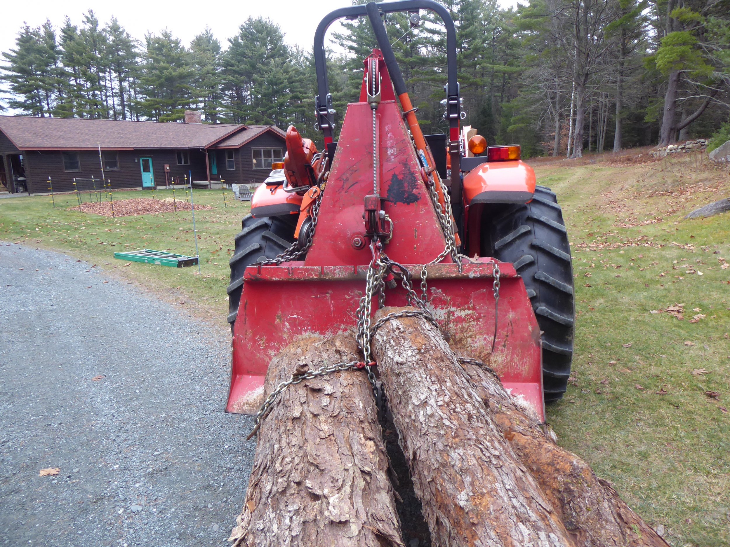

Just I quick question why do you guys use choker chains instead of cable chokers?

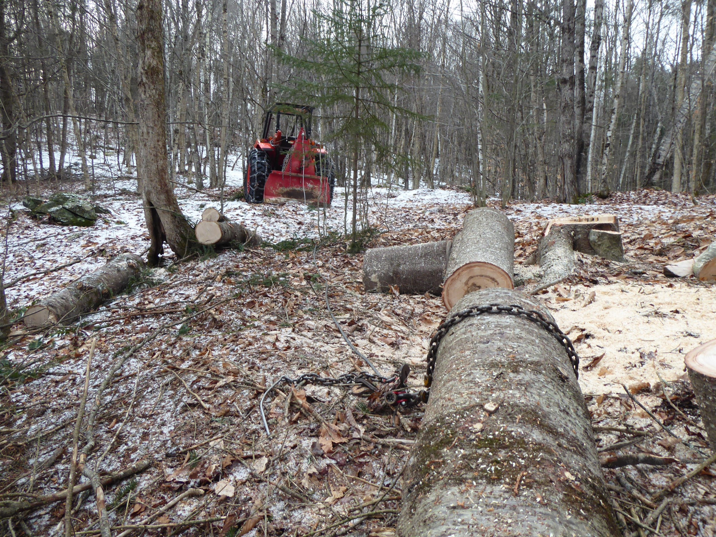

What the other guys said and most important to me is it allows you to control how the hitch bunches together. You don't have a lot of leeway with a winch. You need to get the hitch snugged up to the tractor in order to lift it. I don't think you could do that with cable chokers on a tractor winch ????

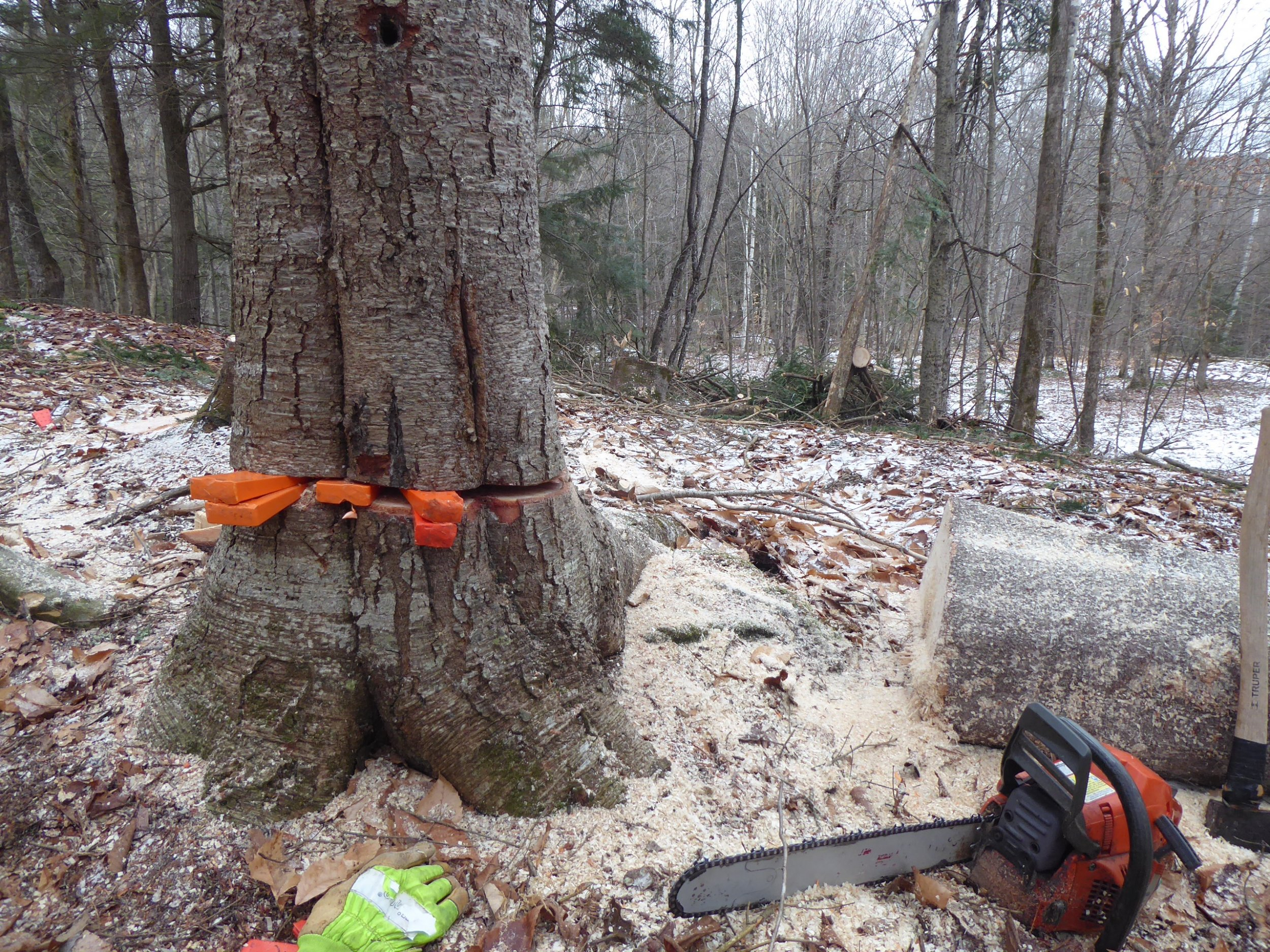

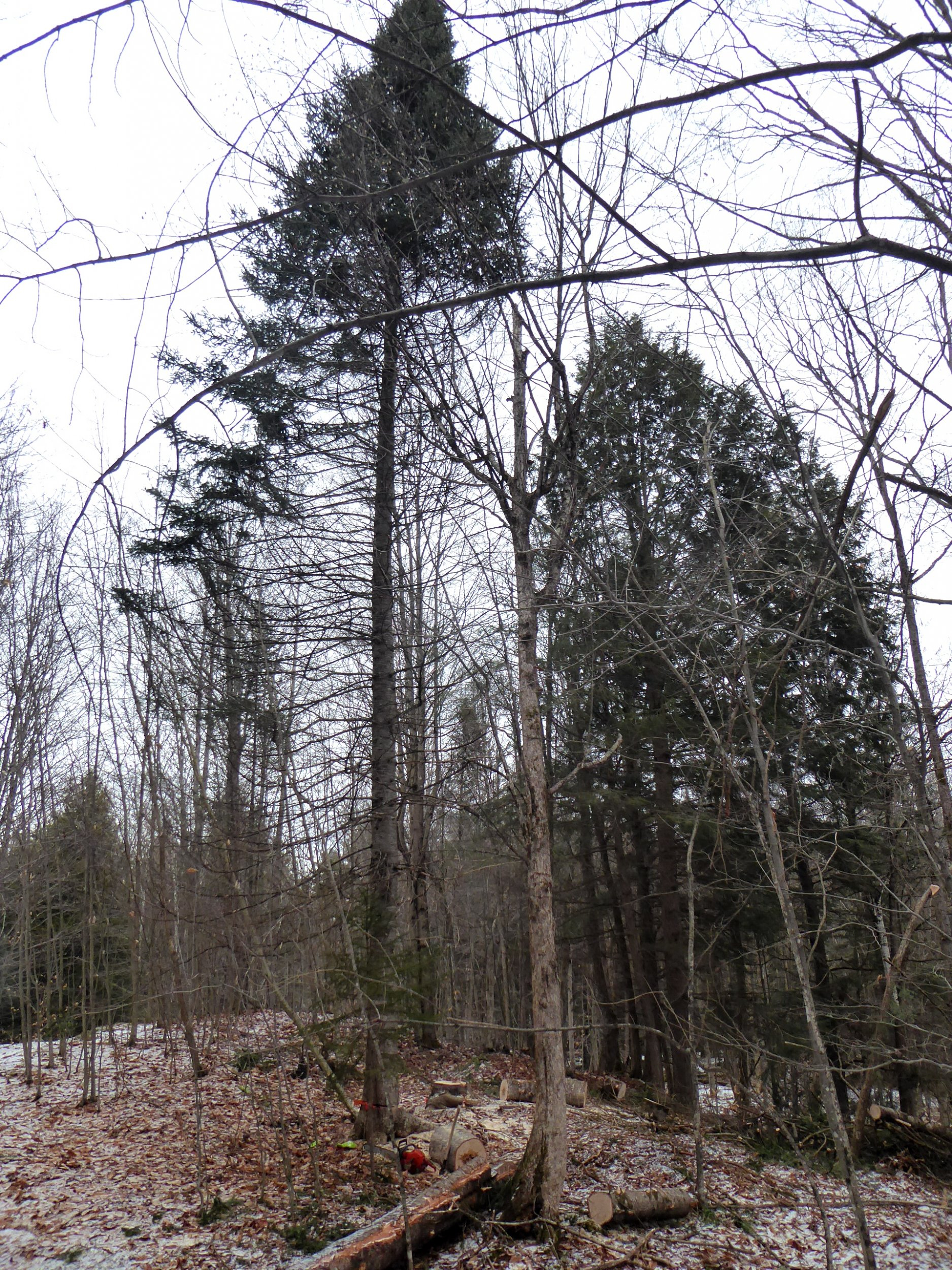

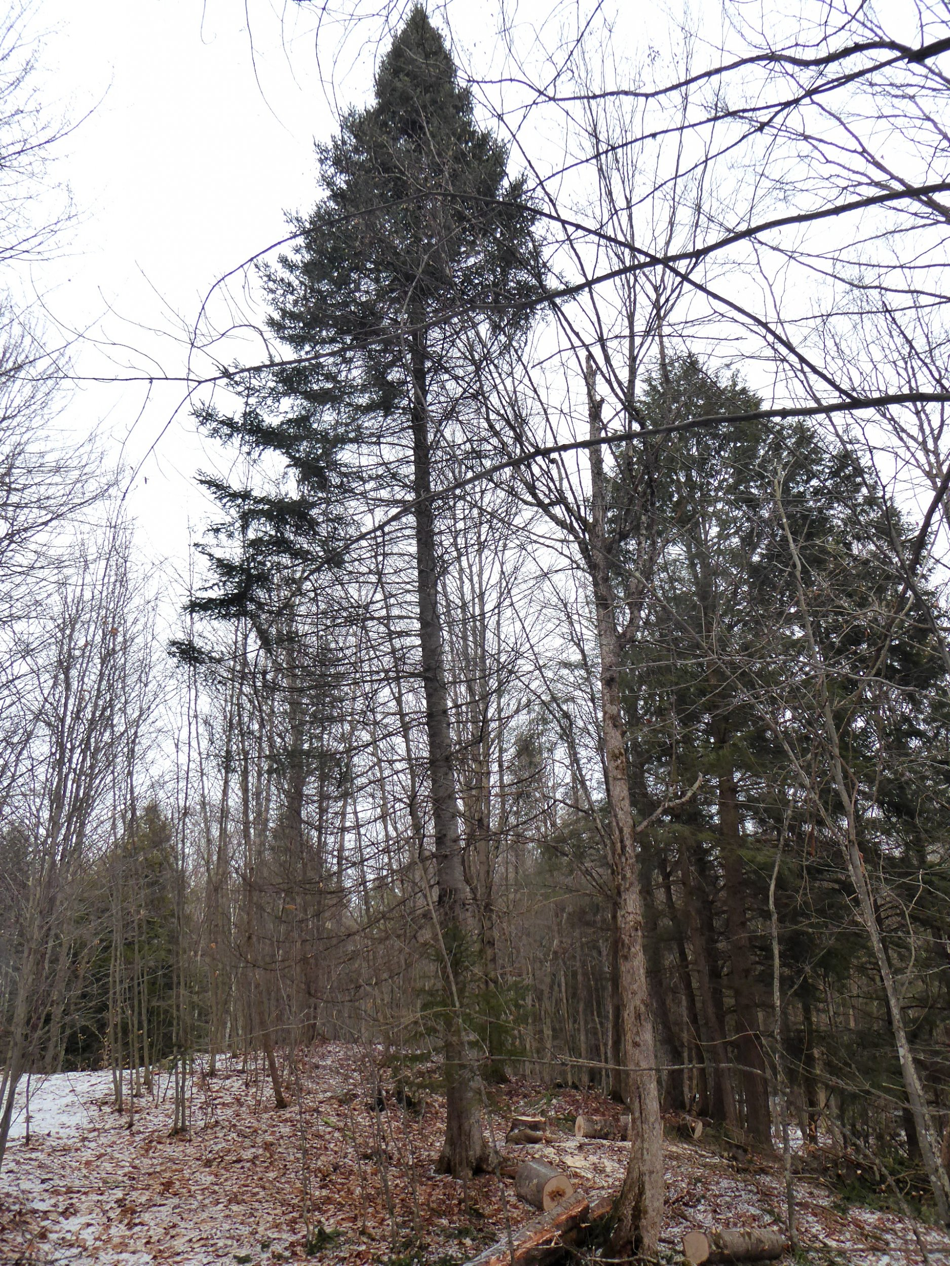

I lost my nice snow covered trails in yesterdays rain so I switched back to cutting fir instead of firewood. I had a tree that was leaning left but I wanted it a fall right into a little gap that would give me an easy winch path.
In the winter when the trees are frozen wedges are very prone to spitting back out at you. The wood is hard and slippery and the barbs on the wedges don't hold well. It helps a whole lot if you use more than one wedge to spread the lifting force around rather than having it all on one. Plus it gives some insurance in case one spits out or breaks. On this tree I new I would need to stack the wedges two high in order to tip it over. I decided to use 3 sets of wedges. I set in the three wedges as I walked my back cut around the tree starting on the left side. When the hinge was all set I drove in the three wedges until I was confident all was going OK. Then I drove the middle one all the way in which loosened the two outside wedges and allowed room to double them up. Then I drove the outside ones in until the center one was loose. Like so. You can see the little slot down there where the other fir top is.
At this point the tree was almost ready to go over.

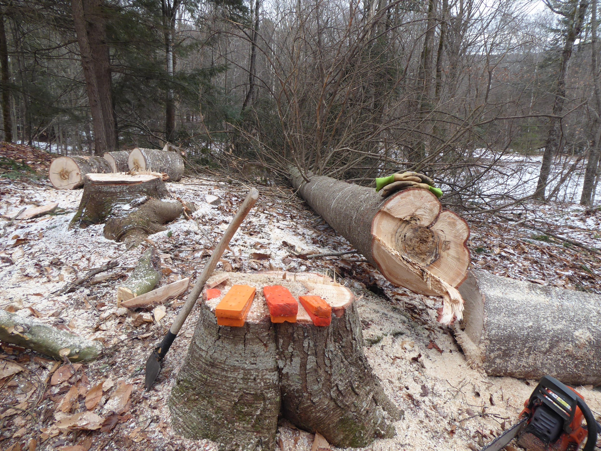

Then I doubled up the middle wedge and drove the thee sets of wedges evenly until it went over into the slot.

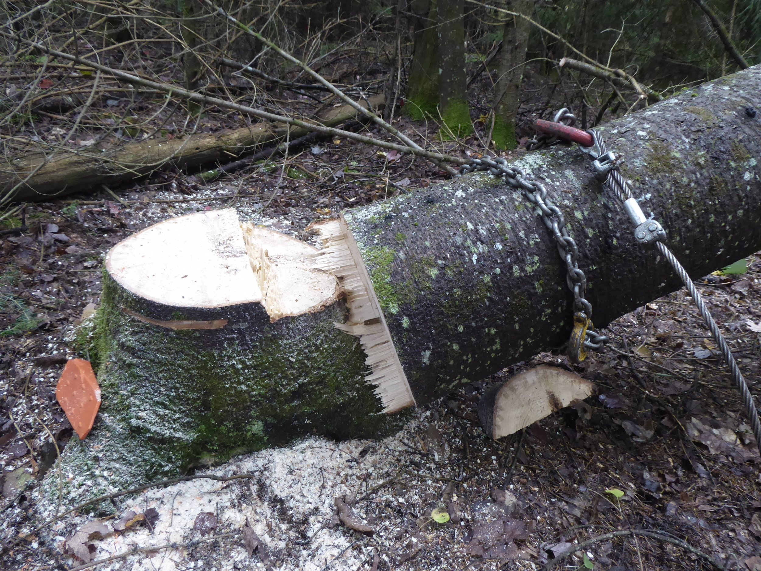

Then I limbed it out, cut off the butt rot, and was ready to winch it to the tractor.
gg
You could with bells on there, I couldn’t imagine personally ever packing chains and being able to swing one around a log well being in the air. As far as control that would depend on the type of mainline being used, for timing there’s a skidder style where you could run multiple bells on the mainline and then there’s the cat hook that doubles as it’s own choker. I also couldn’t imagine trying to set a chain in the brush it looks like a pain where a cable you can push the job through the brush under the log making for quick turns, if you want to roll a log you set the knob and bell to that side for the roll.
I will have to check those out - see how they work.

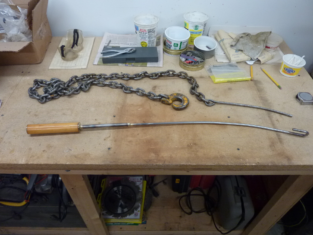

Our trees are like tooth picks compared to what you have to work with and tractors are small compared to skidders, etc. A whole different set of methods and tools can be successfully used. Your right you can't push a chain under at tree easily. But the chokers have a pin on the end to push under and if that won't work you use a choker hook. I have one but don't have to resort to using it very often at all.
There is no problem rolling a log with a chain choker I do it all the time. Put the hook where ever you want when the choker tightens it bites in or put an extra wrap the other way to get a bigger roll.
I have two size chokers, a bunch of 6'-6" and a couple 8 footers which don't get much use. How long are your chokers ?
