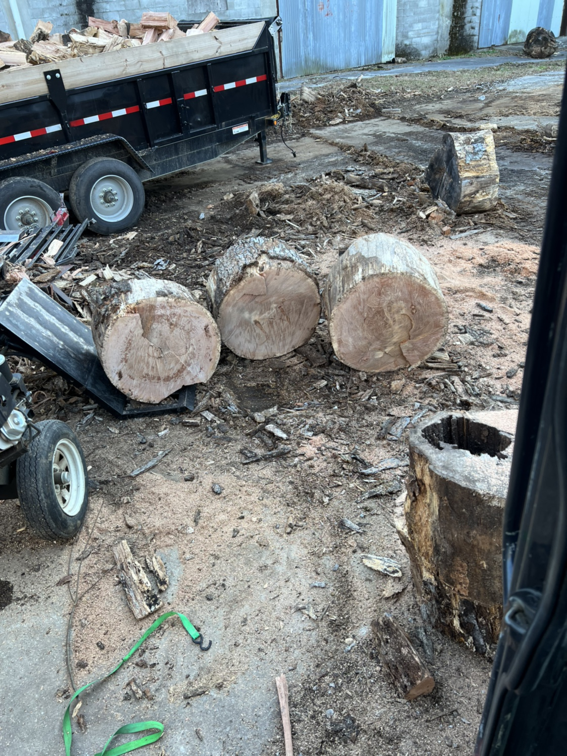

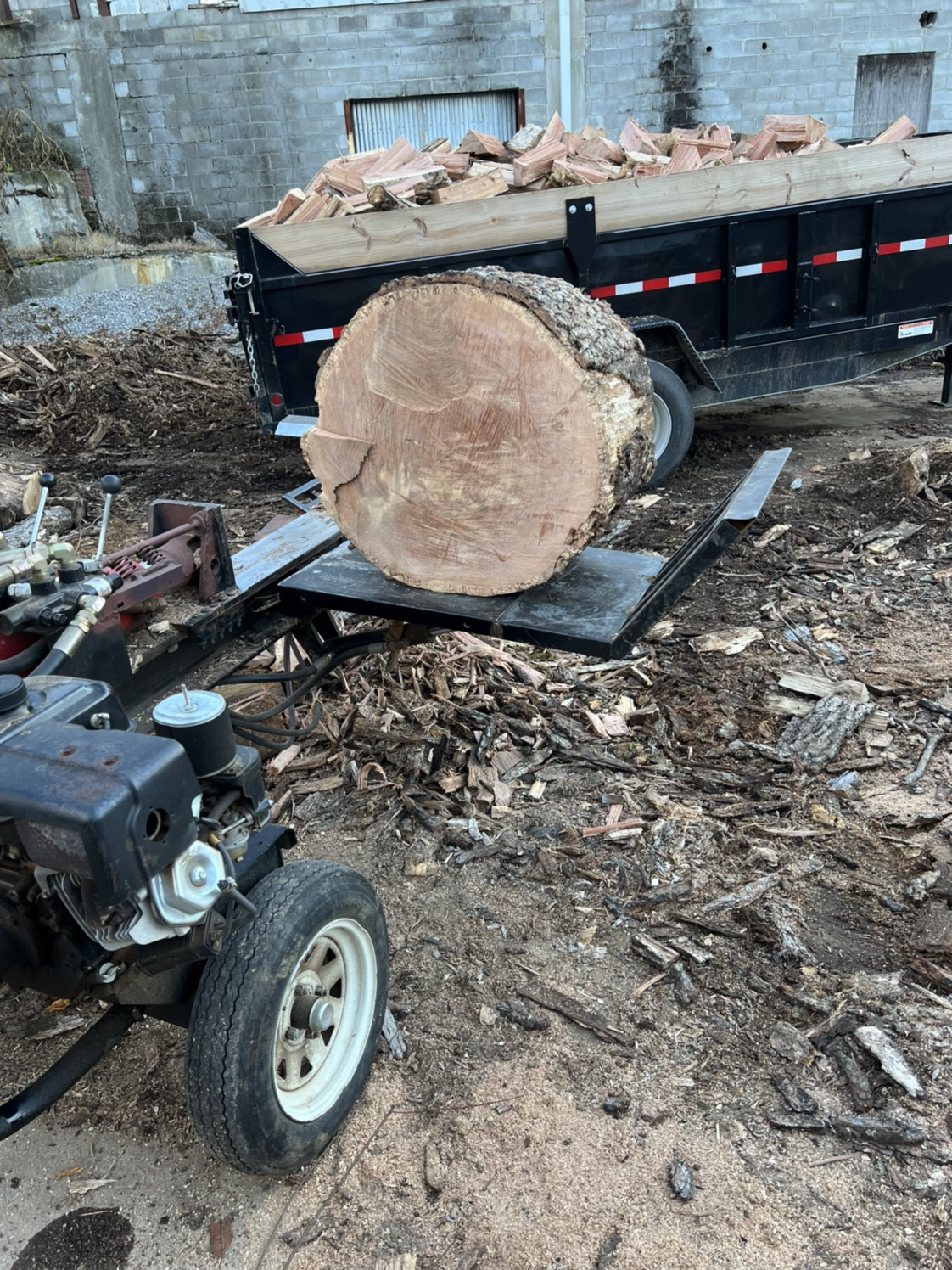

I split another load of firewood today. Thanks to the lift I was able to split rounds this size by myself. If I had help I’d probably load them straight on the table with the mini x but when I’m by myself I just line them up in front of the lift so I don’t have to wrestle them very much.

Whats to keep them from rolling off the other side when you lift them?

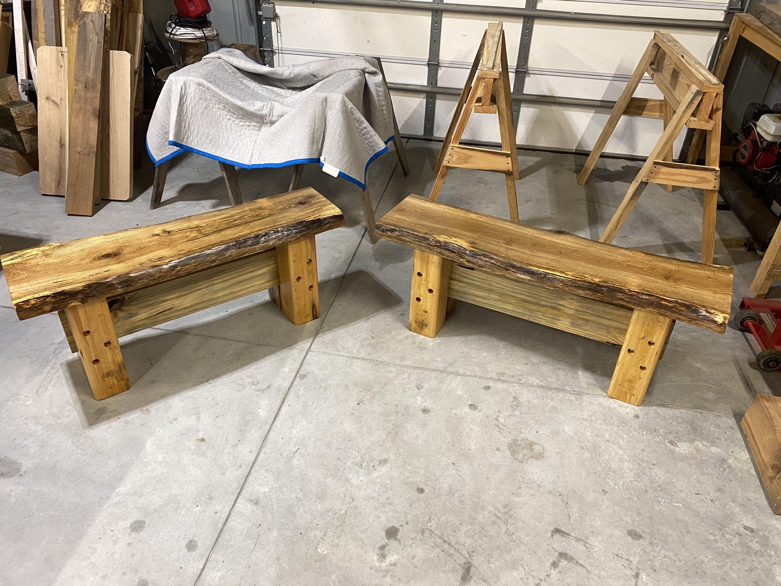

Made a couple more benches with stuff from out in my saw yard. Hosewarming gifts for my daughter and her new husband.

I like those benches - very nice !

Thanks, had a couple oak slabs lying around and some pine 6x6s, made one for myself a while back , they just bought a new house thought I'd make them a couple. Works out good as we are driving down to Texas at the end of the month I can take them down. I'd hate to try to ship them they weigh a ton!
It’s still a little bit up hill and you’re standing right there to hold it. Sometimes when you split in it in half the half will fall off. Usually with 2 people you can stop it for falling off but with one person it happens sometimes. Lilting even half of a piece that size is difficult so usually I use my mini excavator to put it back on the other side of the splitter with the lift. If I was working with a helper I’d set the piece directly on the splitter, let the helper push it through, then I’d grab the piece with the excavator and drop it on the ground to finish breaking it in half then set one half back on the splitter and set the other half on the ground in front of the lift. Or if I was running smaller wood I’ll feed the helper a few pieces and then get off and load the splits while he keeps splitting.

With big rounds on an open splitter beam like that, I often do the first split at more like 1/3 and 2/3 - let the 1/3 part fall to the ground and then you don't have to lift as much to get to back up on the splitter to finish it.
I am trying to imagine your workflow the way you describe it, and it sounds like you are on an off the mini-ex for darn near every round sometimes. Doesn't that just make splitting take forever to get done? Meanwhile the mini-ex is accumulating run hours from idling the whole time? A great tool for lifting things, no doubt. But seems crazy to me to run up the hours on it, and climb on and off of it for every piece of wood.
No I stage several pieces in front of the lift when I’m on the mini. I only stacked 3 of the big ones but I might move 20 12” pieces at a time. When I’m splitting smaller rounds I don’t center them. I usually size it so every piece off the left side of the wedge is done but when I’m doing big ones I want them to loose as much weight in a cycle as I can.

Sounds like you need an exit table on that splitter.
