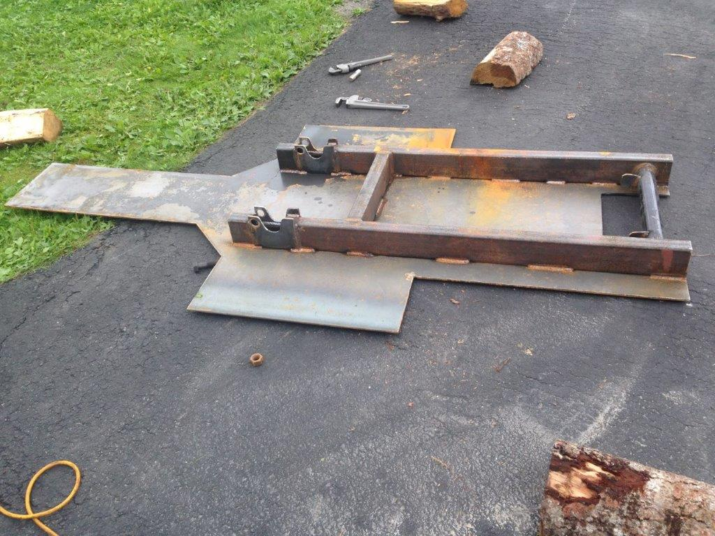

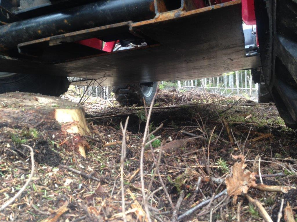

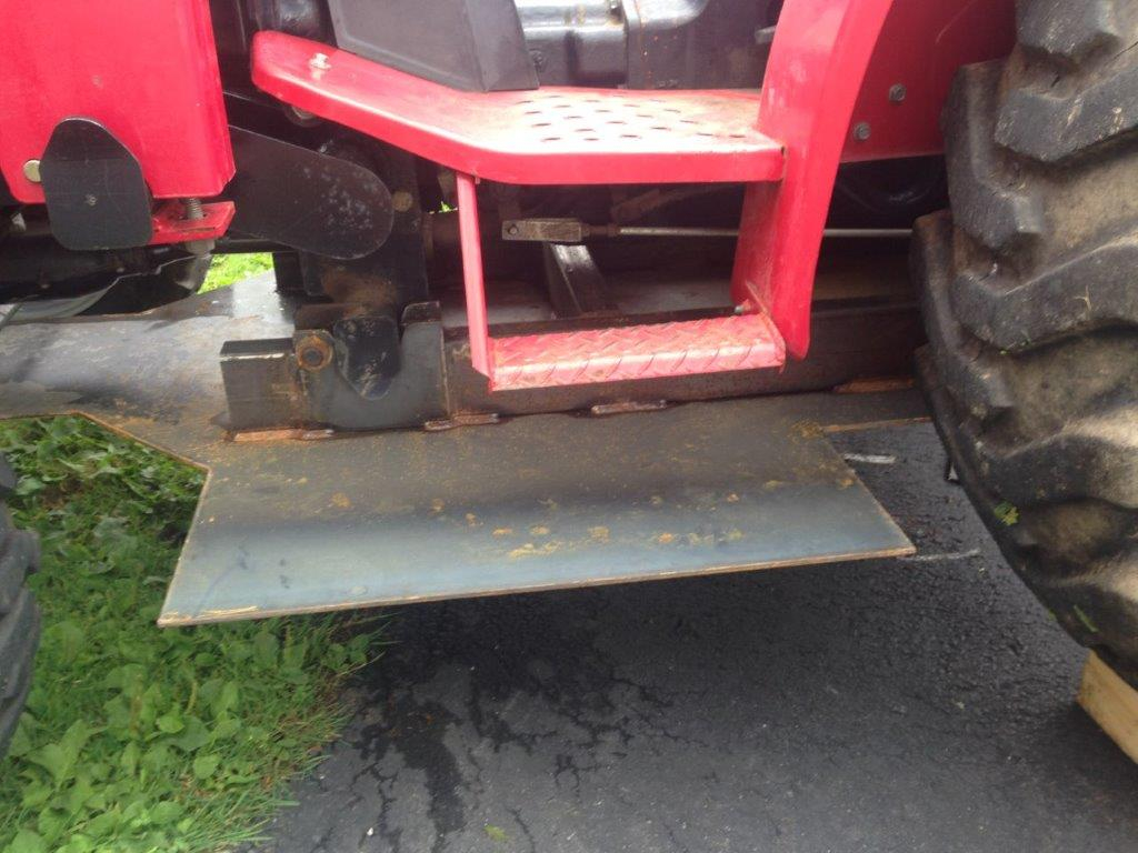

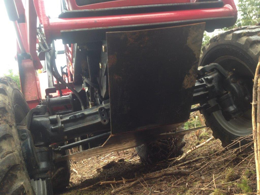

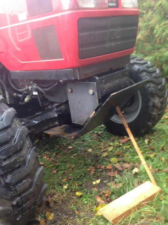

Yes I noticed that. Like hens teeth to find used ones. The sub frame is attached to the backhoe on mine. But I built an identical subframe which rests in a c-channel type receiver in the rear and pins under your feet. I then welded a 1/4” plate on that, which flares out between the front and rear tires. It hinges just forward of the front axle and gets bolted on some vertical plates that’s bolted to the front bumper on each side. So it adds 200-300 lbs im sure. I could calculate the weight next time I’m near. I have a front loader on as well. I thought of filling the tires in the past. I still could I suppose. I do like the idea of the unsparing weight. I been thinking of a set of ice chains too when I’m snowblowing they would be good. I’m guessing I’m a little over 3000#. Maybe 3300#.
Sometime if you have a chance post a picture of that subframe plate you built. I don't know what your trails are like but if they are rough with rocks, holes and sections of side hill any weight you add that is low like your subframe plate, loaded tires, or chains will give you more stability moving around the woods by lowering the center of gravity of your tractor, as well as increasing traction and winching capability. Loaded tires help a whole lot with safety and stability in the woods.

It does lower the clearance a lot. But if it is much rougher terrain, I just won’t go there. I’ll use the j5 now. I did think about scoring those “ wings” between tires, and bending up slightly for more clearance height between front and rear tires. But then it might be awkward backing over the plate. I back over it. Insert the round pipe on the plate into a receiver on the tractors rear. Then lift the front of the plate up to install two 1” pins on each side. The plate hangs there then. I then lift flap up in front and bolt in place to two vertical plates I have bolted in place permenently on the left/right side of the tractor up front. You can see this in the last picture. At the time the tractor was all I had, and wasn’t keen on using it. All I had were forks on the rear. And I had fear of hooking a hydraulic line underneath her, and losing oil and possibly damaging the pump. Not sure how that would go down if it happened. So I built skid plate. I did also think about making vertical walls to bolt on the plate once on. But never did. They would protect that main hydraulic block on it. The front wheels turn so sharp that the skid plate is a mere 13” wide up front. Leaving front wheel wells exposed. I would probably pave the trail I’d use before going in anywhere rough. I also don’t like the tractor tipping enough to one side or another that the front walking beam runs out of travel. Not sure how much torsional stress that places on cast mounts on the tractor body.

I probably could have built it lighter. But at the time I had no where to put the tractor etc. so the plate was to be left on the ground. Running over it on unlevel ground I figured I’d bend it. So it’s 1/4” plate. Since then I built a garage with a nice cement floor. So no stress on it while backing over it. It goes on in a minute or so, off in seconds. In the pictures I did not have the one inch pins I use with the backhoe, they were 20 miles away. So I just had a large bolt dragging around I used to hold it in place.
   / Tractors and wood! Show your pics #20,510
Good pictures Vroom. Thanks for posting them. I like the way you did that - plenty of protection there.
