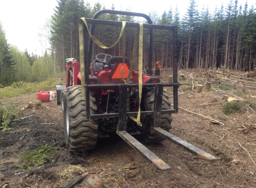

I posted pictures here before when I cut some wood and used them. If I can find a picture I’ll post it again. Mine are pretty heavy. They are 2x4” tubing. But I made a large square frame with expanded metal to protect the tractor. It’s a small tractor so I might be cutting in in its lift capacity a little. But they worked well

When I get home. I may slice 1/2” lengths of tubing with 1” id and weld them on both sides of the tangs in which the rod slides through in this picture, for more bearing surface. I’ll then drill them once welded in place, to allow a cotter pin to go through the tube, passing through rod and out the other side so the rod can’t spin. Then only the forks can rotate around the rod. I’ll install a grease nipple on top of the forks. That picture was several years ago. It’s rusted up some and I need to get that rod out to fix it up. Little stuff bothers me like that while I’m away from home. I should be able to slide forks to desired widths.
