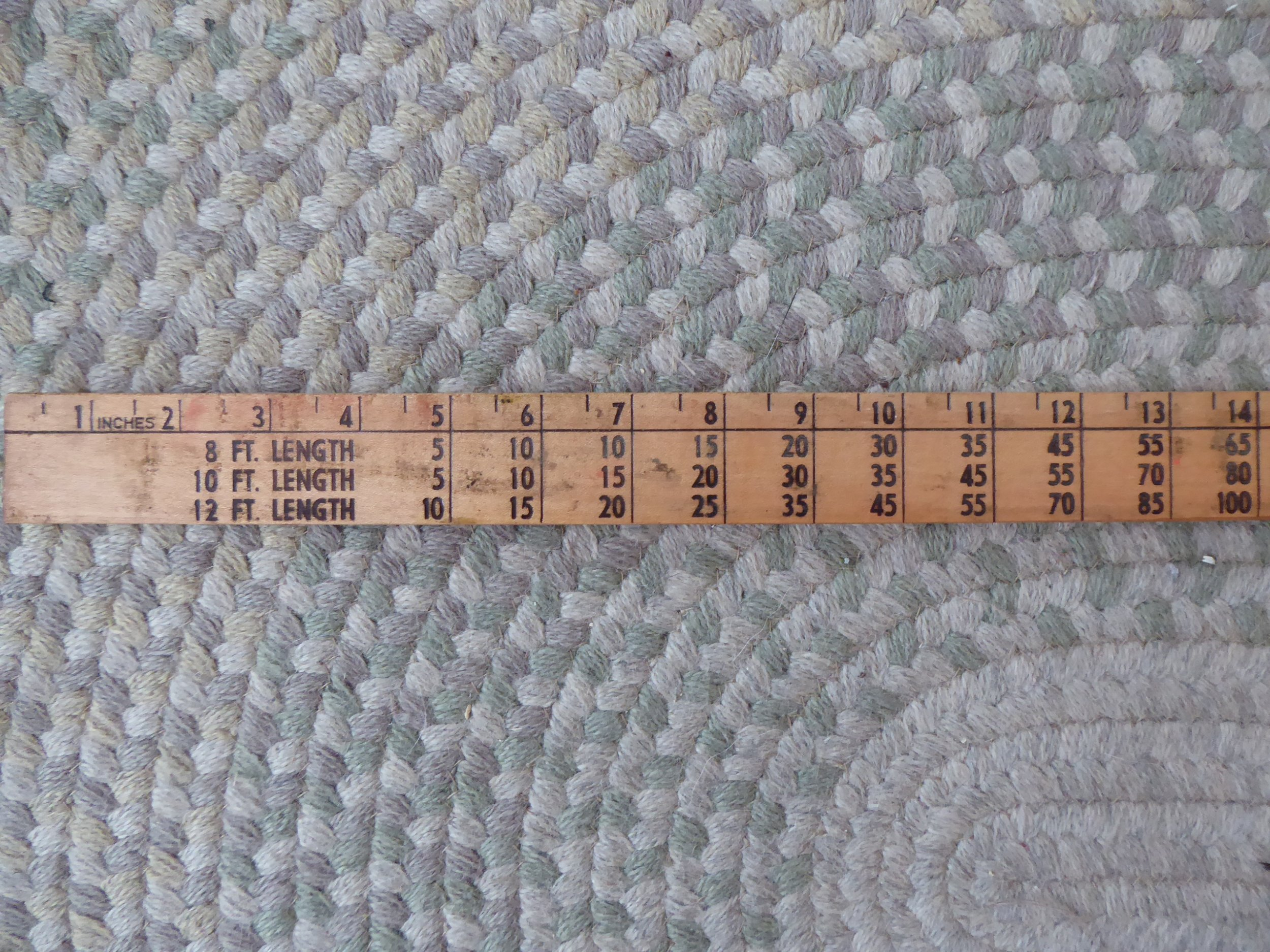

Here's my scaling stick for the International Scale which is used here in the Northeast. On the back is 14', 16', 18', and 20' logs. It covers logs up to 36" diameter. International Scale fills in the blank part of Skeans1"s Scribner chart. Scribner gives better results for large diameter logs and International is better for smaller logs like we have in the NE. Another common scale is the Doyle Scale.
Reading my stick you can see a 12' log 10" in diameter on the small end is expected to produce 45 Board Feet (BF) of lumber when sawn out barring any unseen internal defects.
Now-a-days they used computerized calipers not sticks.
