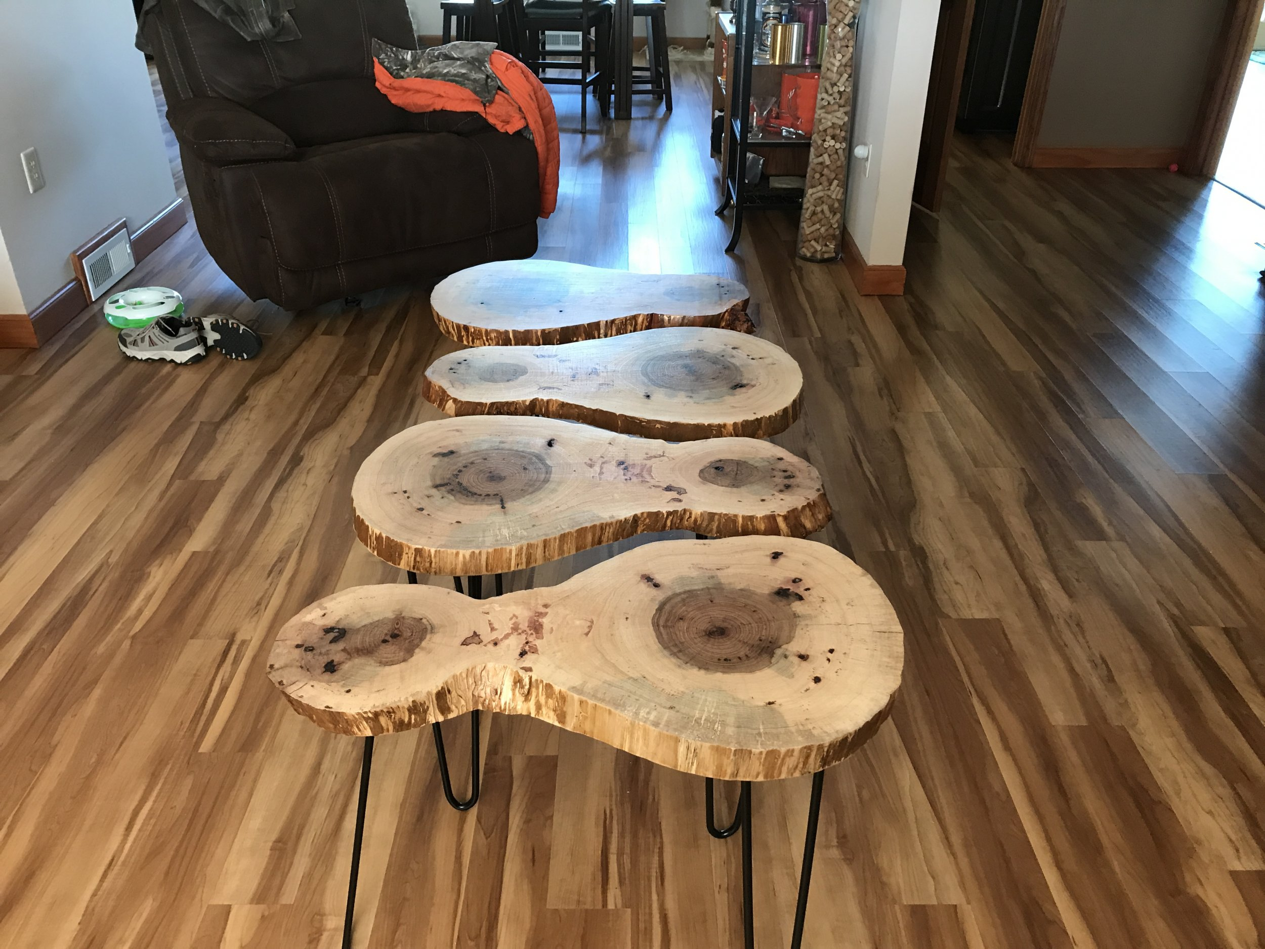

Wow those are very nice looking and very unique. Q- how did you make or obtain the legs?
SR, yes I am resigned to some cracking. I talked with my logger recently about some madrone slabs I made that started out beautiful but cracked no matter what I did.
He suggested wrapping them in plastic, then waiting until a small amount of mold develops. Then open them up, let the air exchange, and do it again. Keep doing until dry. That's the first time I have heard about that method ....
Legs from amazon, they have different sizes.

I just stuck the discs in the skids of some other wood I was drying in the shade and undercover and it worked out very well. I've never used the Anchorseal so I cant comment on that. I think the thing is you want them to dry very slow! I made some tables..

How about the floor - did that come off your mill too ??

No, unfortunately that's vinyl plank flooring. I got it because it claims to be waterproof and with my critters , 2 ponds and a pool right out the back door seemed like a good idea at the time... not really though. Wont happen again I promise. Scratches easy and doesn't hold up real well.
