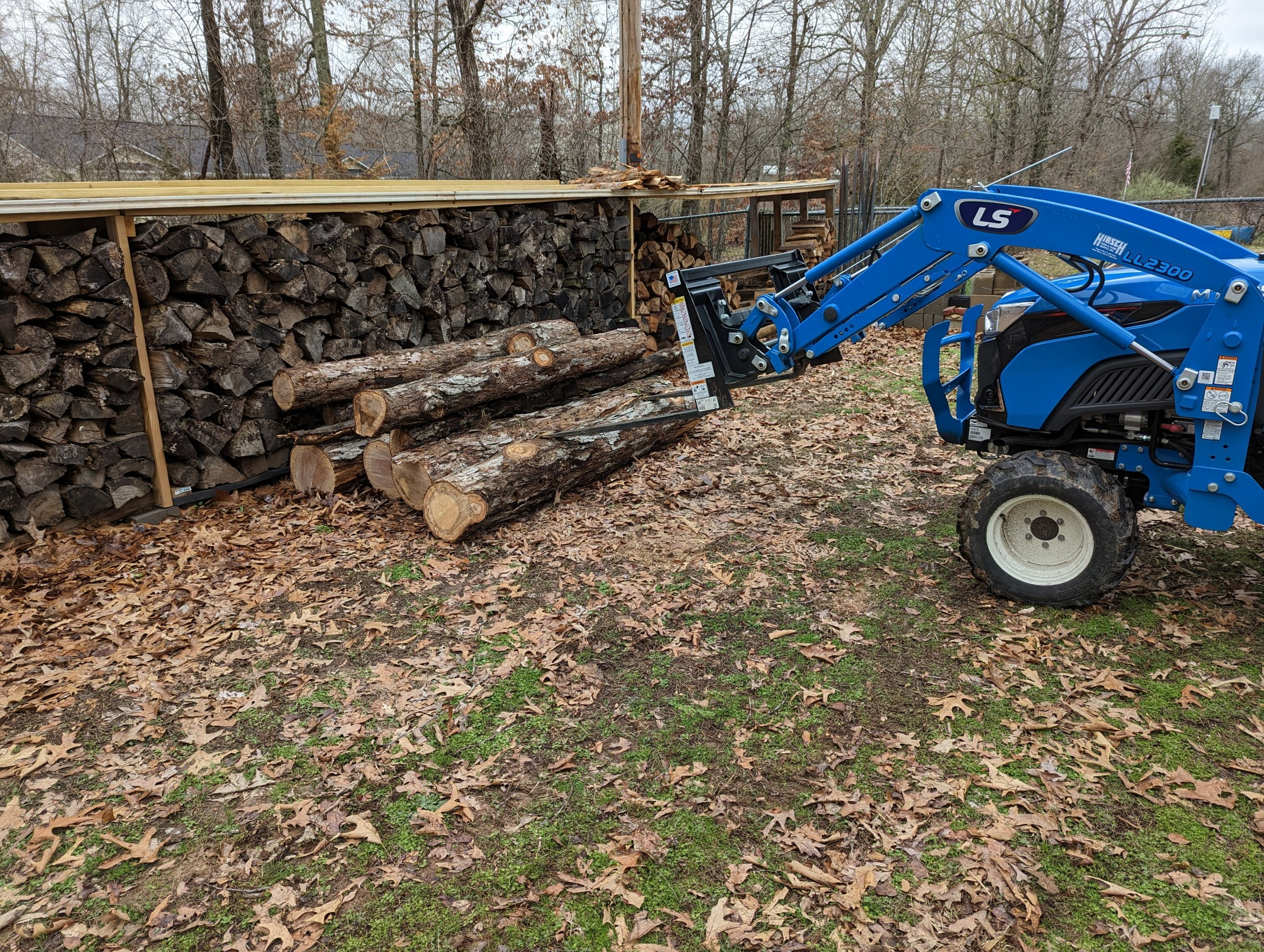

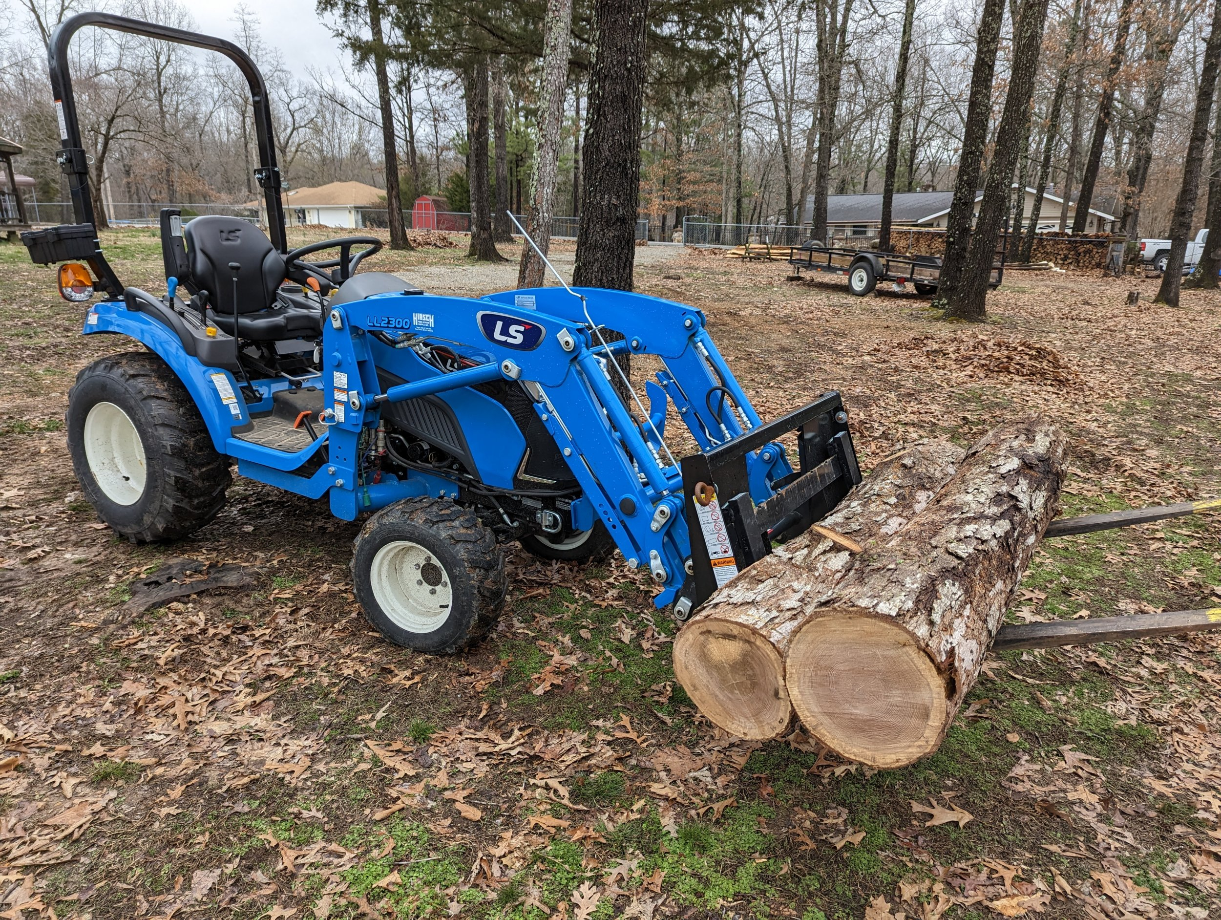

Another week, another tree 🌲 harvested.
At this rate I should finish clearing the land in another 5 years or so .

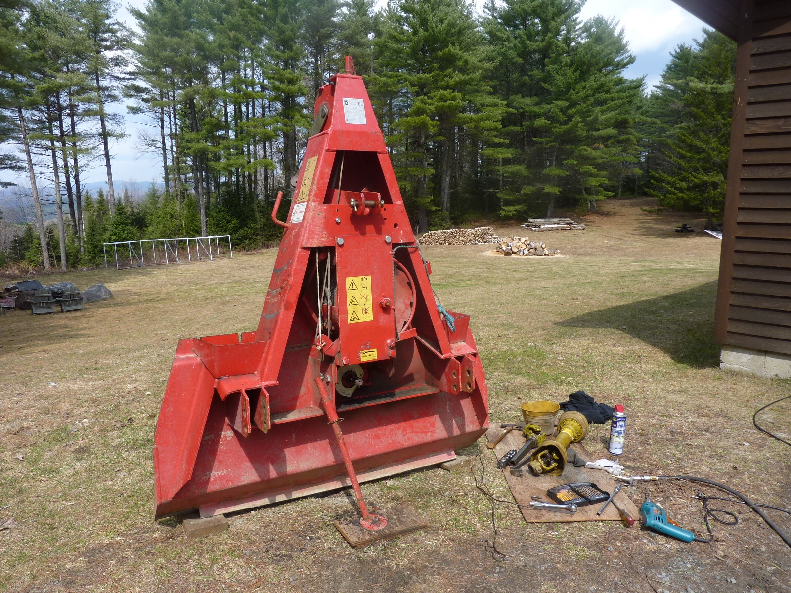

Good question 2manyrocks. OK the basic winch operation goes like this. There is a clutch controlled by a rope. Normally disengaged and engaged by pulling the rope. Releasing the rope disengages the clutch. There is a pawl brake controlled by a second rope. If you pull the brake rope while there is tension in the cable the brake will hold when you release the clutch rope. You can then release the brake rope and the brake will still hold. When you pull the clutch rope again to winch in more cable the pawl brake will release.
The white rope on the left is connected to the clutch lever. The blue rope on the right is connected to the pawl brake lever.
So what I do in the back leaner situation is- after I have the snatch block and cable all set up I pull the clutch rope and start pulling in cable. The cable rises off the ground and starts putting tension on the tree. When I see the top of the tree just start to move I pull on the brake rope and then release the clutch rope. This applies the brake and the winching ceases. I go out to the tree and make my notch cut and back cut leaving a strong hinge and watching that the tree doesn't set back on the bar from lack of enough tension or start to fall forward on it's own due to too much tension. When the cuts are done I go back to the tractor and pull on the clutch rope to pull the tree over. This releases the brake. I release the clutch rope when the tree is falling in the desired direction which leaves the cable slack so it won't interfere with the falling tree. Hope the helps
