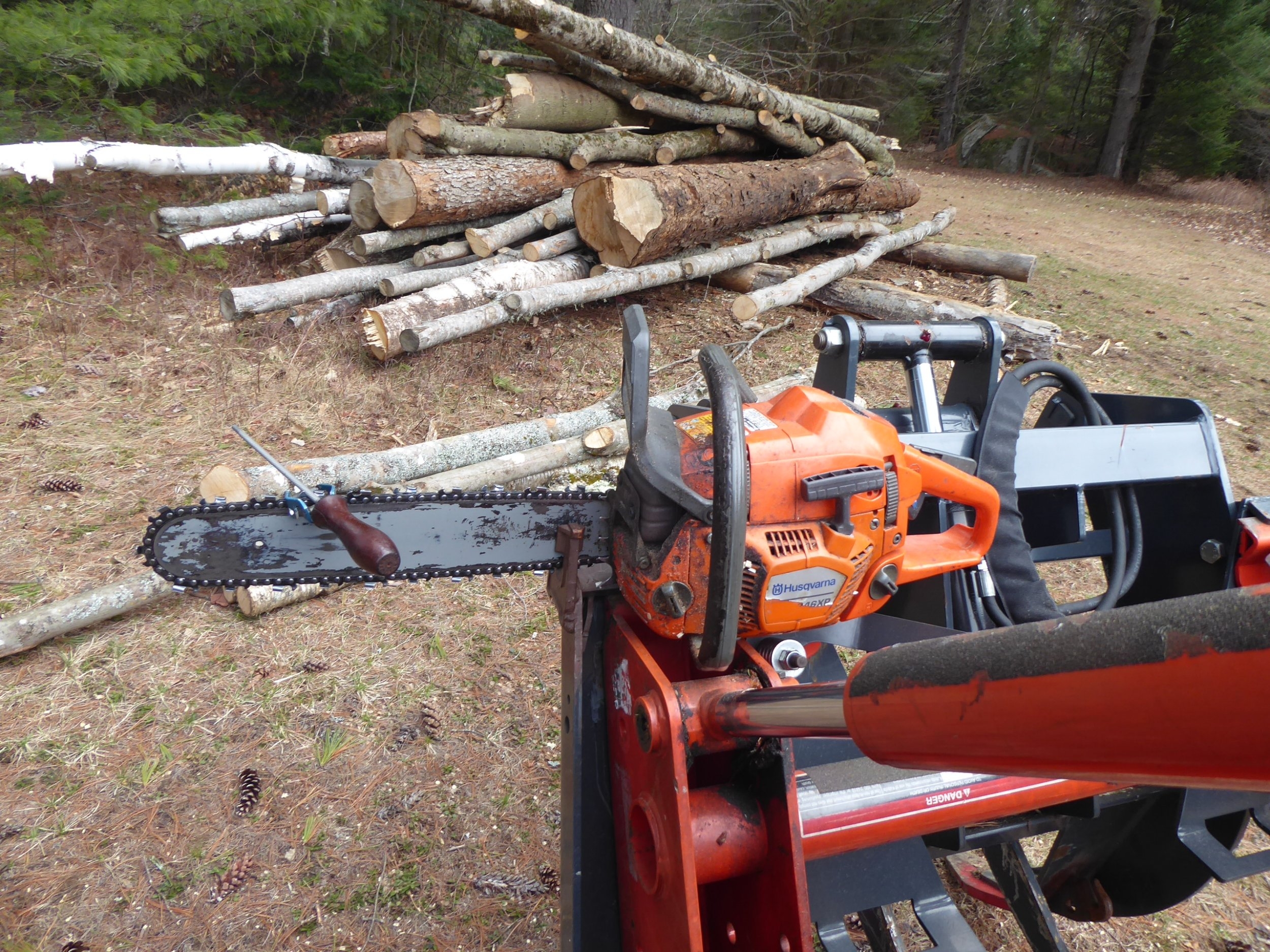

Usually I pull the splitter to the dead tree where I cut and split it. But a large, leaning, locust finally fell this summer when I didn't have much time to clean it up, so I sectioned it in 6' lengths and stacked them at my drive. Finally got around to setting them on horses for cutting to 16" lengths to split.
