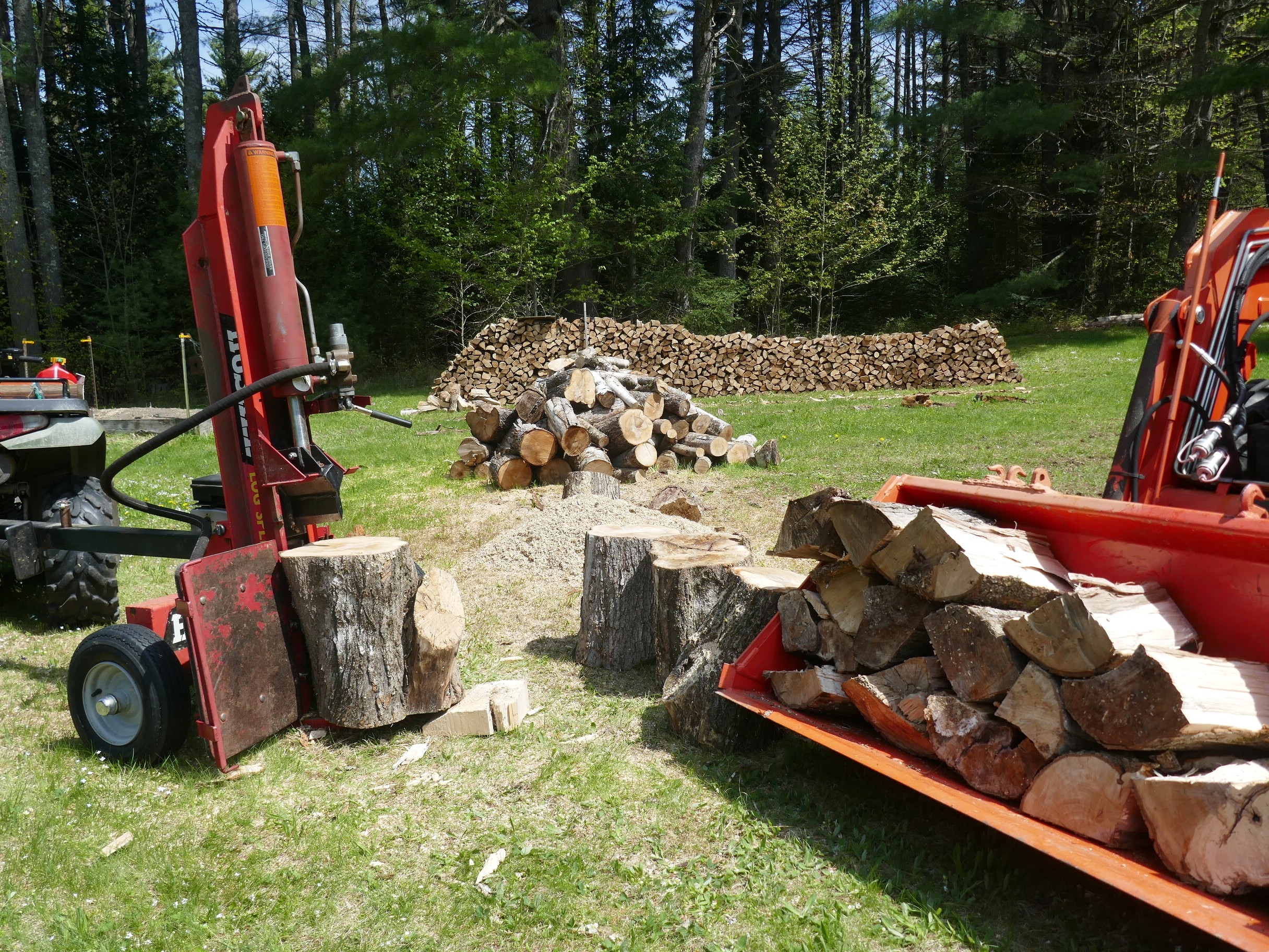

As I work my way down my elongated pile of blocks/rounds, as shown above from last week, I set aside any that are too big for me to want to wrestle with up on the horizontal beam. When I get a bucket full set aside, I pull the splitter around, put it in the vertical mode, and quarter them up for the next bucket full to split. Since these this year aren't really that big I don't bother with the carry-all deck and just use a wheel chock to hold the tail of the block up so it sits tight against the beam.

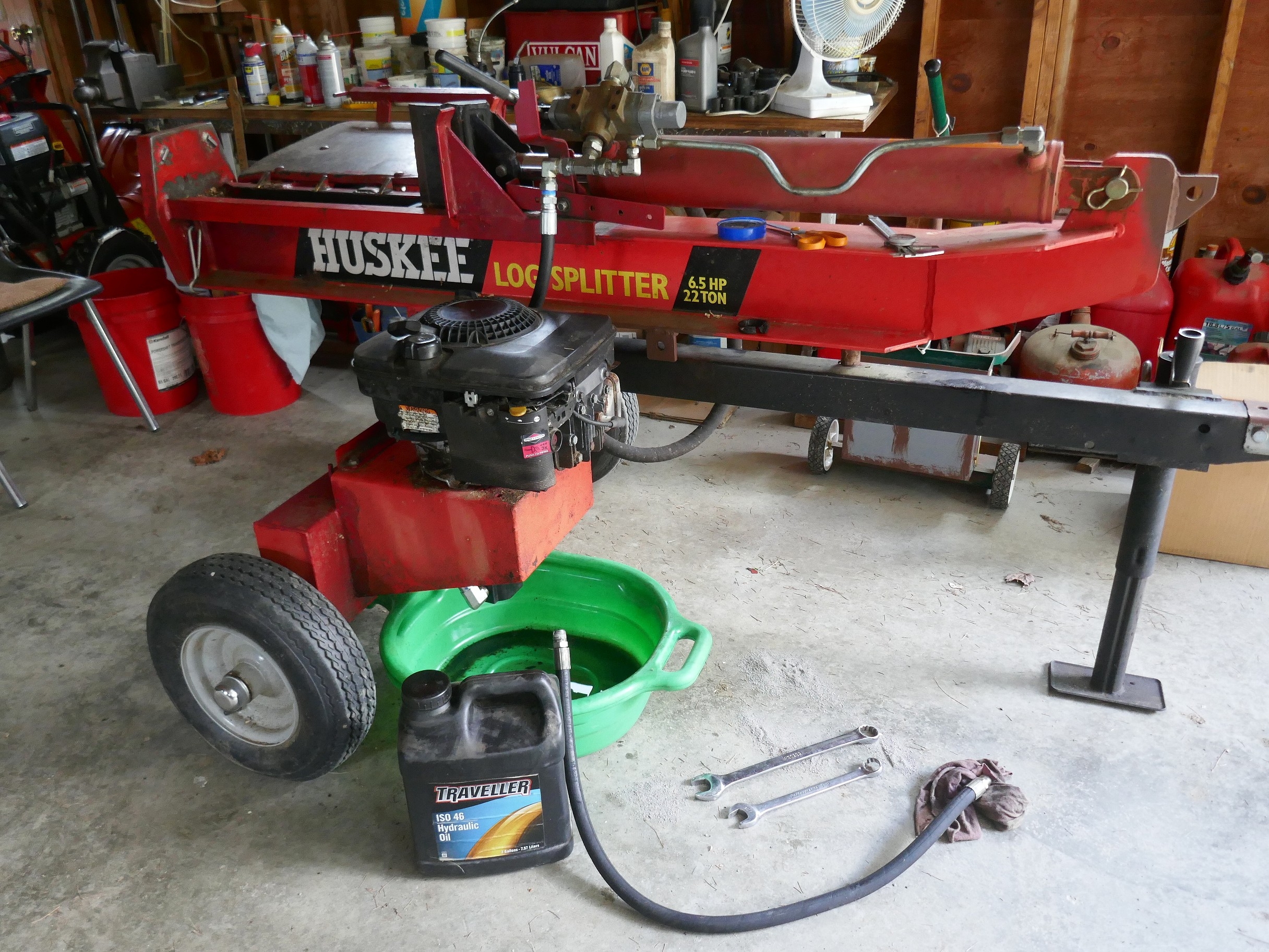

Yesterday when I went to move the splitter down the row a little for the next lick I noticed a wet spot on the ground under the pump. On further observation I found a steady little trickle running down the pressure hose and onto the hydraulic pump whenever there was pressure in the hose. I have no idea how old this splitter is and the hose was full of cracks. So I made a quick trip into town to the local auto parts. I only had to wait 10 minutes for them to make me up a new hose. And I was even able to find an 1-1/2" gromet to replace the old crumbling one that lined the hole in the motor mount base that the hose passes thru. Replaced the hose and topped off the oil - all set to go back to work now.

I have no idea how old this splitter is...
The configuration of that Briggs e675 engine is very similar to a pressure washer engine I had from ca.2006, so it may be similar vintage, although the pull starter shroud makes me think it could be even a few years older than that. The rest of that Huskee chassis design was kept mostly the same up thru at least 2015.
Keep a cover on it, sun is what kills these things more than rain. Here's the one I use on my Huskee 22-ton:
The covers last a good 5 - 7 years, and are a cheap way to protect the rubber bits.

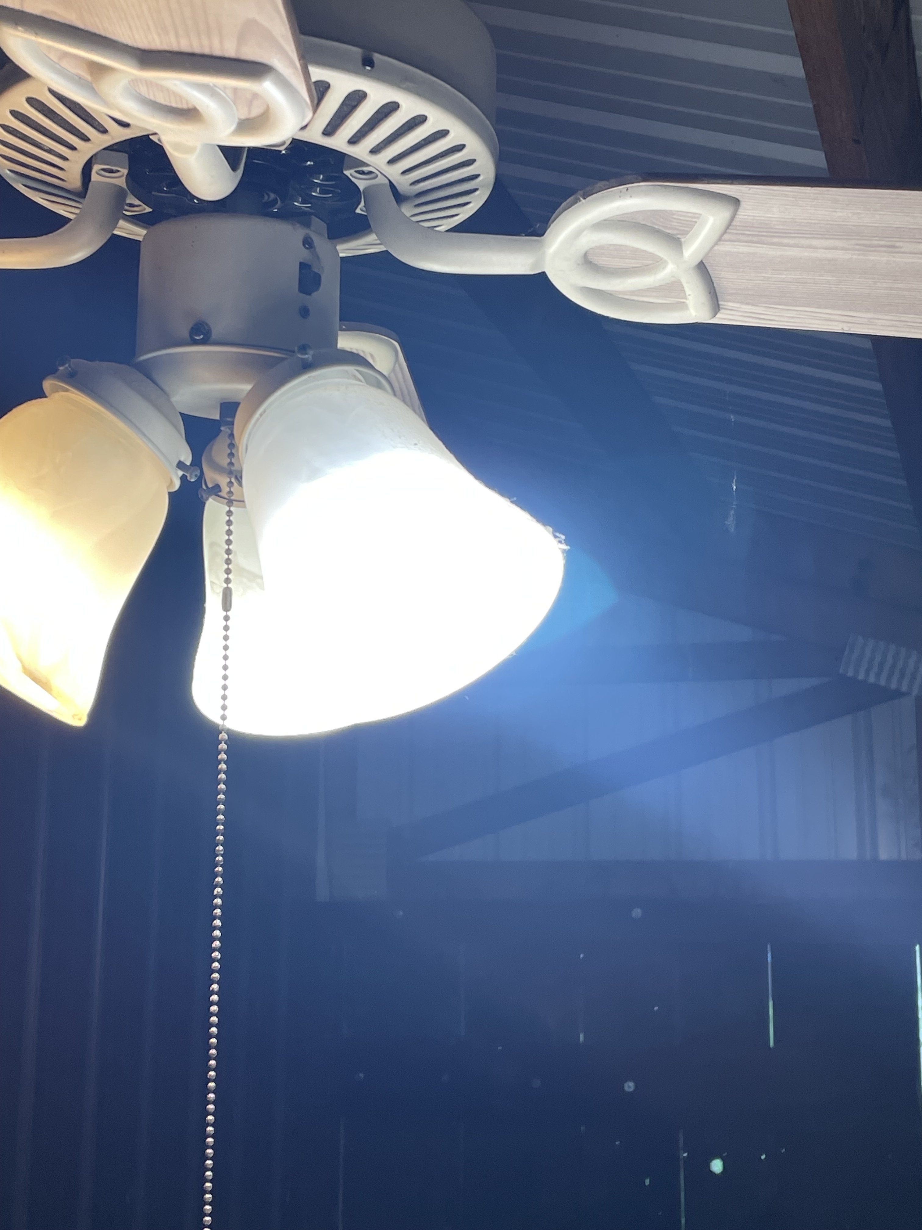

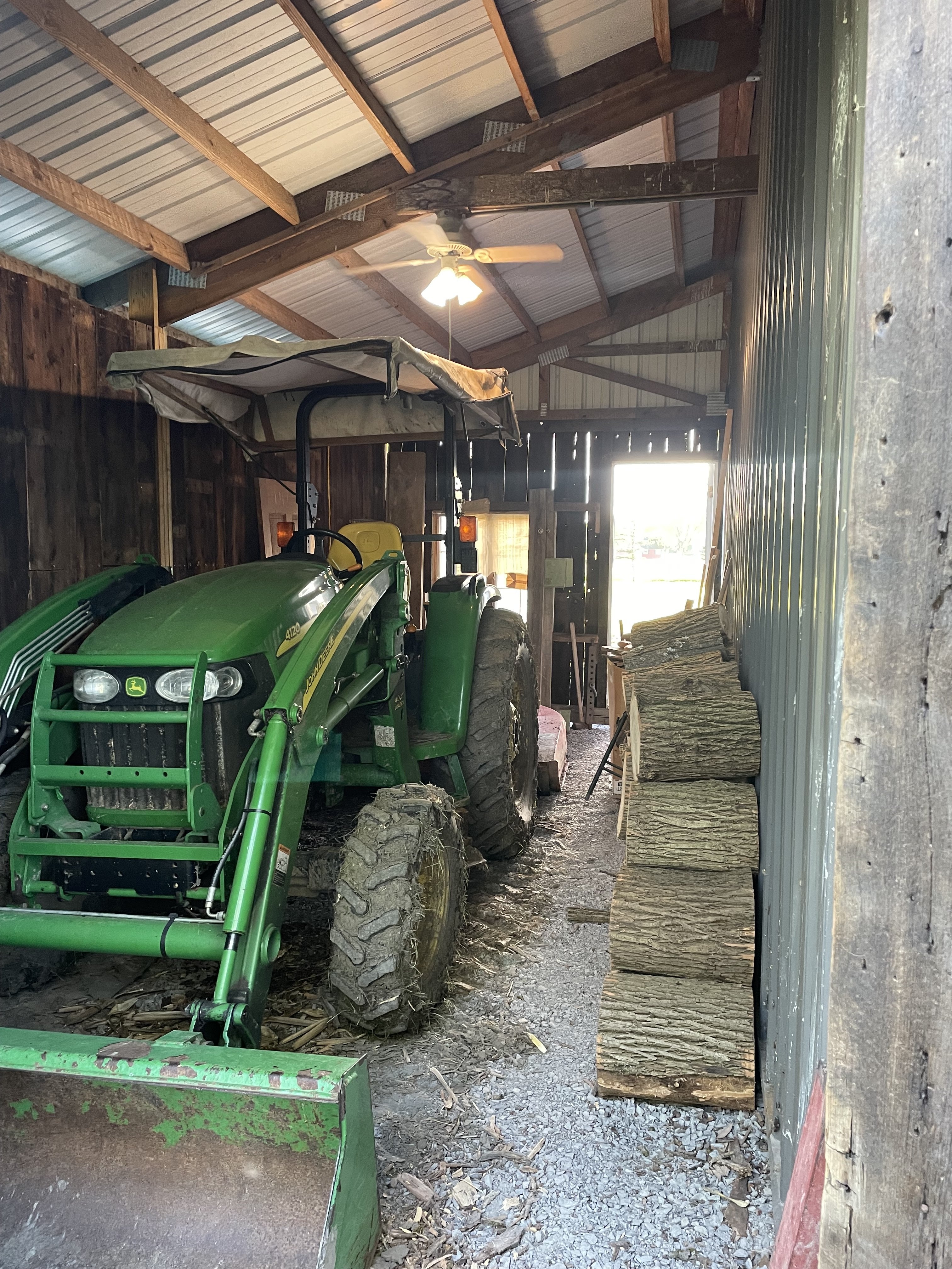

I wired up the ceiling fan / light fixture, that I salvaged from our house office/spare bedroom, in my splitter shed today. It took me almost exactly the half hour that I thought it would, and I didn’t need to purchase any parts. The tractor canopy worked perfect, to hold up the fixture, while I was wiring it.
I ended up with almost a foot of clearance from the bottom of the lights to the top of the tractor canopy when installed, so I didn’t need to scrape any of the gravel off of the floor. I guess I’ll have to spring for a load of gravel or blacktop millings, if I want to extend my driveway for the truck camper, this summer.
It would have went a little faster, but when I got done and turned the fan on, I couldn’t feel much breeze below. All (3) fan speeds worked with the control chain, but I didn’t notice much change in the breeze at the different speeds.
I saw what the problem was, as soon as I shut it down and watched it stop spinning. It was running backwards, blowing up, not down. I thought maybe I’d need to remove the blades and reinstall at the opposite angle. Fortunately, there is a little “forward/reverse switch on the side.
I flipped that, and all is well now. There is a real good breeze, throughout the whole 10 x 25 ft shed, when it’s turning at top speed. It was dead calm and 80 degrees outside this afternoon, so that made it very comfortable inside.
With (3) bulbs on it, I also have (3) times the light out there, that I had prior. I’m looking forward to getting that face cord of ash split during the rain this weekend. I can easily reach the fan speed control chain from the tractor platform, and the light switch chain from the ground.
