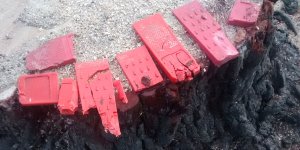

There's a significant variation in plastic wedges too. K&H red heads are darn good. It isn't much fun relying on crap wedges either:
   / Tractors and wood! Show your pics #3,049
When plastic meets reality! :)
