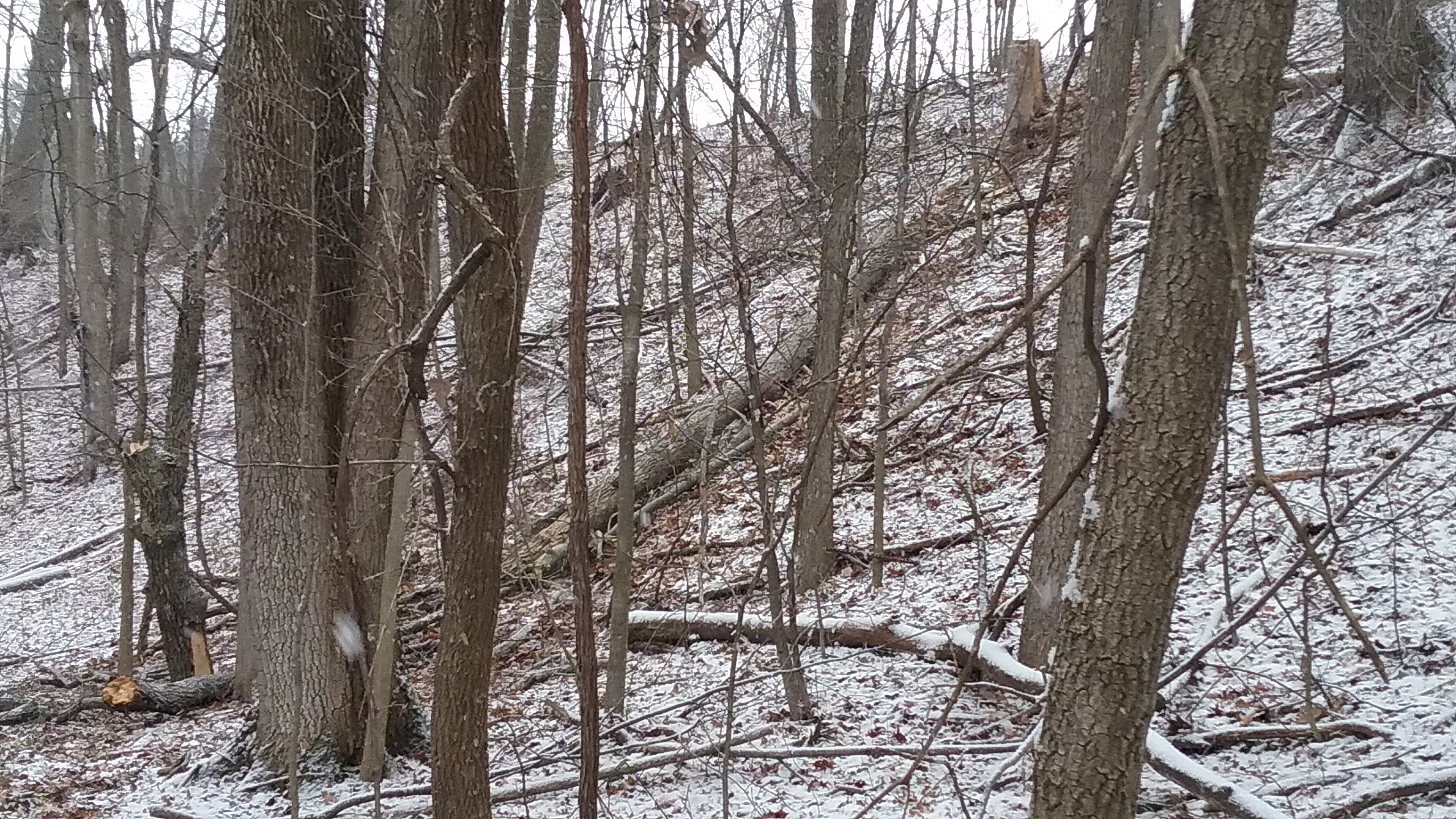

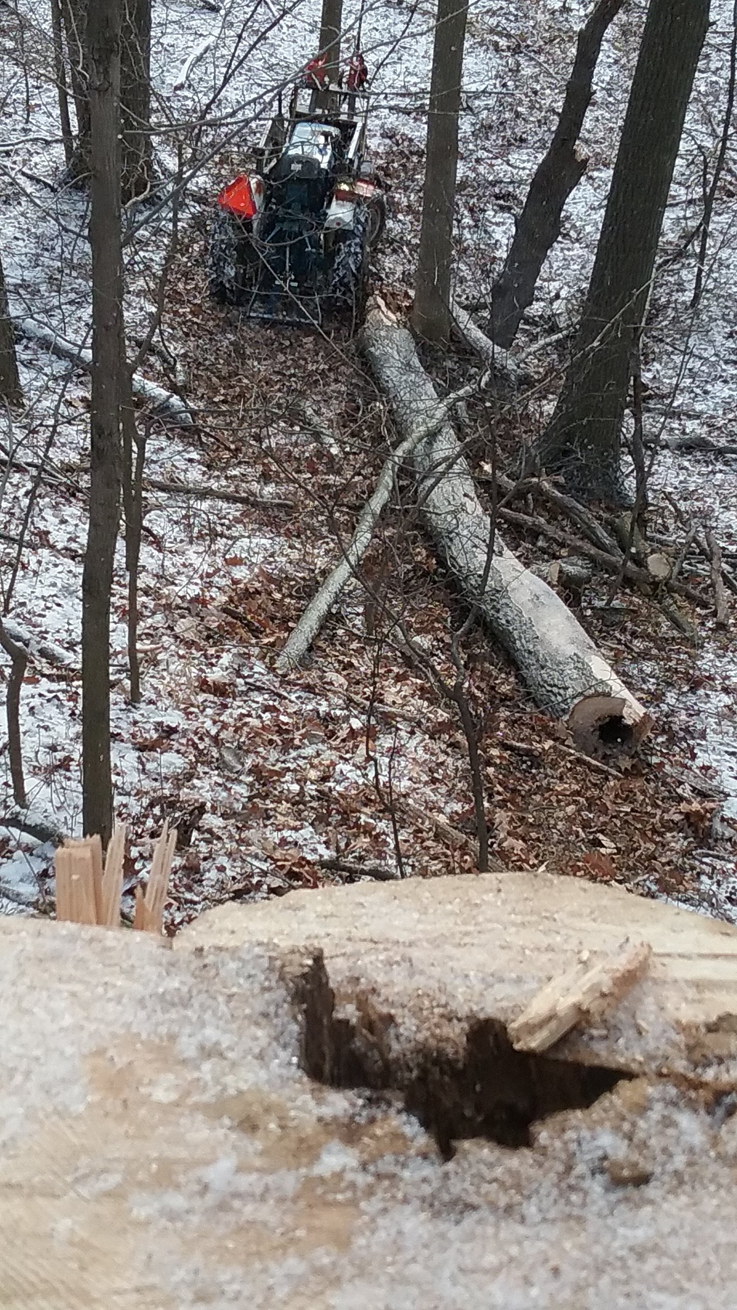

I wasn't real keen on taking this 16~17" hollow center dead ash from the top of a steep 25~30' ridge yesterday. I needed it to fill an order and with snow forecast, which can make it a lot more work to get wood out of the ravine, it became top priority yesterday. Not sure which was more exhausting, half crawling / half pulling myself and gear up the slope or the mental exercise of trying to get it on the ground where it would be easiest to skid out in one piece. Needed to drop it 90 degrees from a pretty strong lean. Ended up ~ 15 degrees short and took out a 6" oak I intended to leave :(
View attachment 491140View attachment 491141

All the things that went wrong for you are the scenarios that kept running through my mind. It started to go 2 times and i retreated only to have to go and nibble a little more on the hinge.
Glad you came out of it okay!
