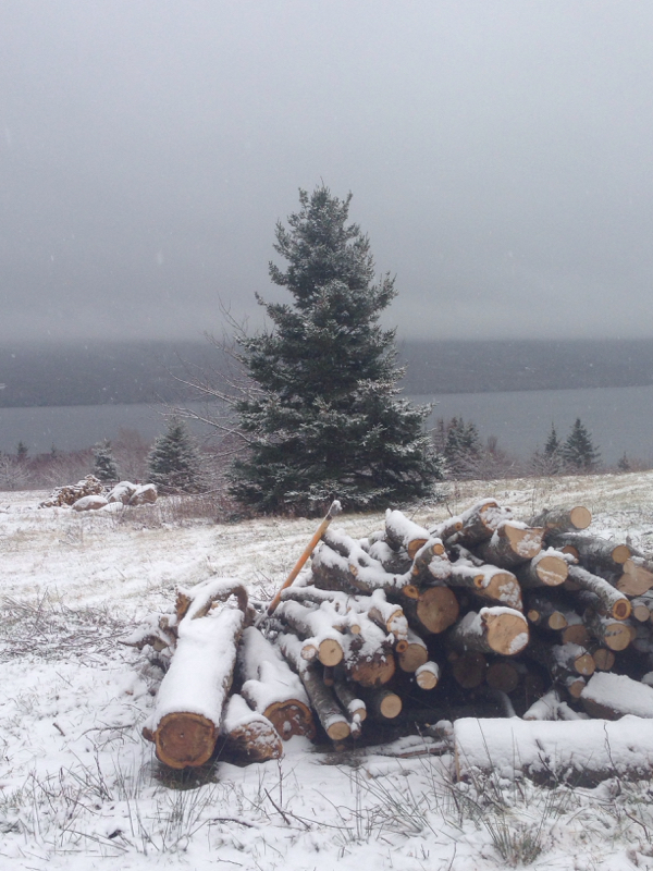

Not much winter here so I was able to cut a bit of firewood and use my Wallenstine winch on my l4740. Think I will rig up a remote control over the winter. Today's snow covered the farm and the wood piles. The white snow contrasted the waters of St Ann's bay. A beautiful site indeed.
   / Tractors and wood! Show your pics #503
Nice picture for sure ga. We could use some of that snow and cold. We have had warm and rain for over 3 weeks now. I have a lot of logs cut and down in the woods but it is to muddy to skid them out. So muddy I can hardly get down in there to cut. Hope it freezes back up before it snows to much so I don't have to dig them out.
This is a nice scene.
