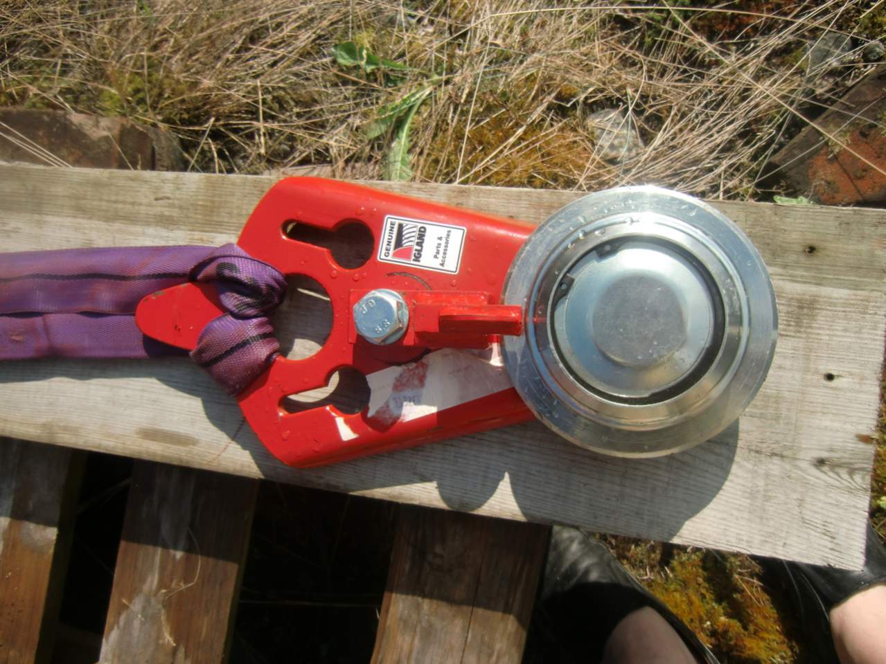

Also, I am looking for recommendations for a self releasing snatch block.
   / Tractors and wood! Show your pics #518
Have this and Im happy
   / Tractors and wood! Show your pics #519
I have a clone of the Farmi block. It is heavy duty and would go with your big winch. It weighs 13 lbs.
EDIT: Sheave is 5" in diameter.

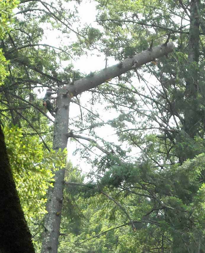

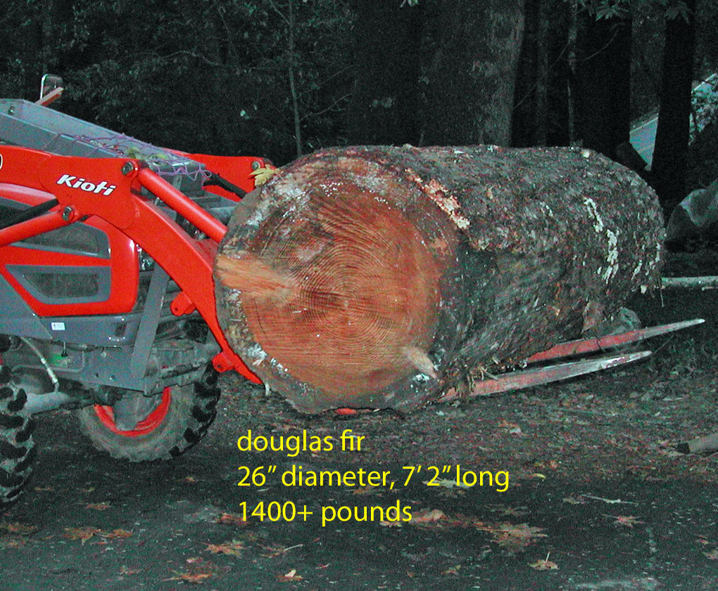

I took out 4 135' trees this year....douglas firs. 3 were leaning and one was sick.
Hired a climber who cut them in sections. Look closely; he's in the first photo.
It took me weeks to clean them up, using cables and a snatch block. I skid them
backwards, using my loader to lift one end. Then, its the forks.
I measured these at 55 lb/cu.ft. when cut, and use that to calculate weight.
2nd photo is my chainsaw-testing log.
