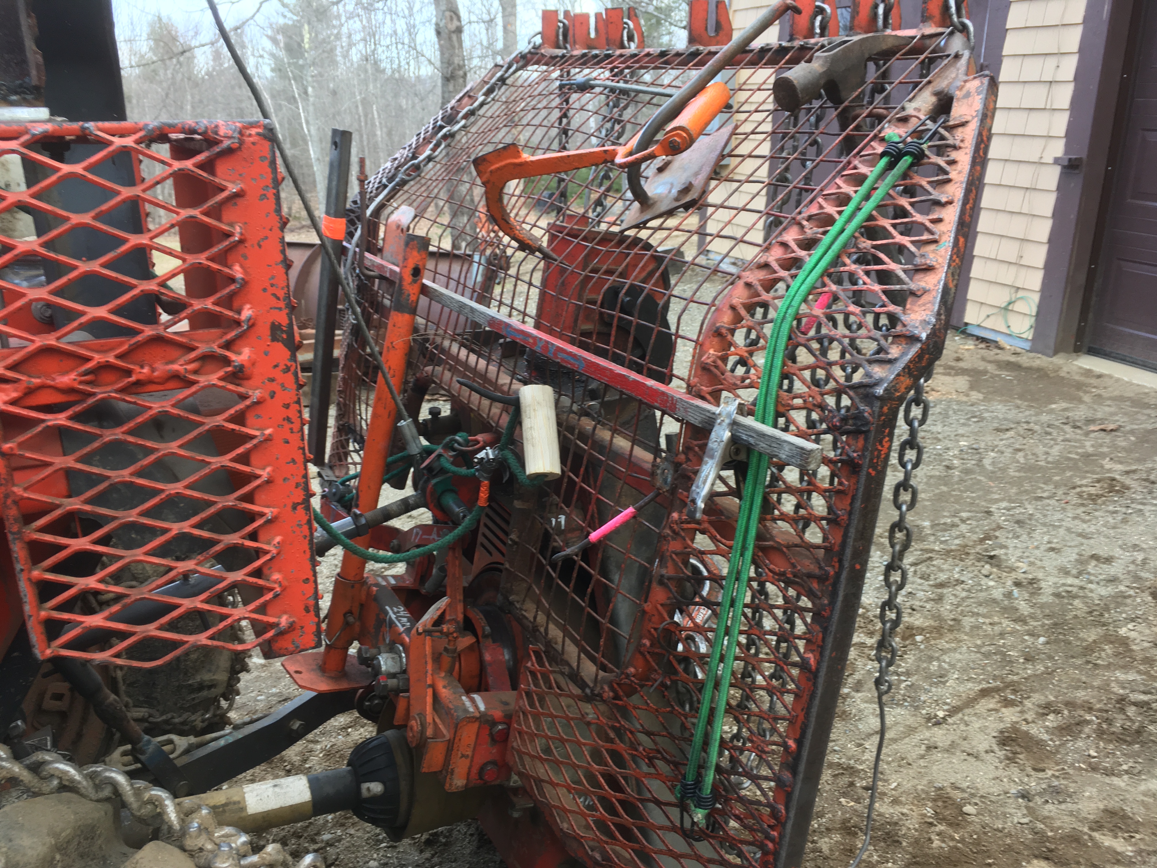

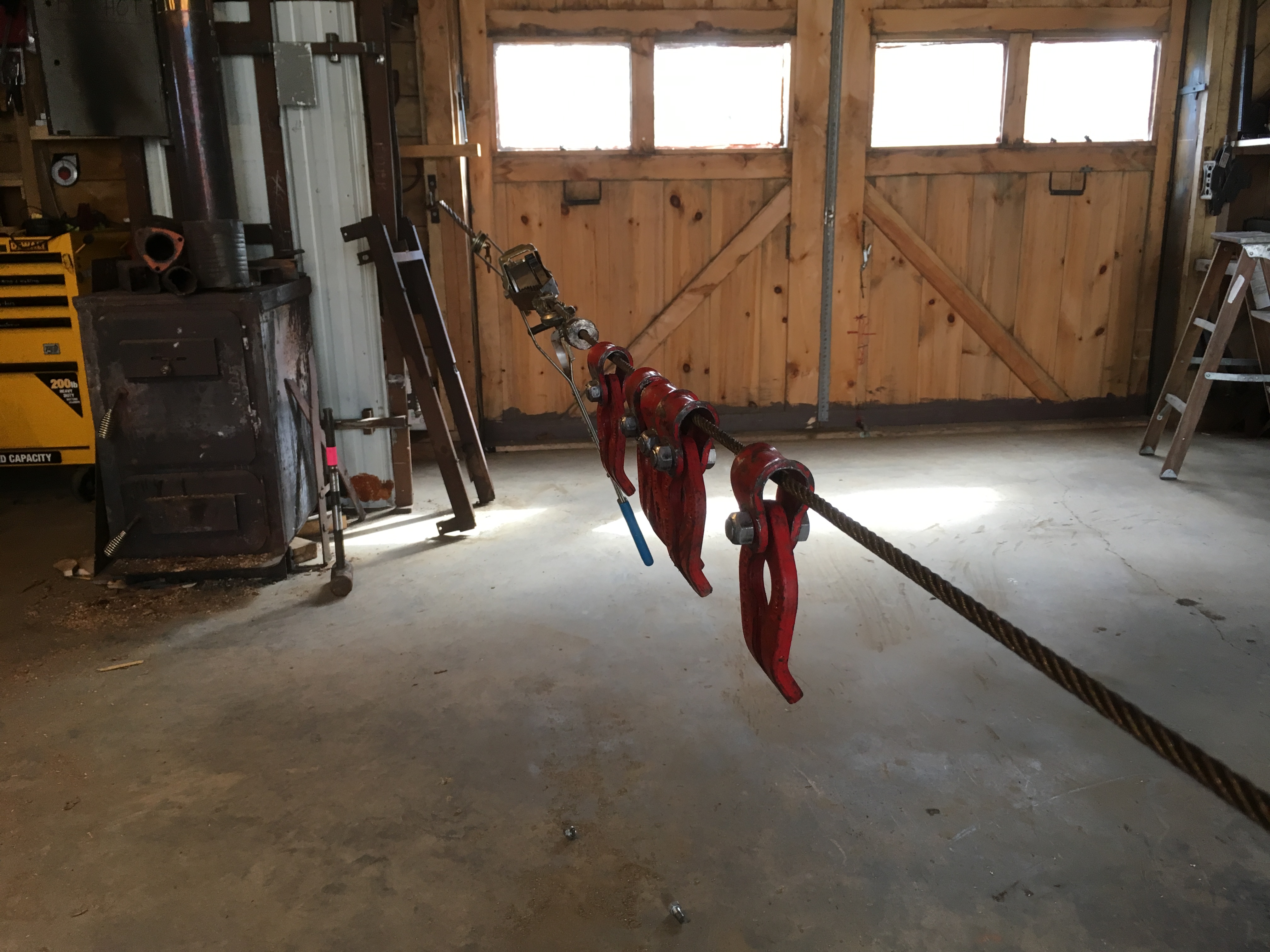

I had another afternoon of doing a 1/2 hour job that turned into 4 hours. My new cable sliders had too much gap between it and the key slot, like a good 1/4", enough the cable kept wanting to jamb inbetween it somehow or skidding chain, (I know no one else would ever have problems like that, Murphy helps me more than others)
So with the bolts runned out of threads, thought it would be quick and easy just to add some more, 45 min at the most, so I measured and marked and added 1/4" more threads, put the first slider on and those expensive cheap alluminum/steel slider keyhole threaded bolts striped right out with just barely putting a squeeze on the slider, tred another one and same thing, 2 down 3 more bolts to go.
Plan B> Before trying it again I'll squish them a little with the vice, first slider going hard, I grab a short piece of pipe, not short enough, broke my old vice. Plan C> I'll put a vice grip on it and hit it with a hammer, hammer not big enough, the slider ricocheted off the bench, grab bigger hammer, the slider went flying further hit the wall and bounced around behind the woodstove.
Plan C>> Put vice grip back on and this time I'll use something with more pressure, wood splitter, with 2 attempts and 2 times flying and getting frustingstrayted, I gave up, those things must be spring steel, we'll there goes a good two hr.
Plan D>>I went to the tractor place and the first thing I looked at was a new shiny Fransgaurd V3004 winch, those sliders had very little gap between the slider and keyhole chain slot which is what I thought they was supposed to be, not over 1/4".
So there I bought $30.00 worth of 1/2" x 2" bolts, 5> of grade 5 fine threaded bolts and nuts, wanted case hard bolts because things was going hard but only had them in coarse thread so I bought them to, with lock washers locking nuts. I got back home, tried the fine threaded ones first and with a little never seize I wound them blanking things on there with an impact wrench, with 4 hours gone DONE DONE DONE and DONE, Hallelujah........
Now the next little thing I wanted to do 3 hours ago, adjust the the winch engagement pressure and put something on the pull cord rope for a handle, grabbing that rope to engage the clutch has always been something for the young and full of Wheaties to use. I sawed out a small piece of wood on table saw, smooth it out with a sander and drilled a hole in it, with some duct tape around the rope and a couple hose clamps I now have a rope handle, I yanked on it a few times, seems to hold, until the next time I use the winch.
