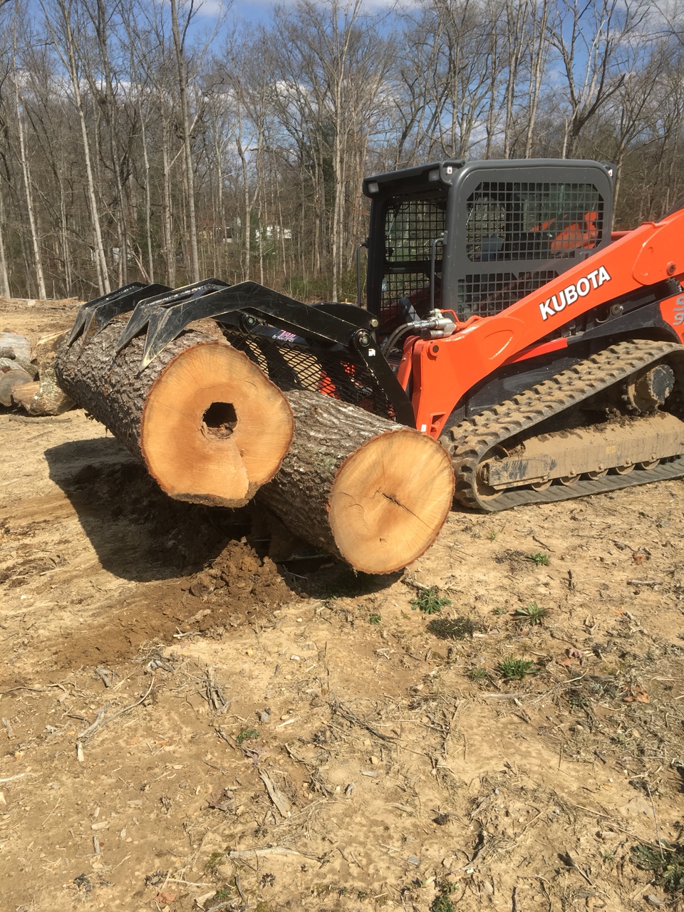

I pulled out some big logs which sadly won’t make saw grade. 2 at a time was really a bit much to handle but I had to see if it had the muscle to do it. My l3240 would have never budged one. IMG_4001.JPG

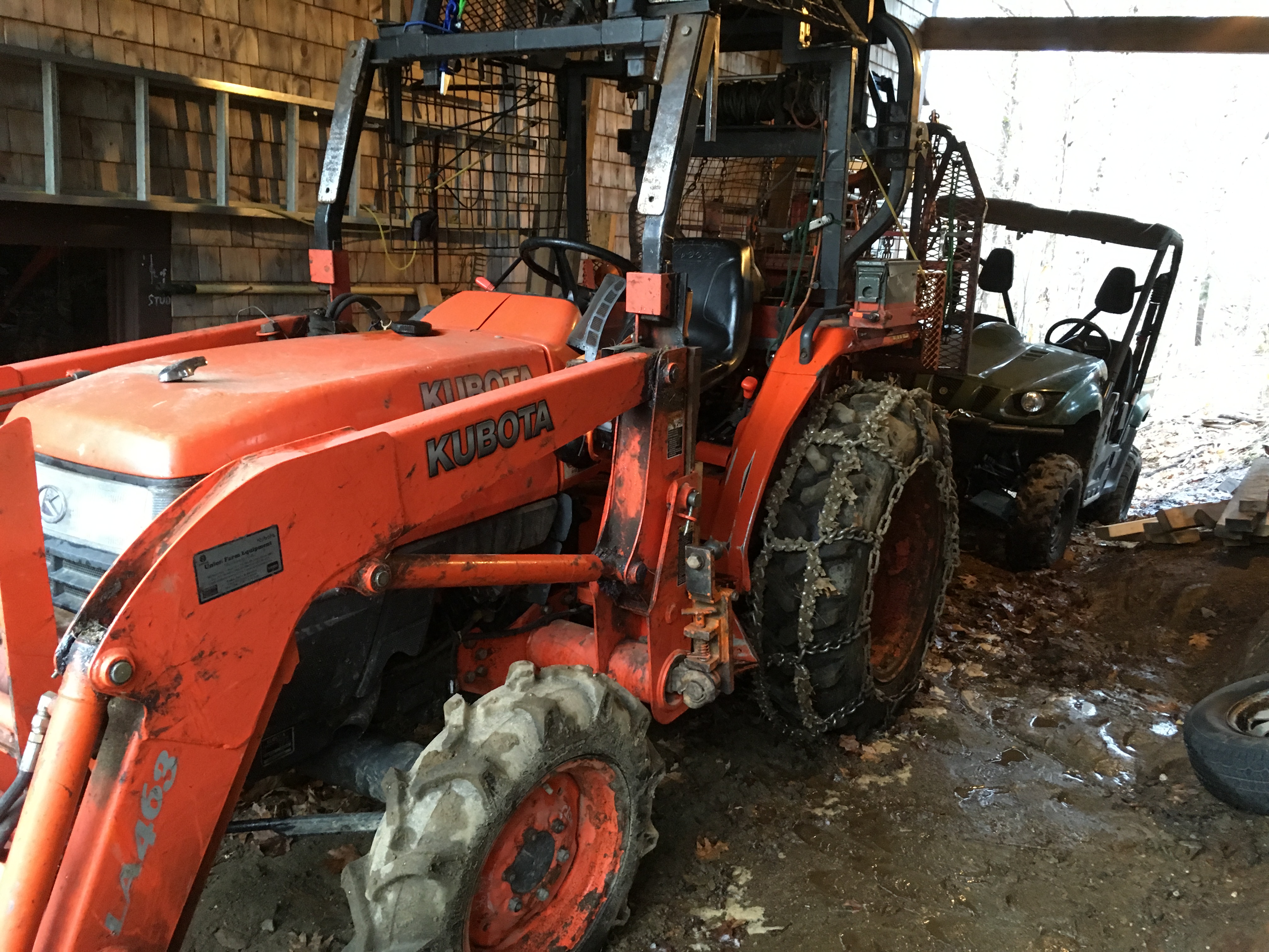

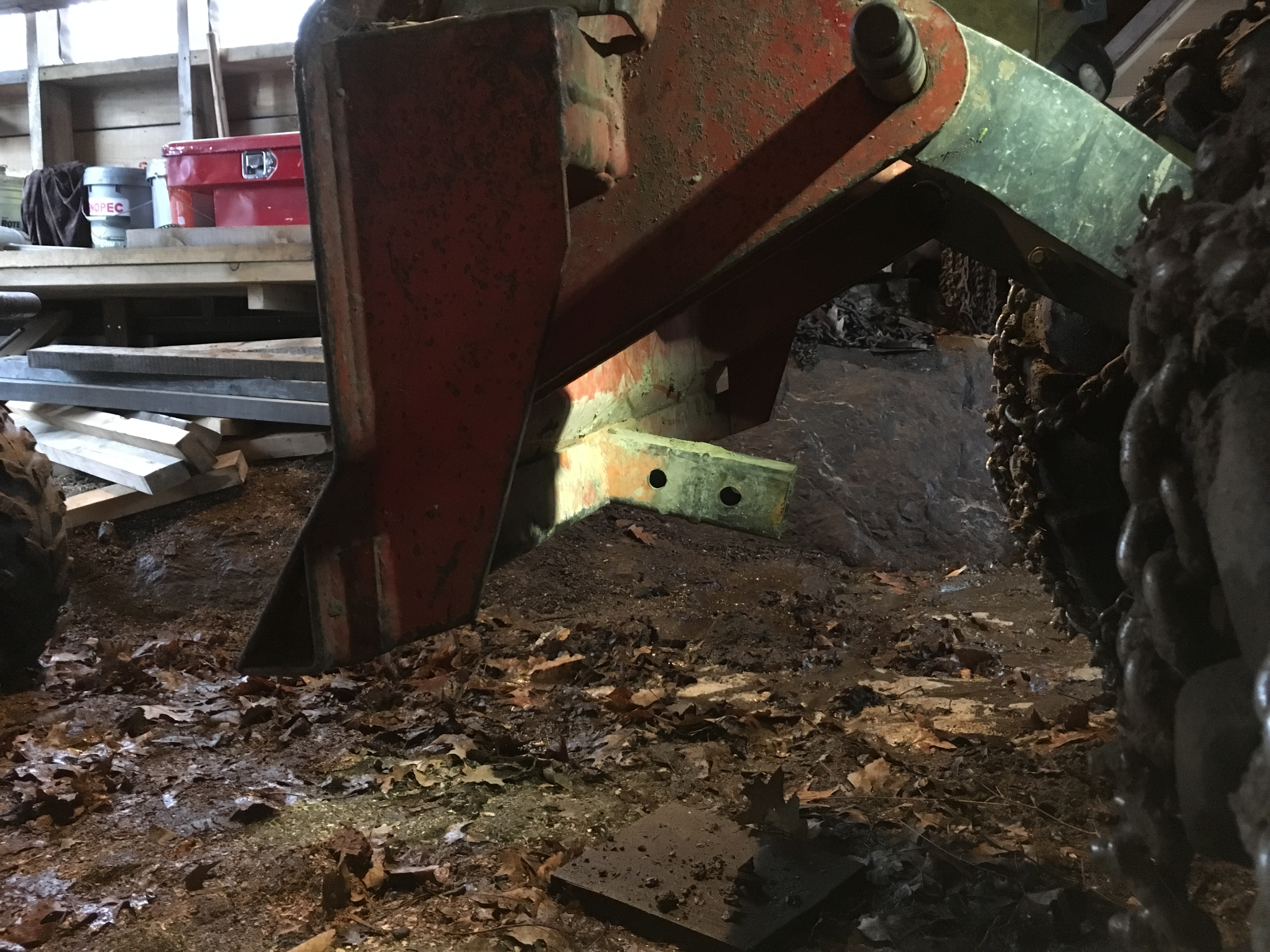

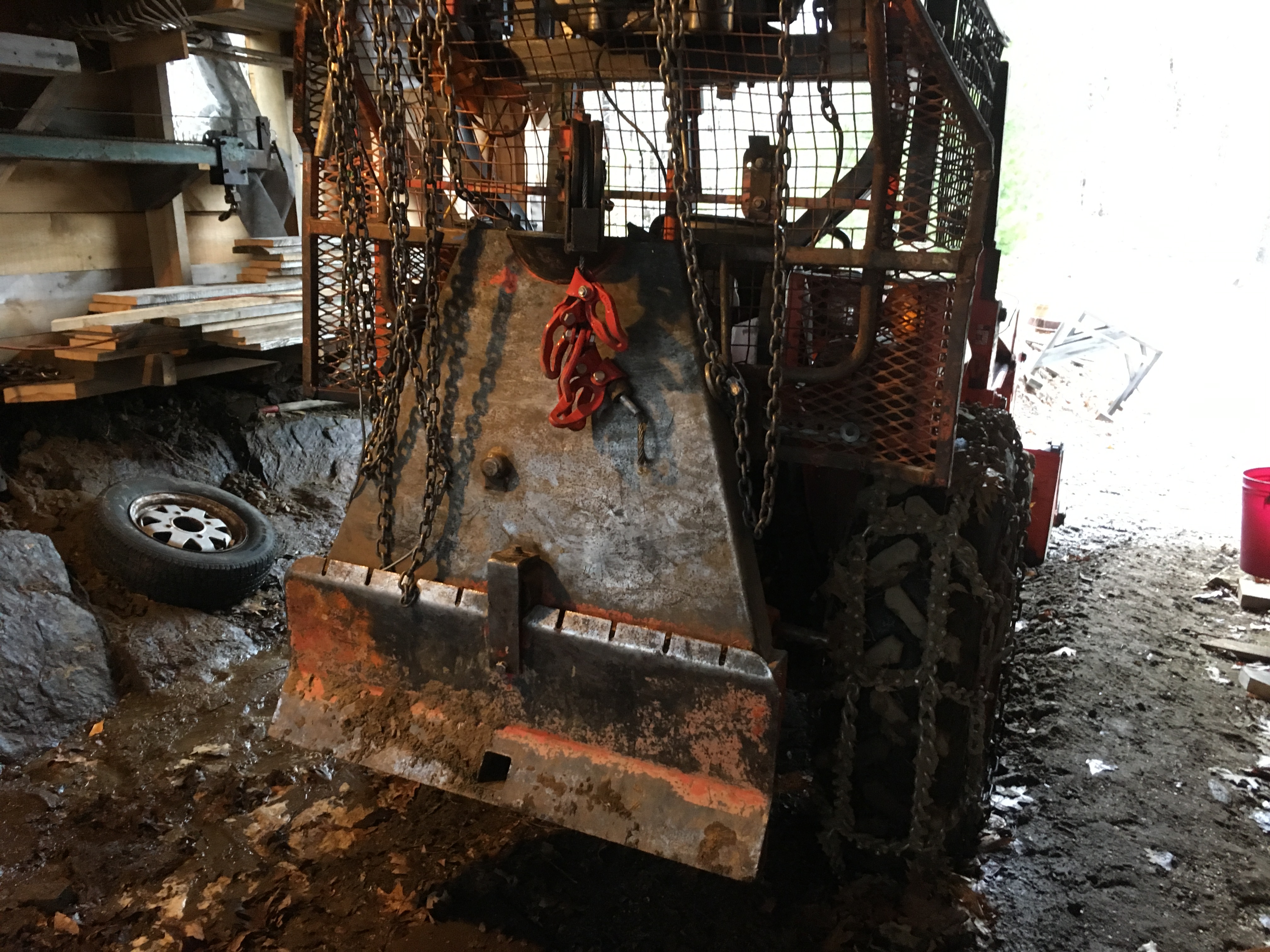

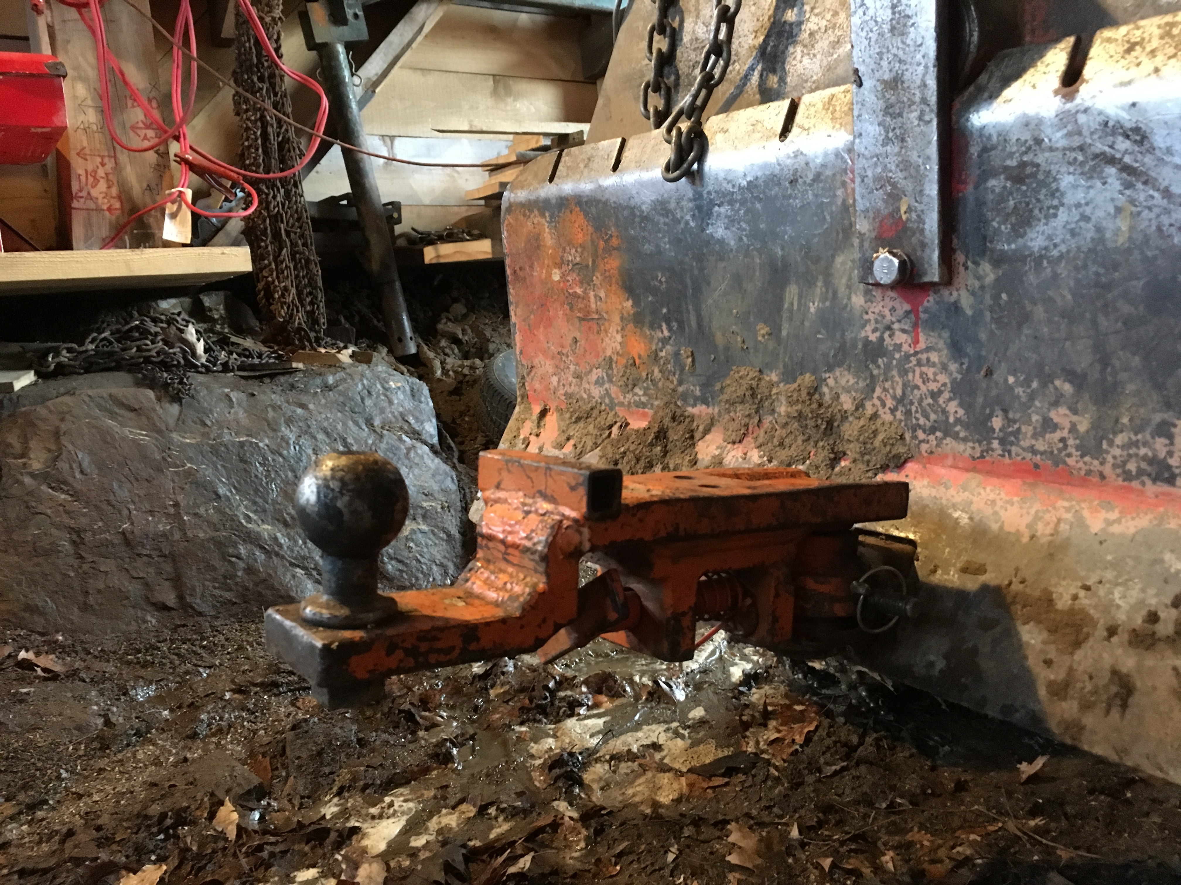

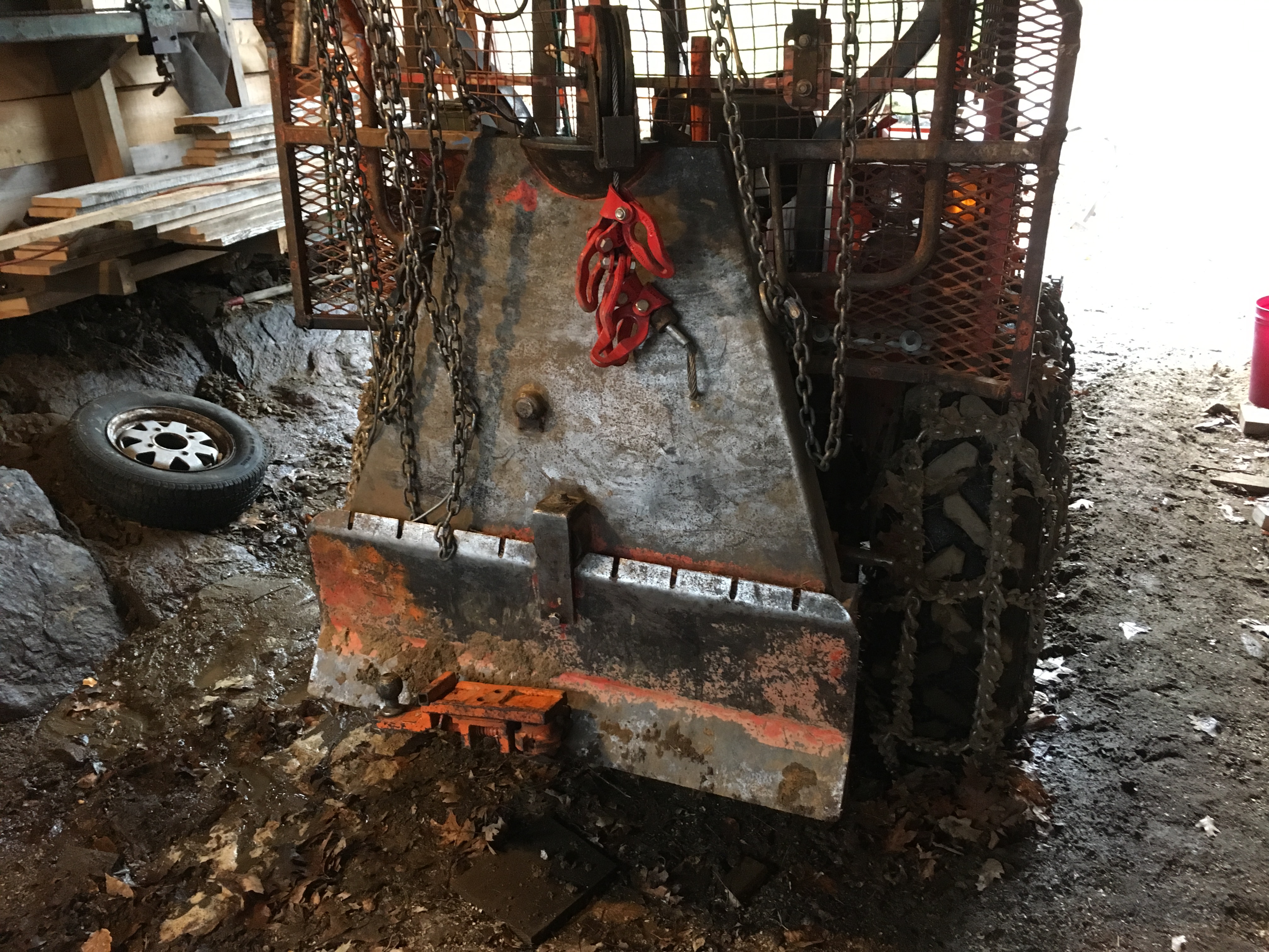

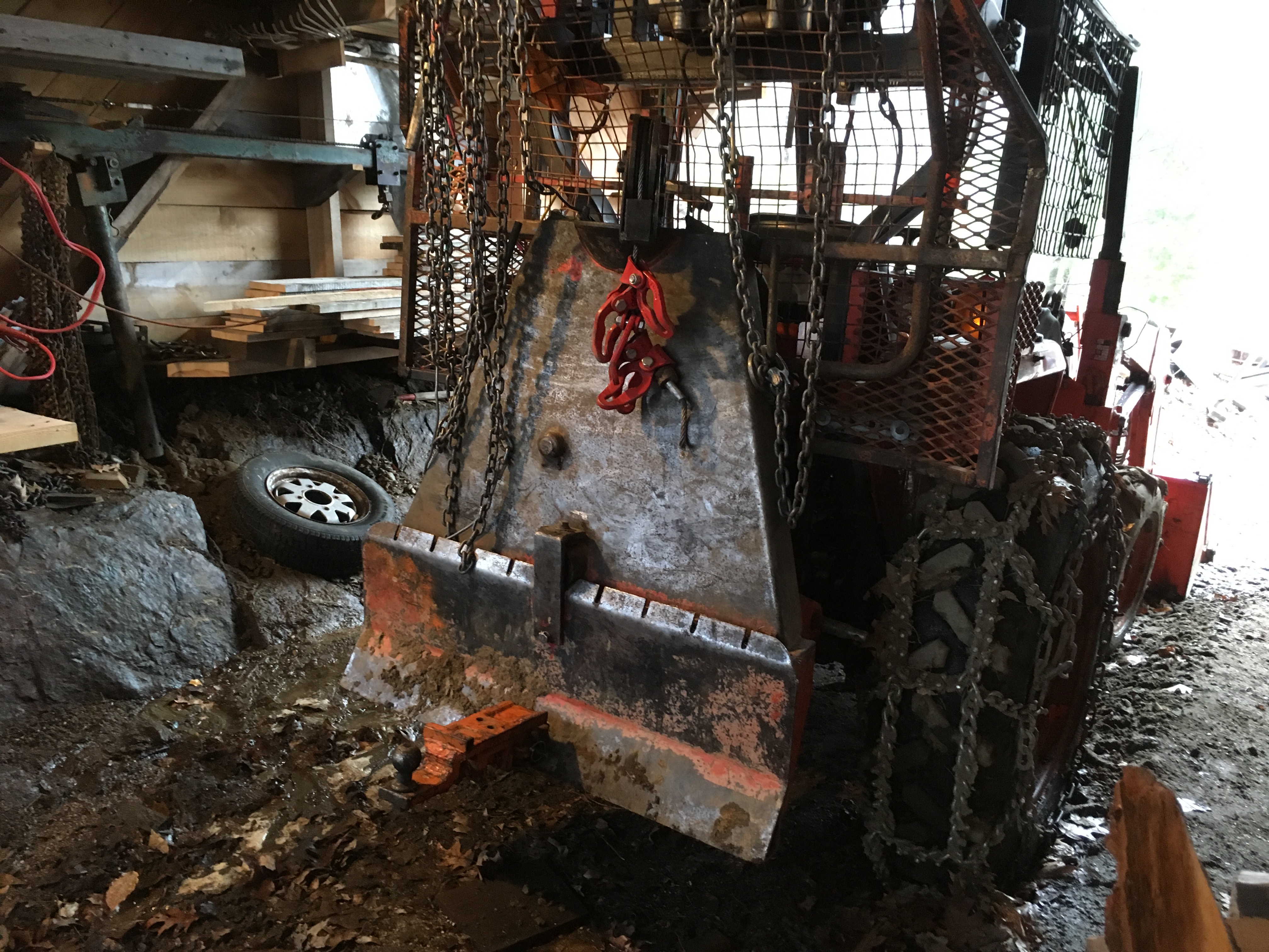

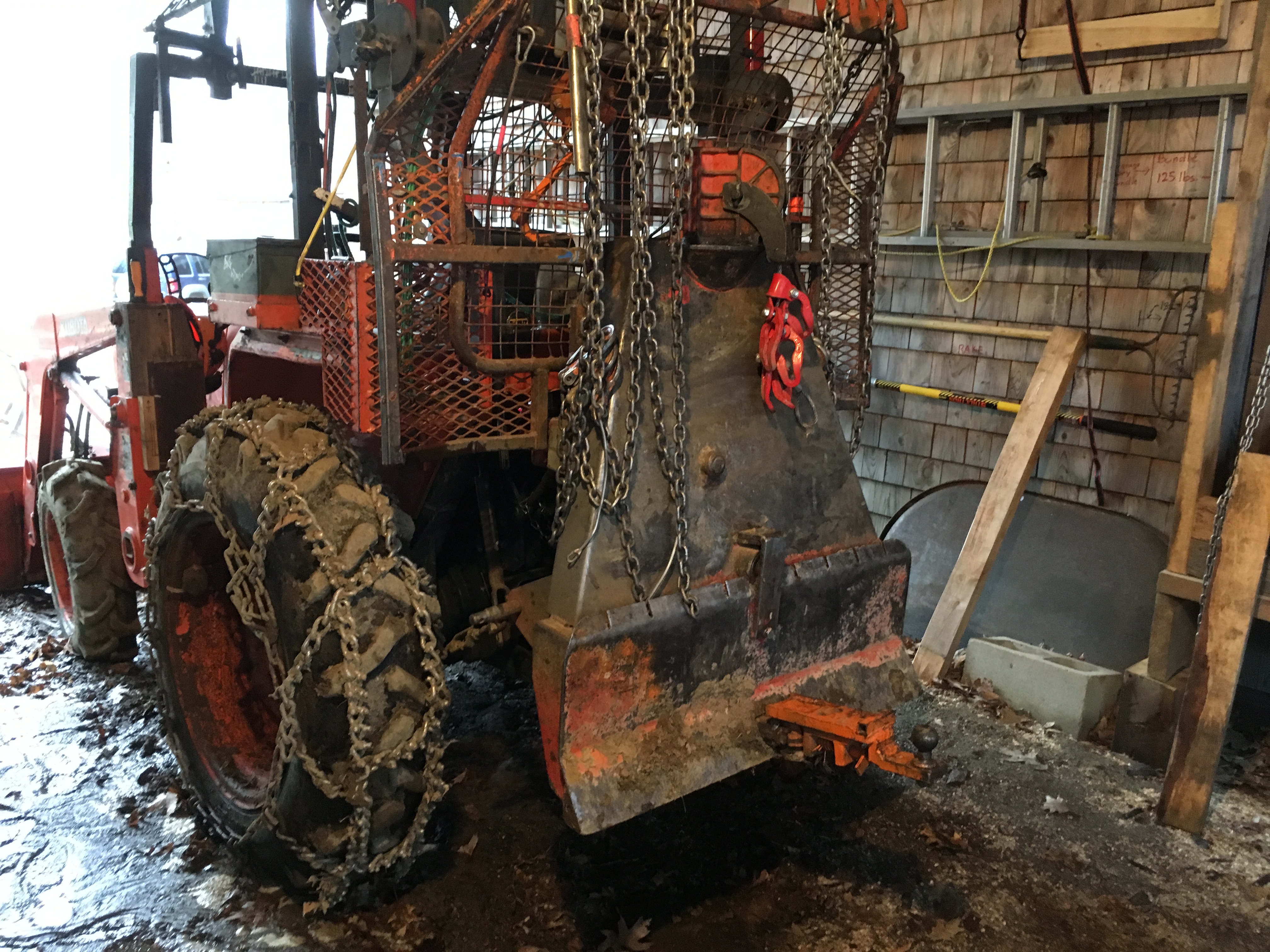

"or are you loading from a pile that you previously skidded to a landing or bunching area"1> Yes from a bunched area in the woods. 2>> yes trailer is unhooked from tractor, I'll try another video link of loading logs>>>> Logging - YouTube 3>>trailer hitch is on the winch when in use, picture time>>>>>>>>>>
View attachment 549375 View attachment 549376 View attachment 549377 View attachment 549378 View attachment 549379 View attachment 549380 View attachment 549381
Pic 1>>>temp use, 2,3,4>>trailer hitch ready for hook up use with extra 1/2" case harden bolt to keep the hitch from swinging, 5>>>hitch not in use and stowed behind front tire on loader mount, 6&7>>>2" receiver welded in the winch.
Impressive work! You’ve turned that machine into an aggressive beast.
I see your Rhino back there. How do you like it? (I don’t want this derailing like I did with the saws). I just get excited. With that, I keep getting advertisements for Dolmar / Makita saws. I’ll have to find a thread on those. Pro saw for 20-30% less than stihl.
