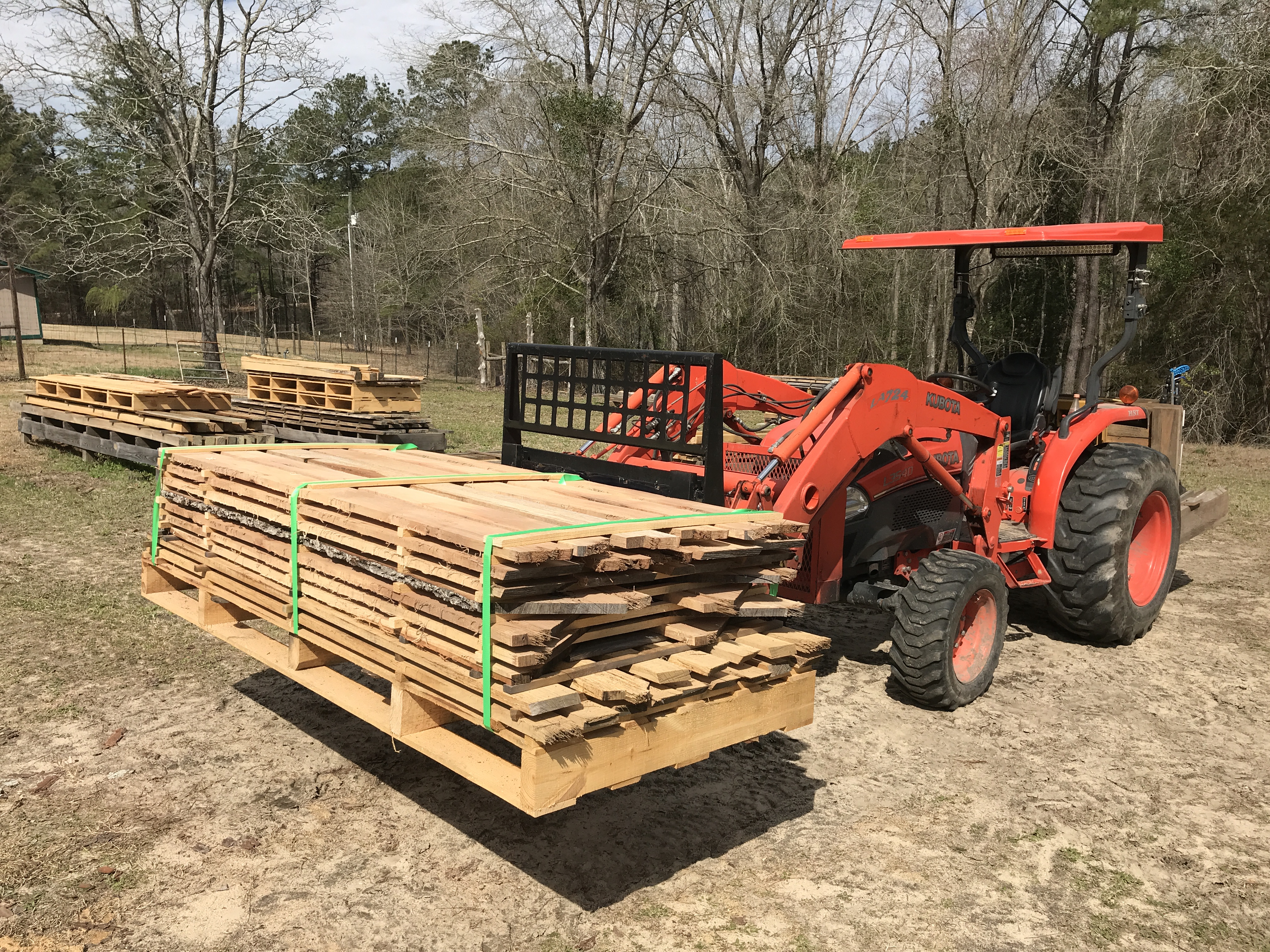

More stickers, and I keep my stickers at 3/4" to control sticker stain. Start the stickers at the end of the boards and keep them all lined up, for starters...
SR
Haven't you also mentioned using the same species for stickers as for boards to reduce staining?

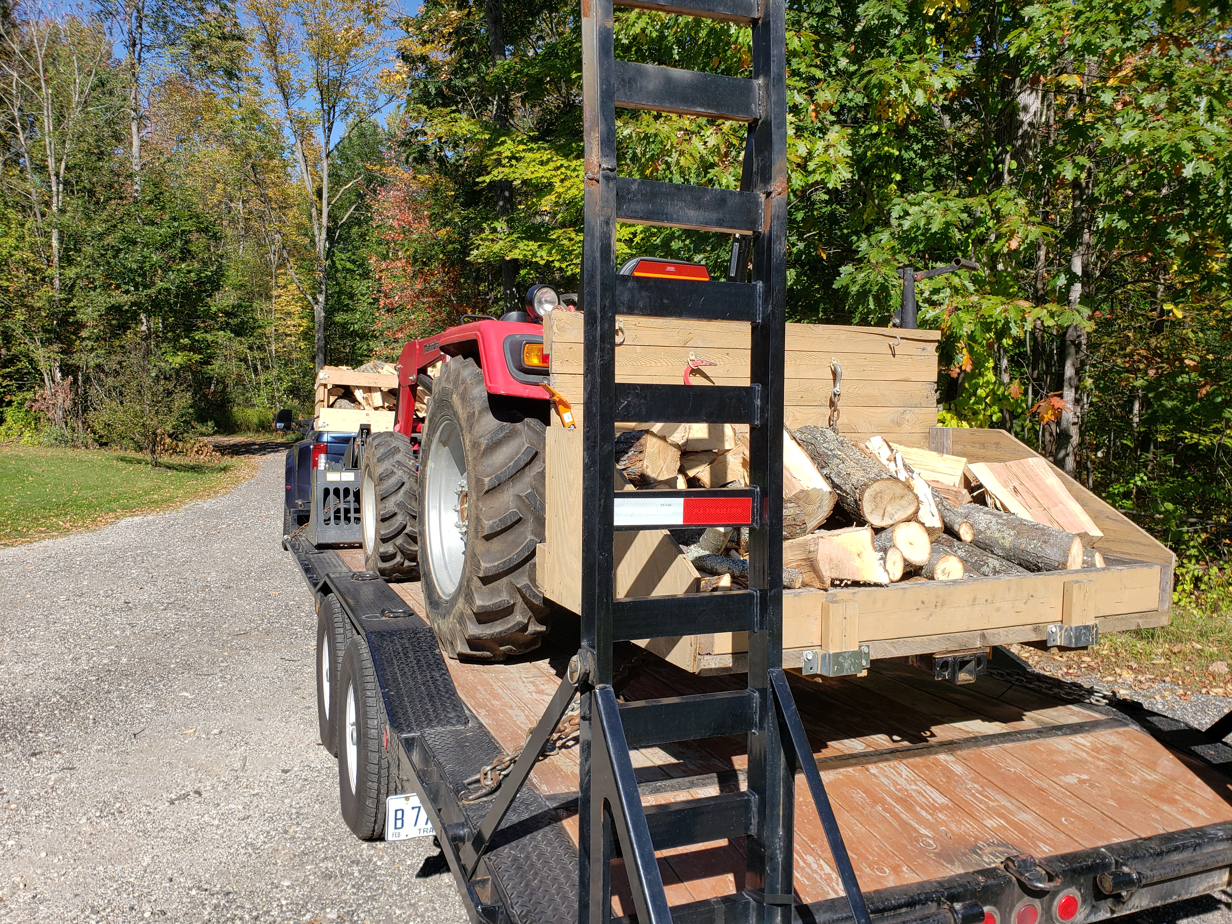

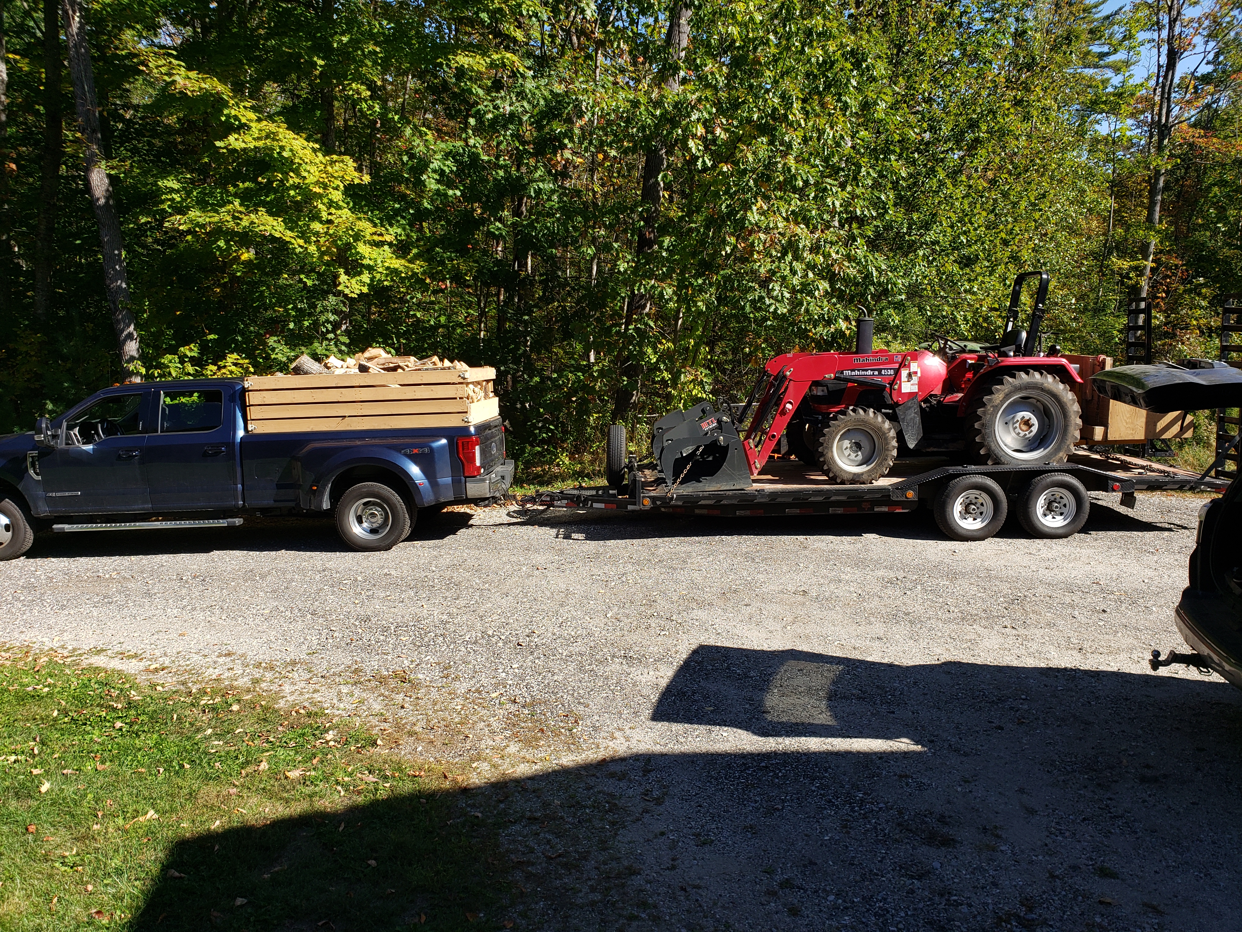

Can someone test the attach picture above to see it shows McDonalds, think I fixed it..............
Yep, there are pics now, not links, and they are of a 4 wheeler not McDonalds.

Maybe we are wrong?? What are you doing differently?
I sticker mine about very 16-24 inches and keep the stickers lined up.. but I'm pretty new at this. I also ratchet strap my piles to keep them from warping too bad, seems to work for me.
I don't remember saying that, but many say it SHOULD be done that way.
I think it's MUCH more important to have DRY stickers and I always make sure to use dry stickers, I always have a pile of stickers cut and drying,
You can see, I have a place to put them right at the mill,

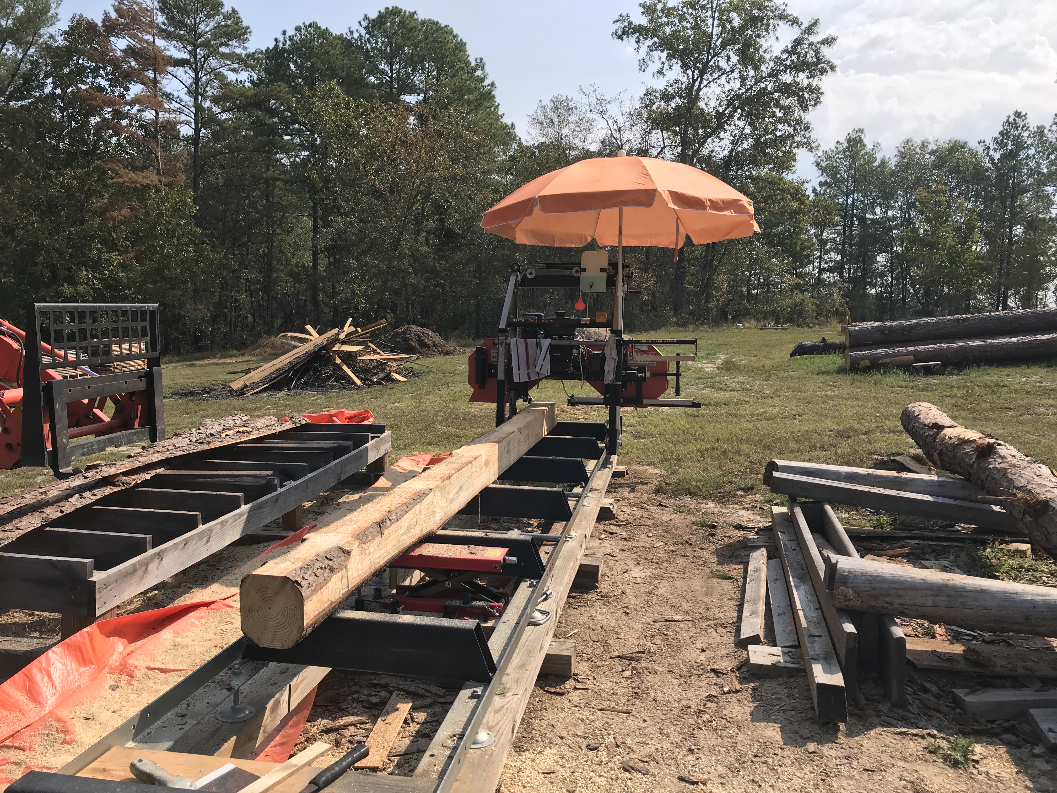

Cutting some 16' core centered 6x6's to eventually support the roof over my sawmill and build a 2 story shooting bench/deer stand.
