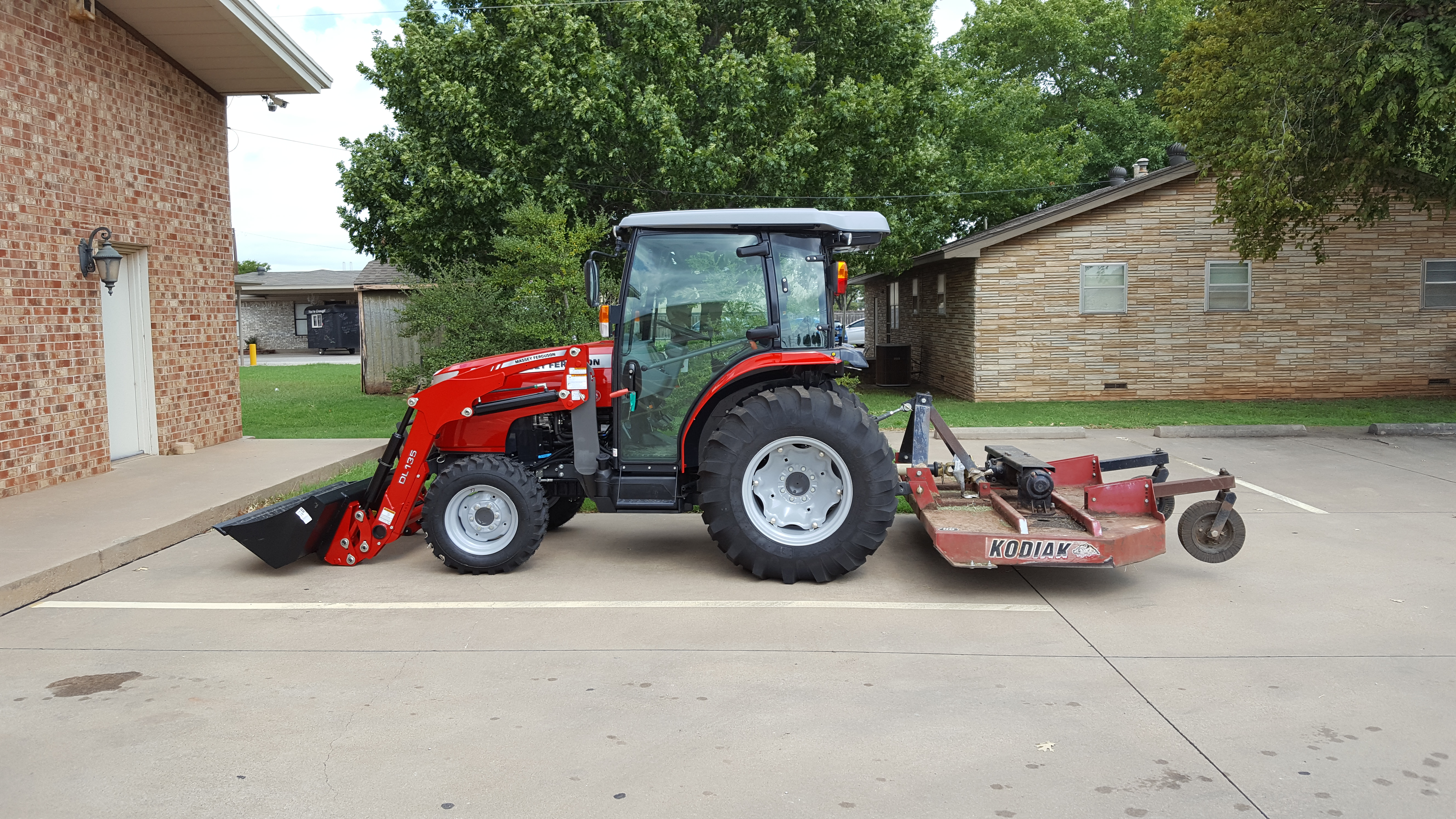

rabbit is a little tuff getting to 2500 with the big tires and it bounces so I do not go that fast. here is a pic to show the tire size. 20160924_122652.jpg
