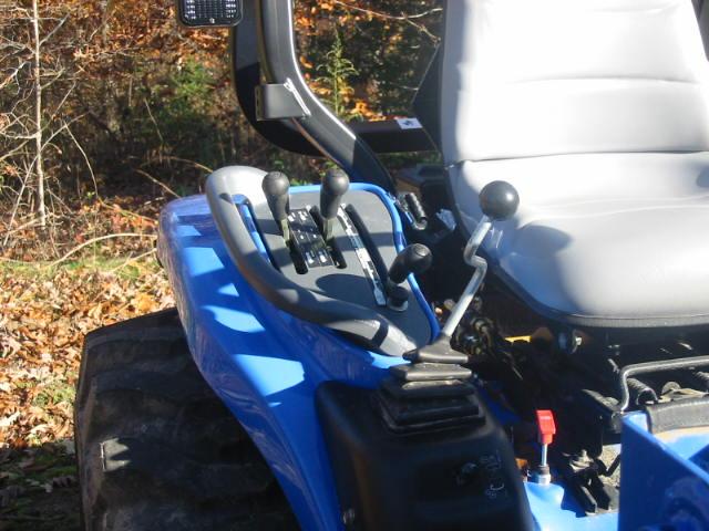

The Loader is operated by a separate joystick mounted on the front of the fender of the TC33DA. In the attached picture, the FEL joystick is the long lever closest to the camera. The lever closest to the operator's seat raises and lowers the 3-pt hitch. The other two black handles operate the two rear remotes - center one for the toplink and outside one for the sidelink.

On the opposite side (Operator's left side) are the Range Shift lever (Orange), Front and Rear PTO (Yellow) and FWD (Black).

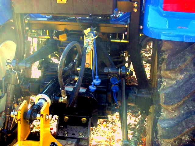

View of the remotes from the rear of the tractor. I have the sidelink off for now -- it would plug in where you see the two blue plugs in the lower right of the picture.

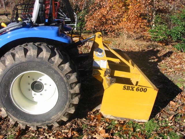

View of the box blade with the toplink retracted (shortened), so the blade will dig.

Final view with the toplink extended, so the rear blade of the box blade will drag -- used for leveling and smoothing everything out.
You also asked about a wood splitter -- it could plug in to either of the remotes. On the TC33DA, you can keep the engine running and operate the hydraulics without being in the operator's seat, if you 1) set the parking brake, and 2) shift the range lever into one of the neutral positions before you leave the operator's seat. I would recommend that you make sure you are on fairly level ground and lower the FEL to help stabilize the rig and keep it from moving.
