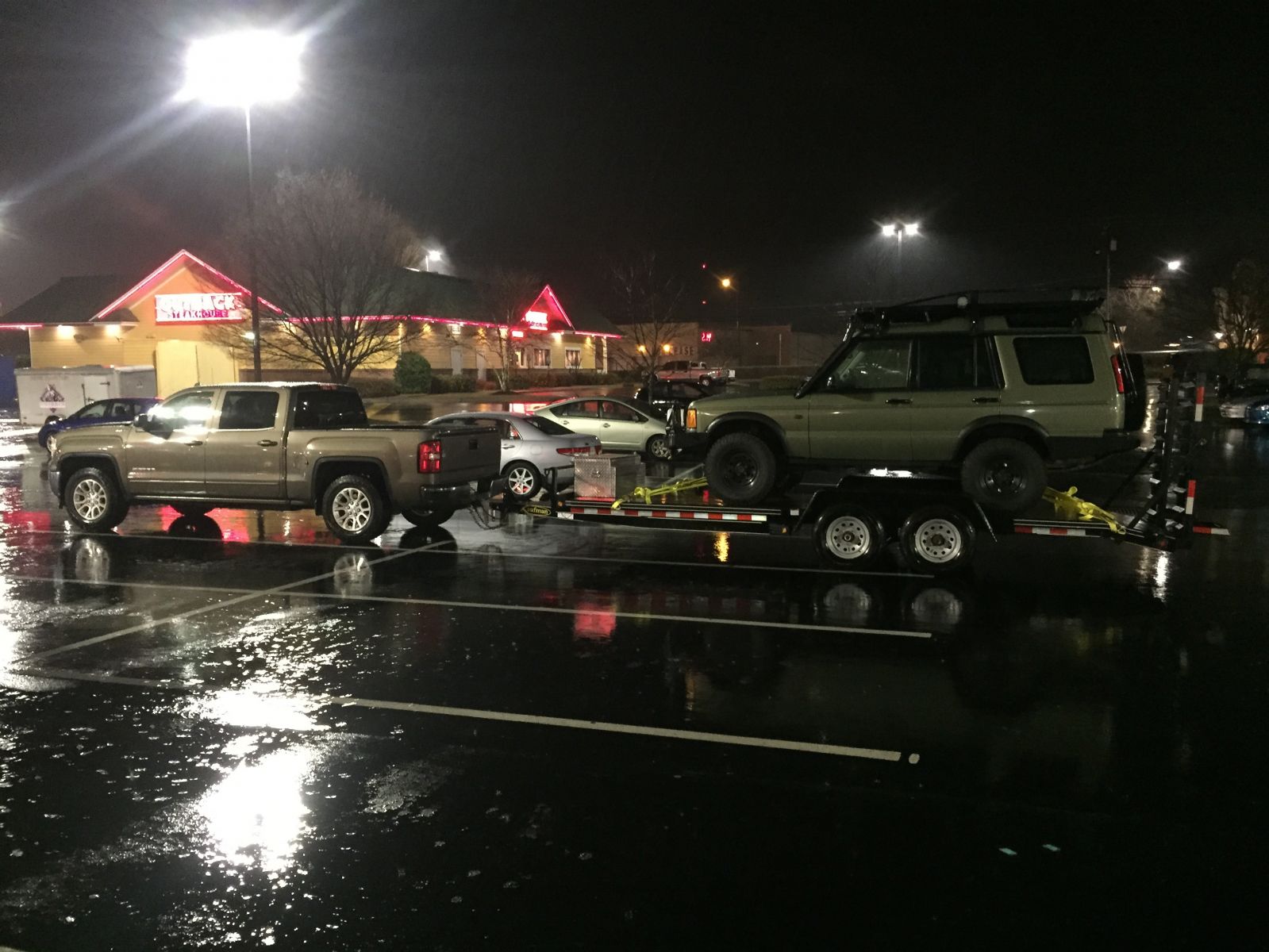

2) For what it's worth, and this is coming from a relatively inexperienced forum member :D, I would just be cautious about the base weight of that trailer and the current towing capacity of your truck. I have a '14 GMC Sierra with the 5.3L that is rated for ~9800 and a 10K 20' Kaufman equipment trailer that the manufacturer claims weighs roughly 2900lbs.
I recently bought and towed a 2000 Land Rovery Discovery II home from Atlanta for my wife. The unmodified curb weight on the Land Rover is supposed to be around 4,500lbs. I would hazard with all the aftermarket equipment the previous owner added (ARB lockers, skid plates, roof rack, air tank, front/rear steel bumpers and running boards) that it is reasonable to say that the DISCO was easily north of 5K.
My truck was able to tow the trailer and vehicle. However ~8K was getting into the range where I would not want to tow that much on a regular basis with my truck. I did purposely by a trailer that was over engineered and therefore heavier because I was tired of the cheap junk available in my area. Long story short, just be aware that you may run into some weight limitations more quickly than you might realize with a heavier trailer, especially if you are not upgrading your tow vehicle anytime soon.
Go look at it, and if it fits your needs buy and take pride in having a nice trailer. Best luck!

That's the balance I'm trying to strike.
My tow vehicle is a 2003 Silverado 1500 HD. It has a 6.0L V8 and a towing capacity similar to yours (right at ~10k#). I like the truck and have no plans to replace it. I just rebuilt the entire front suspension, it has new brakes, new heavy-duty tires, etc. But since it's a 2003 with ~182k miles on it you never know when I'll have to let it go! I figure that I should get the bigger trailer now and a true 3/4 ton truck to match it when this one gives up the ghost.
In the meantime, my plans are to use the trailer to haul the tractor semi-locally (I have a friend with some projects about 50 miles away) and to haul cars to the track (possibly a lot farther away). None of the cars I'd be hauling around weigh over 3000#, so I won't be pushing the limits there.
