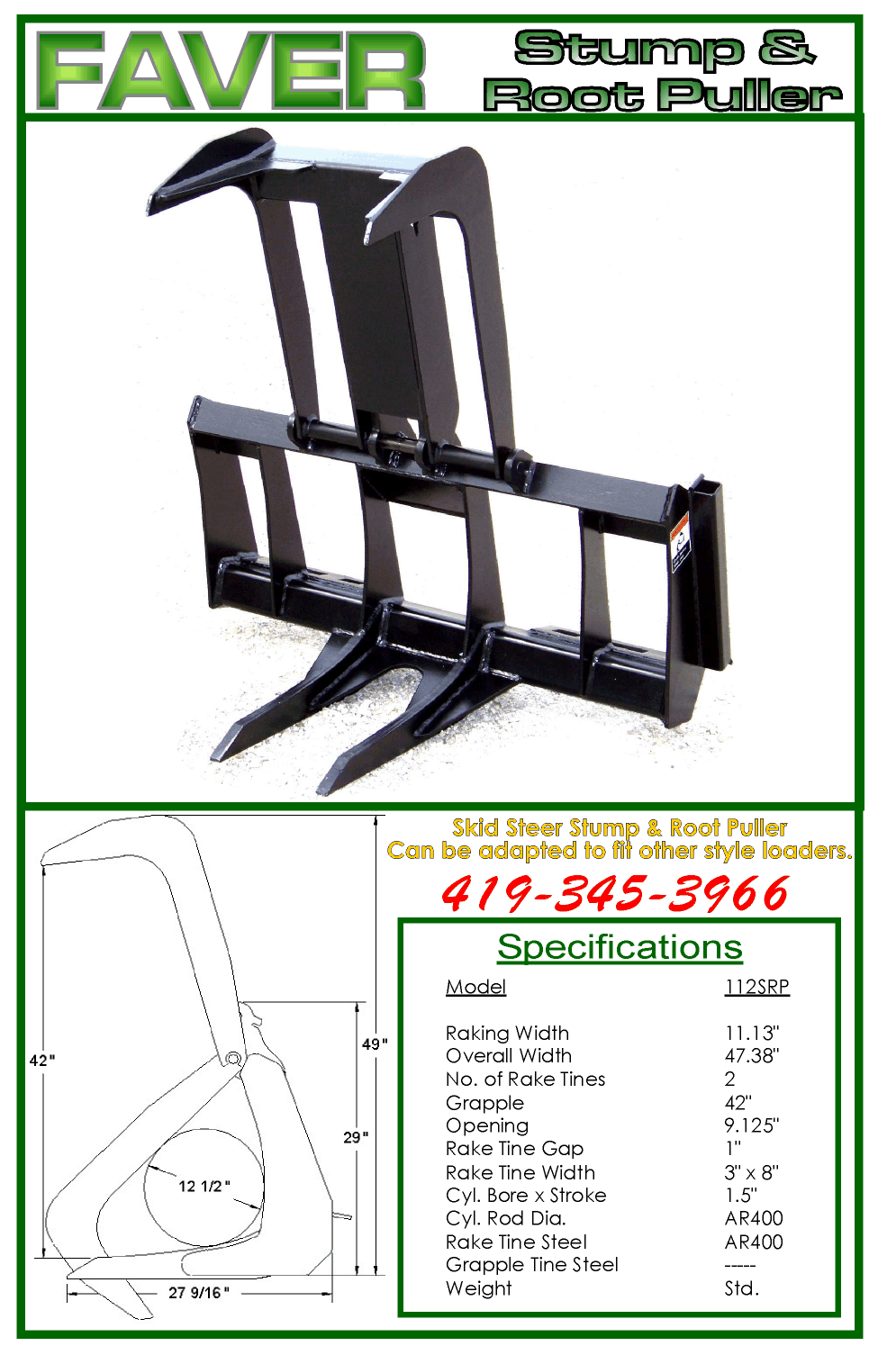

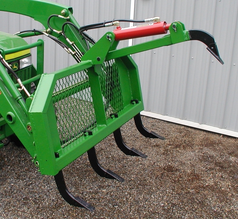

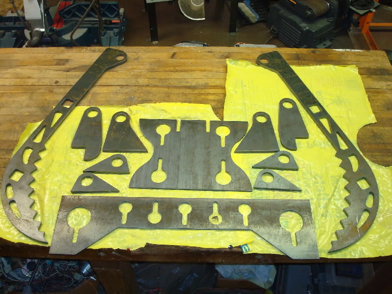

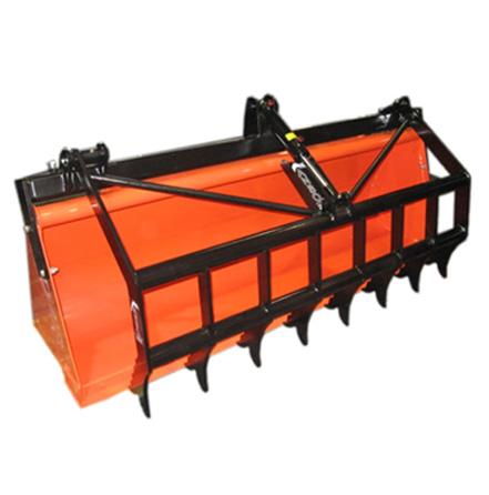

ScoopCzar,
About the grapple. There are simple grapples, and two tine grapple and full bucket grapples.
If you have any welding skills, you can make a grapple for your bucket. If not, you can purchase one to fit from paces like Ebay, etc.
Black grapple and red cyl is one I made from box blade shanks, and there are some more examples of other grapples. .
