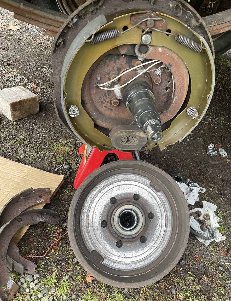

My flatbed trailer has two brakes unable to skid their tires.
New shoes and a new seal.
Bearings were absolutely perfect.
I changed the seal just because it had a tiny 'flat' on the sealing ridge.
The adjuster screw was real nice too, but stuck solid.
I freed up the adjuster and put anti-seize on the threads and inside its sleeve.
OK so on to adjusting these brakes.
Is it same as a vehicle?
I'm thinking that I tighten the adjuster good and tight, then back off until the drum spins free.
How free? Should it have some friction with the new shoes?
I like to adjust them until I can hear it touch but no real drag. I’m afraid it would overheat to go any tighter.

You can see in the pics there is no self-adjusting mechanism on these brakes.
I set them so the shoes touched, and decided to “drive it” a bit, and then “remember;)” to adjust again later to “touching” again.
Anyway it’s returned to service now, thanks for all the assistance!!

Can you back off the adjuster?
My thoughts too. The adjuster in the picture in above post, looks identical to the adjusters on European surge brake systems from Alko and Knott..
If theres a pry hole for a screw driver you can back it off, then pull it to the shop with the truck to grind the rust off by dragging the brake, so pulling the drum by hand becomes a lot easier.
