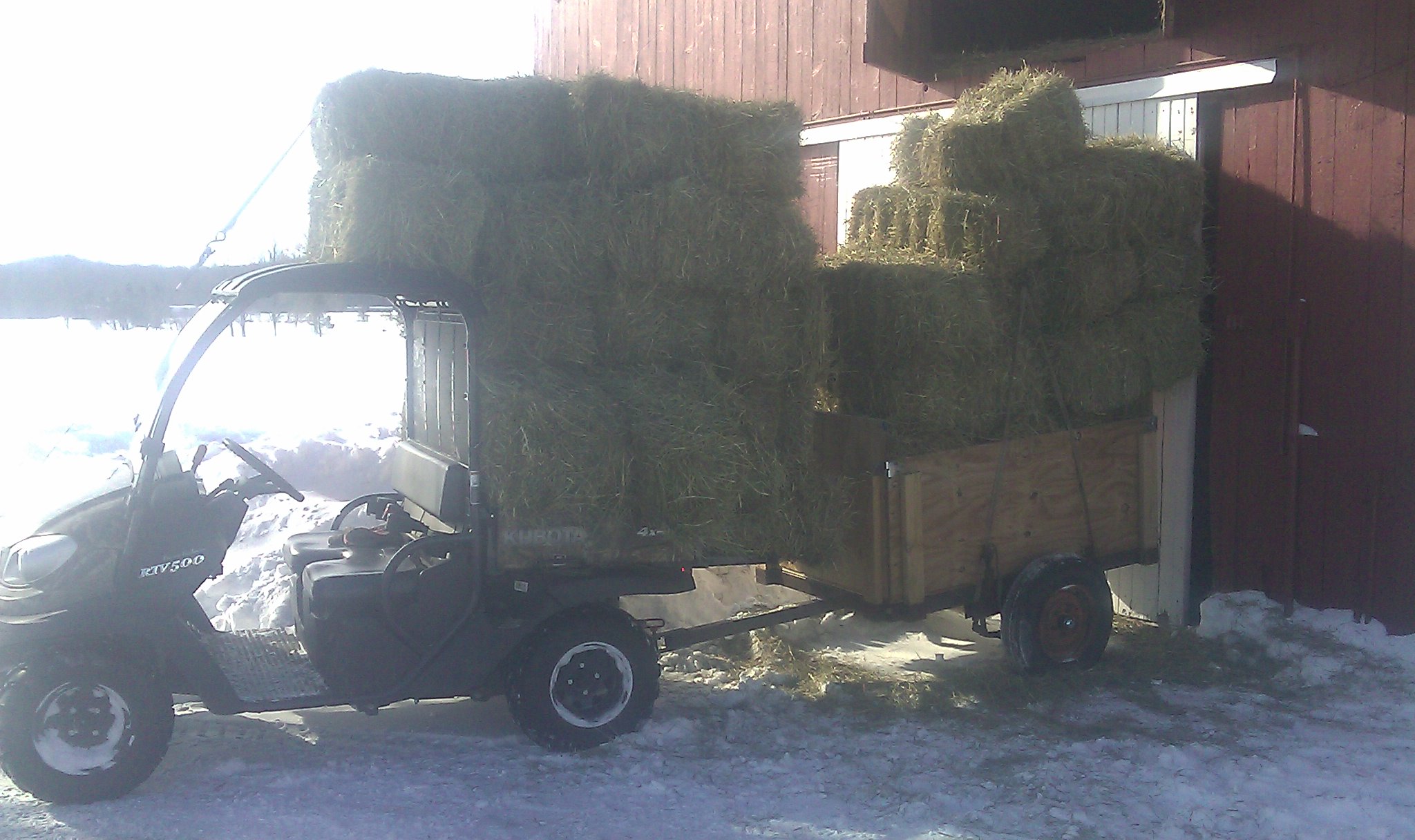

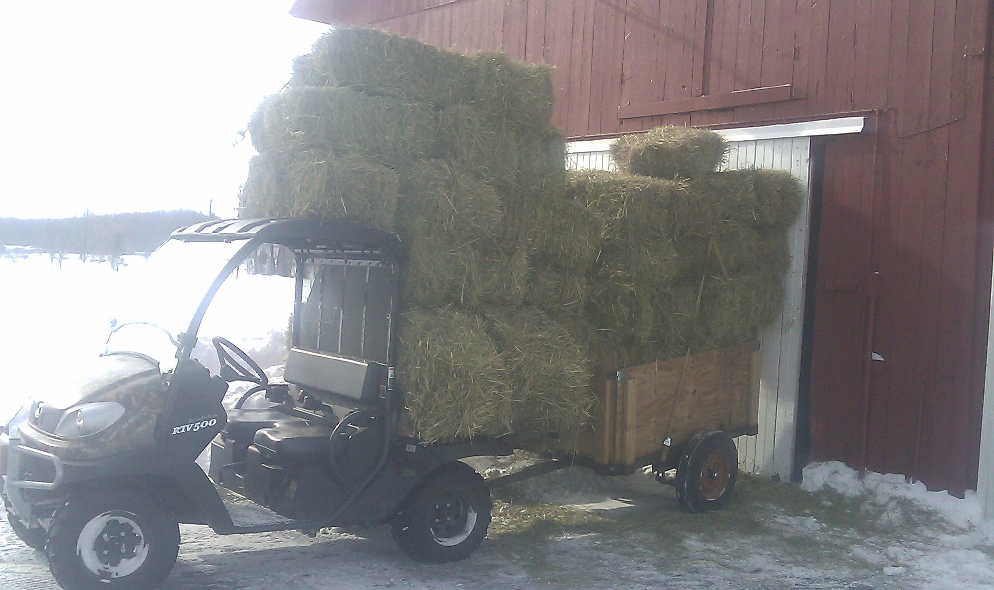

Finally got myself, the trailer, the neighbor and his welder (now a Miller 211) in the same place at the same time to put a new tongue on the trailer.
We cut the old one off in two pieces with a torch and built a new one from 3"x3" 3/16" square tubing.
The next morning, we loaded the trailer with 18-20 bales of hay and put another 18-20 bales on the RTV to get hay down to the barn for the animals. Worked well.
