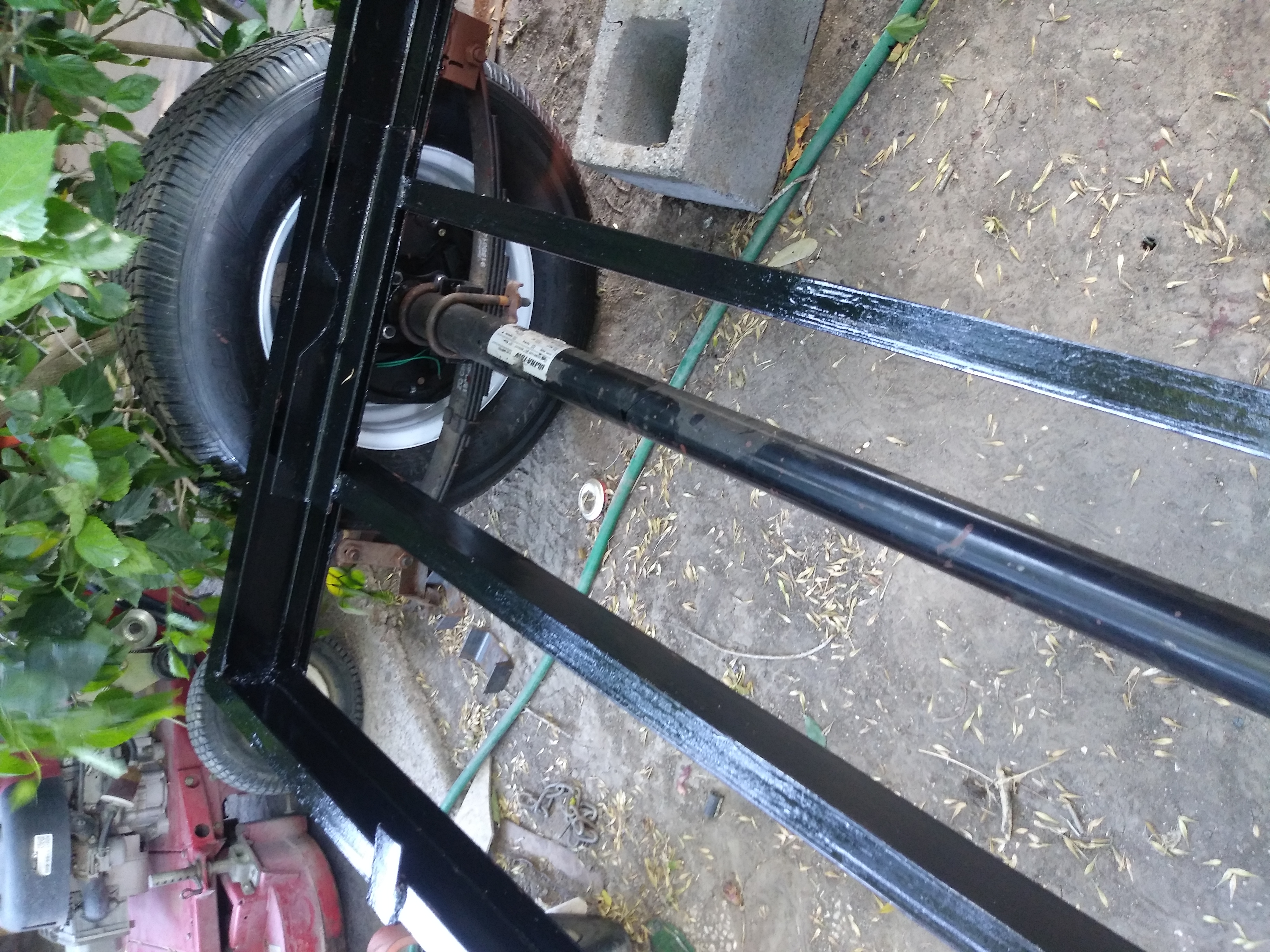

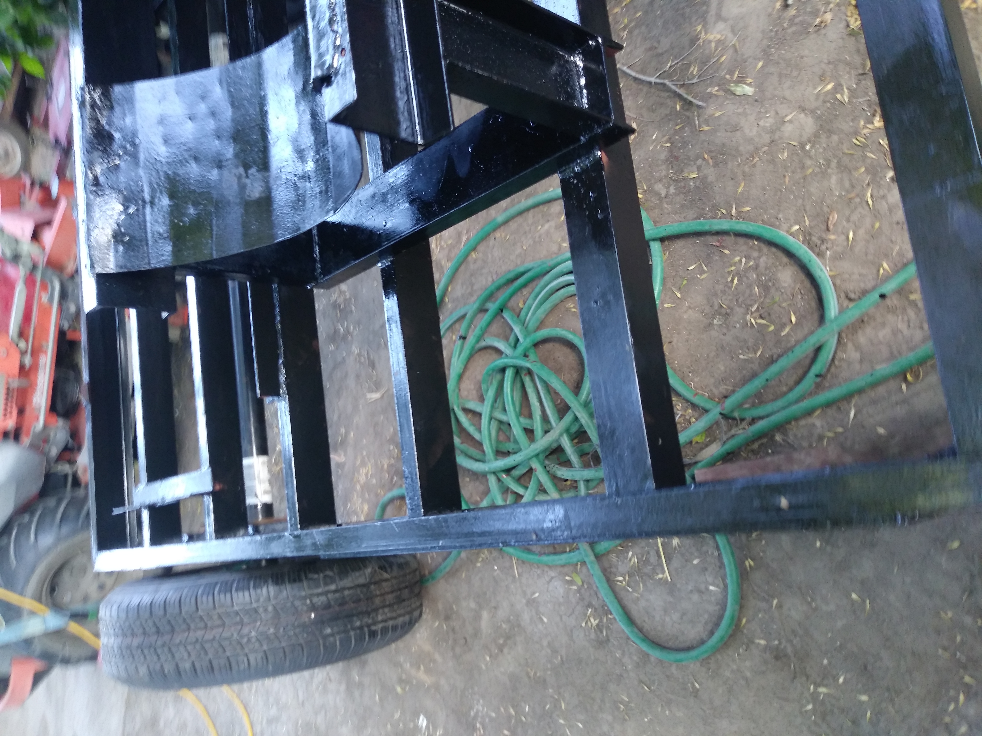

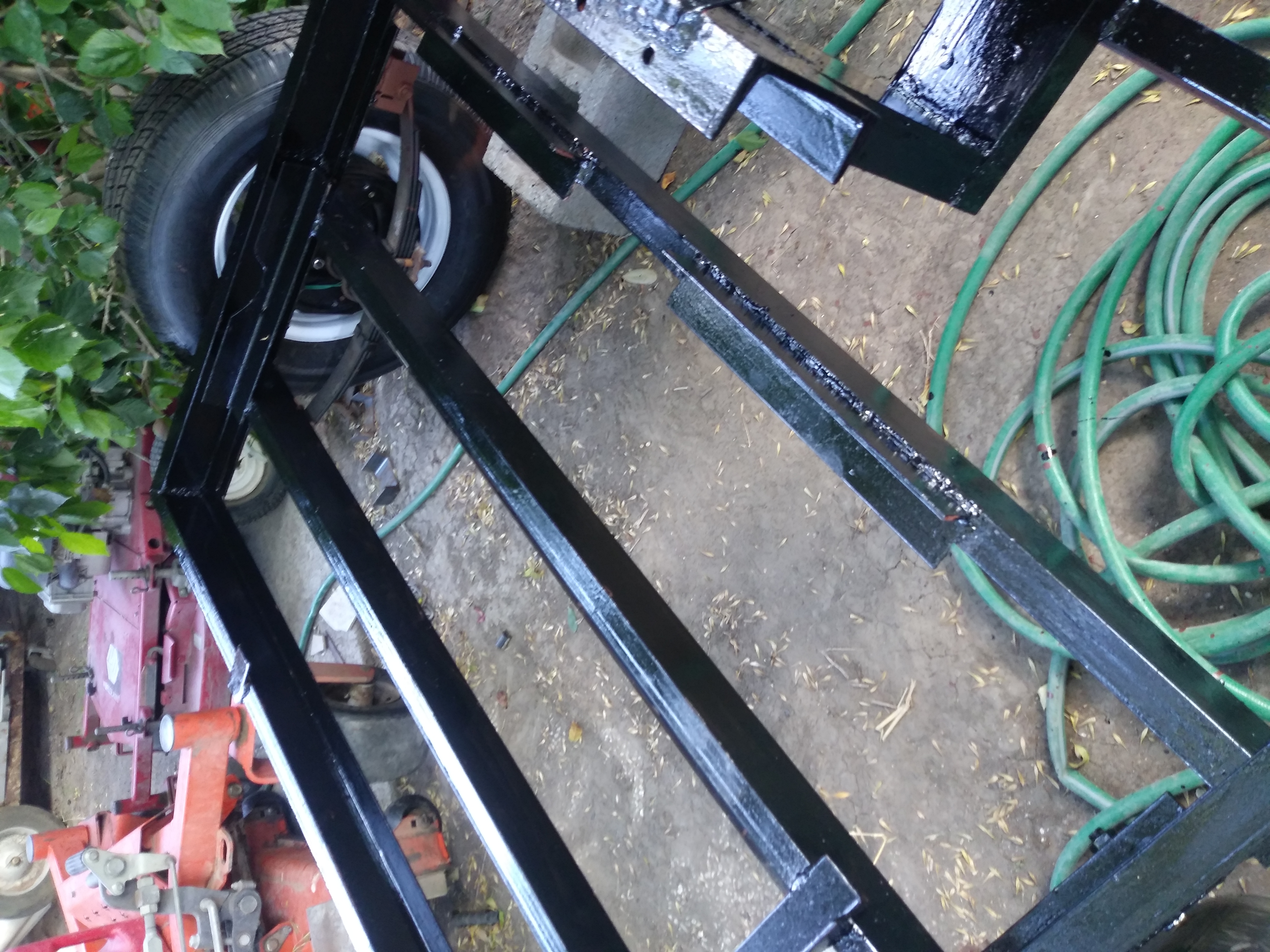

These are the hooks thay prevent the tote from tipping over
/ Trailer build
#12
The hooks work together with these angle irons. To free the tote all i need to do is lift the front and pull to unhook.

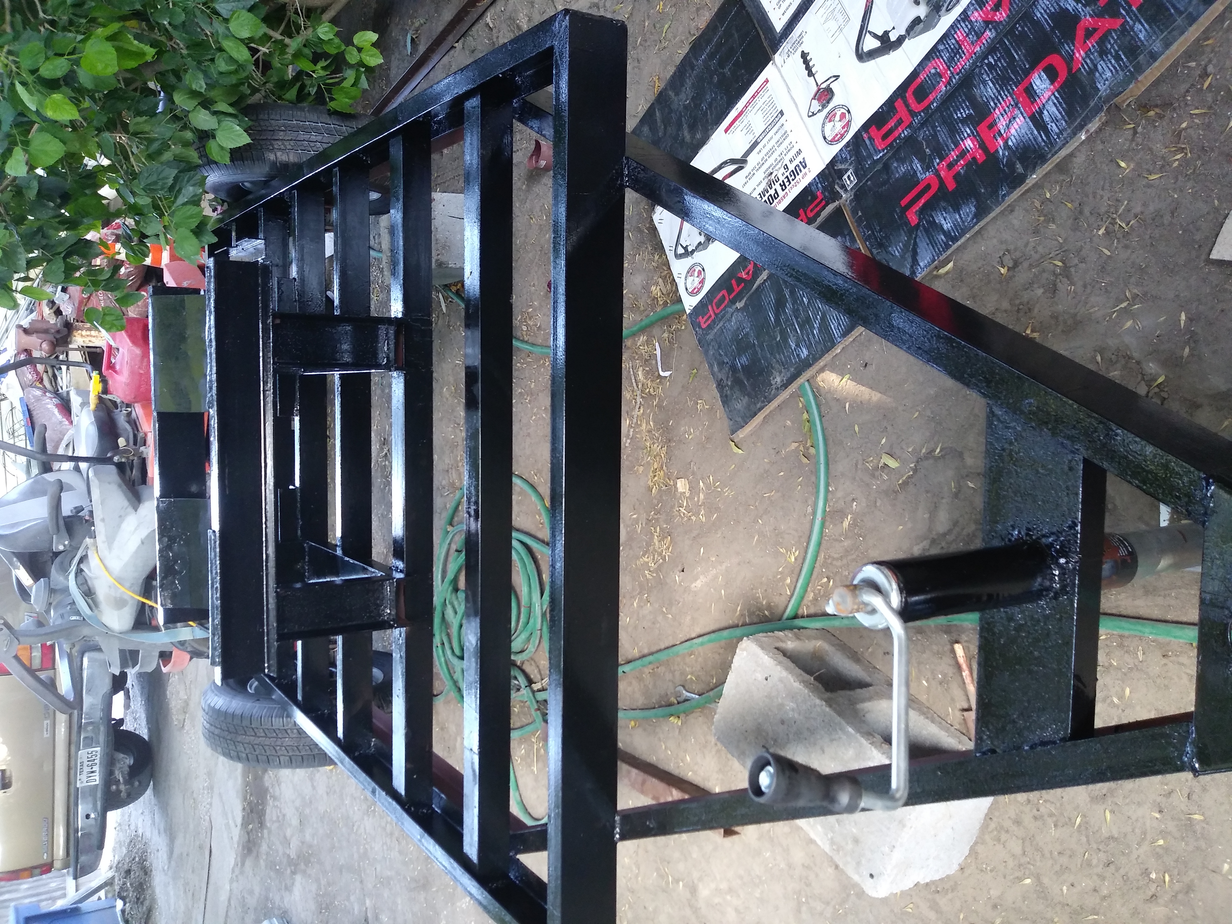

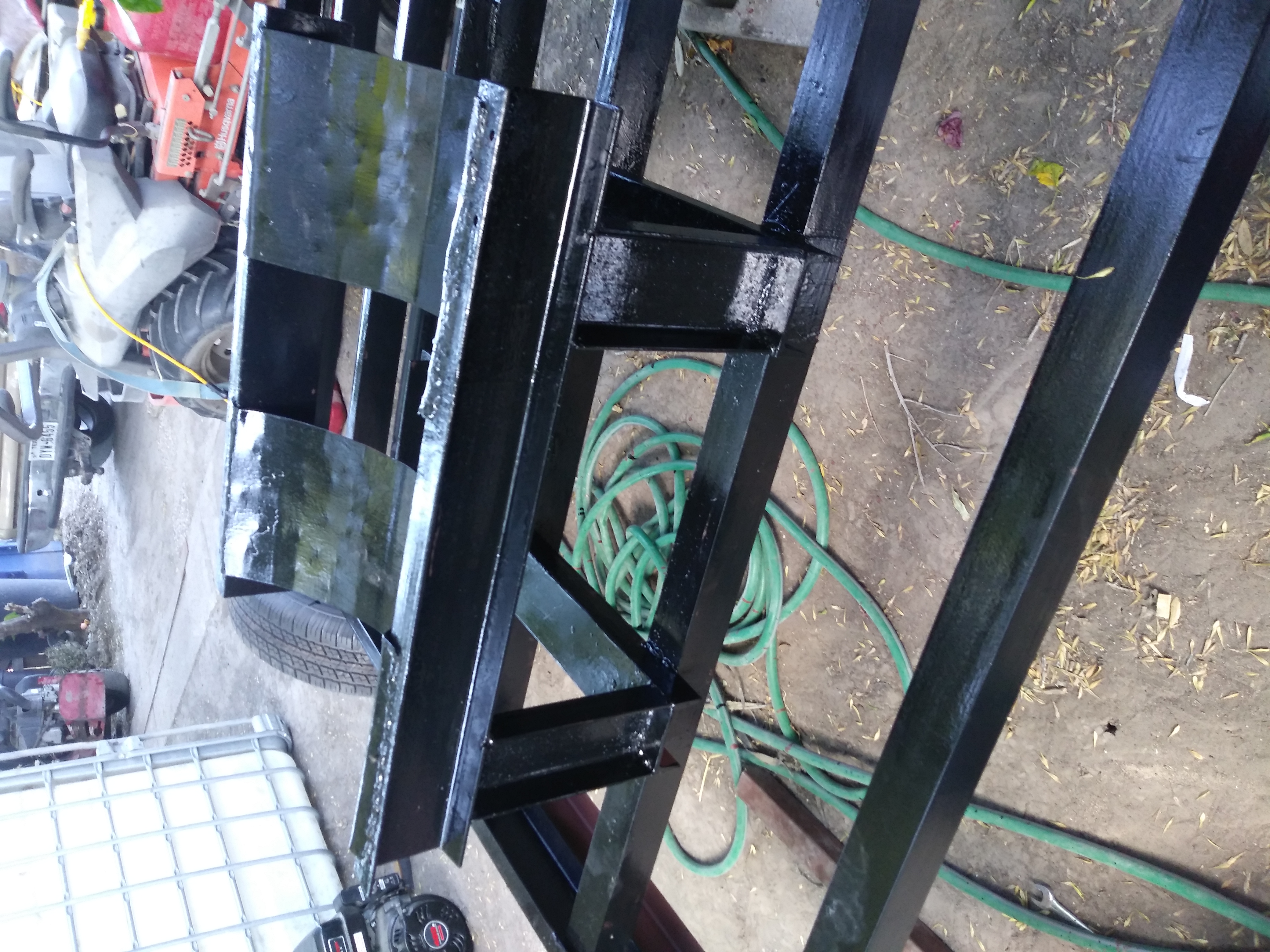

This is the cradle for the tank
/ Trailer build #20

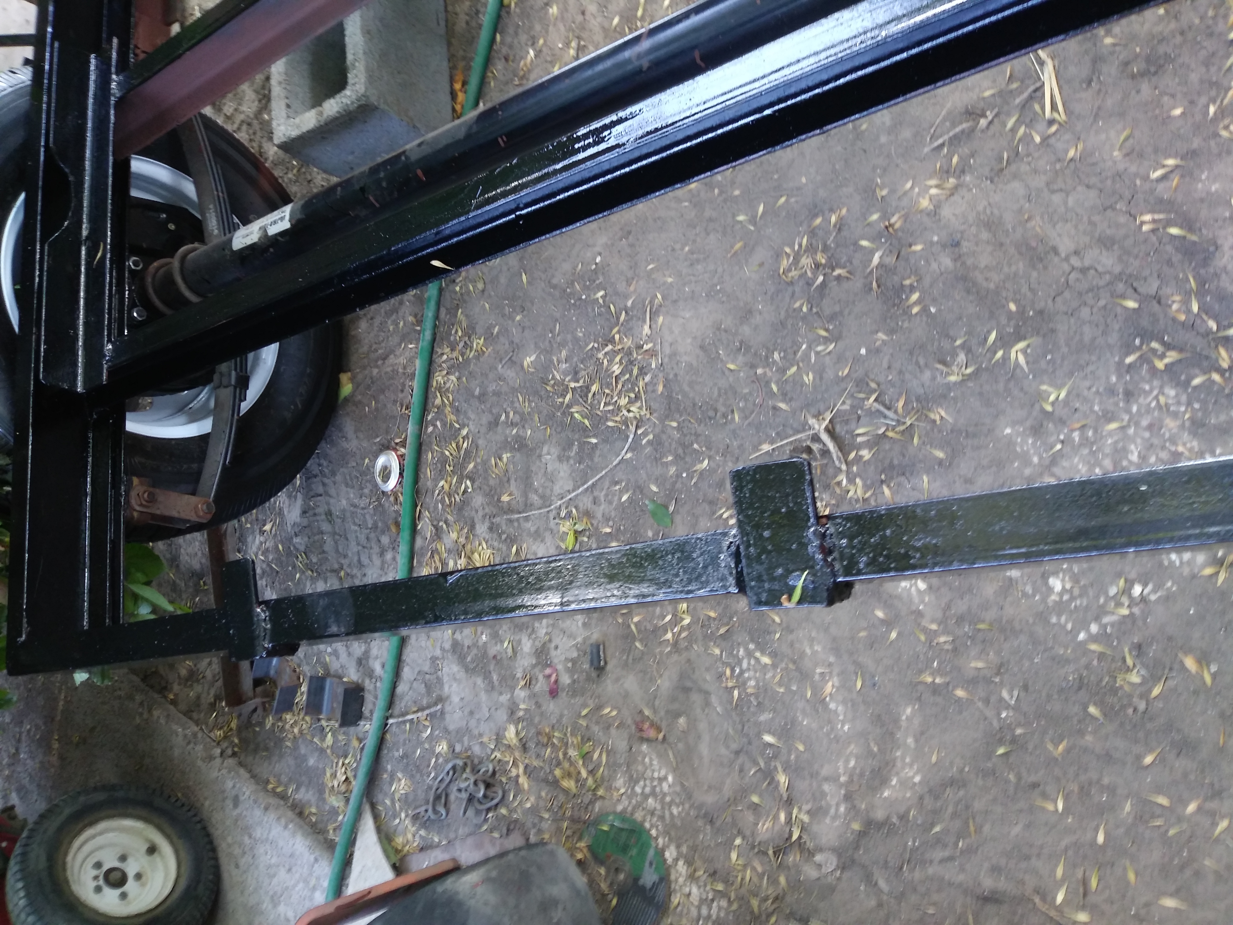

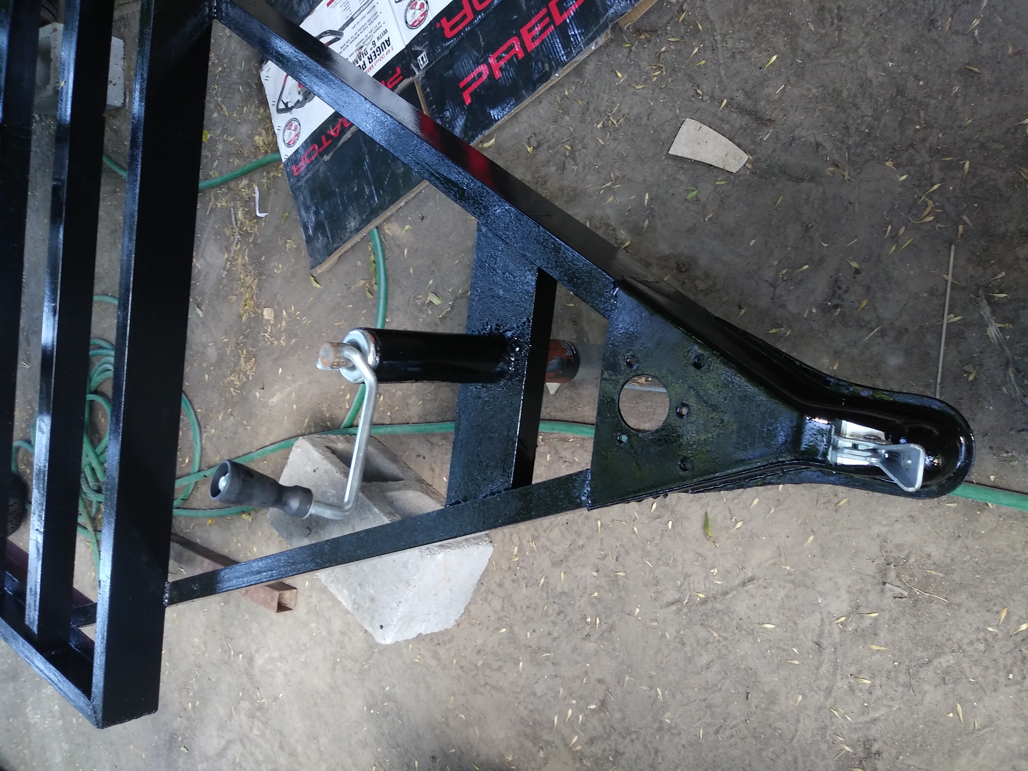

Nice job. I like how you ran the tongue all the way back under the frame and along it for a while. That adds alot of strength.
I built/rebuilt a 6.5x12ft with a 3500lb axle and ran the tongue all the way to the front spring hanger. I did this so i could make that rail removable. Its about half done in that pic.
