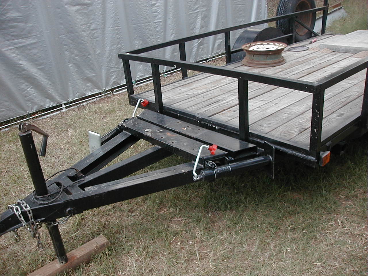

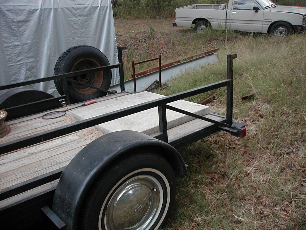

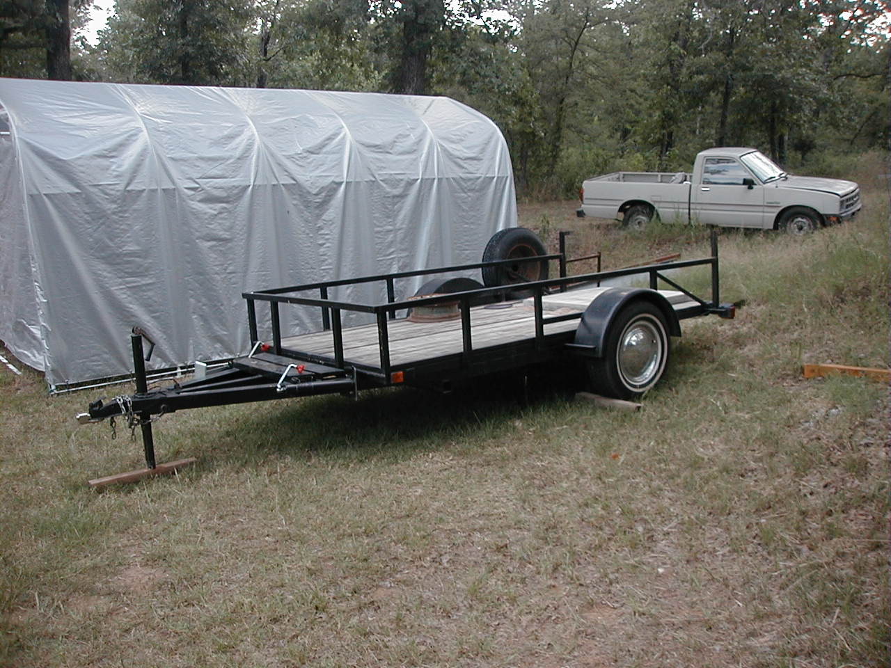

Here's a trailer I built about 10 years ago. It's a 5x10 with a 3500 lb axle. I have used it for just about everything from hauling my YM1900 down the highway to hauling rocks and cut up trees. I built it using square tubing. It won't flex from corner to corner like most will that are built out of channel or angle iron. I would recommend using square or rectangular tubing and gauge the wall thickness based on the weight you want to carry. If you are going with a 5x10 with a 7,000lb capacity, I would use tandem axles especially if you plan on dragging it around in the woods. They distribute the weight over a greater area of the frame. I've built a few other trailers and I have found especially on single axles, that it will tow best with the axle at 60 to 65% of the trailer length (not including the tongue). I also built a small 1 ton capacity jib crane that mounts on the tongue on the two channel pieces for picking up really heavy rocks and stumps. I set the outriggers and the two adjustable RV jacks and the trailer is really stable. The concrete slab you see on the rear of the trailer is 280lbs. I hauled 8 of these 75 miles down the freeway at 75mph and didn't break any of them due to the trailer not flexing. Everyone said they would be broke by the time I got home.
