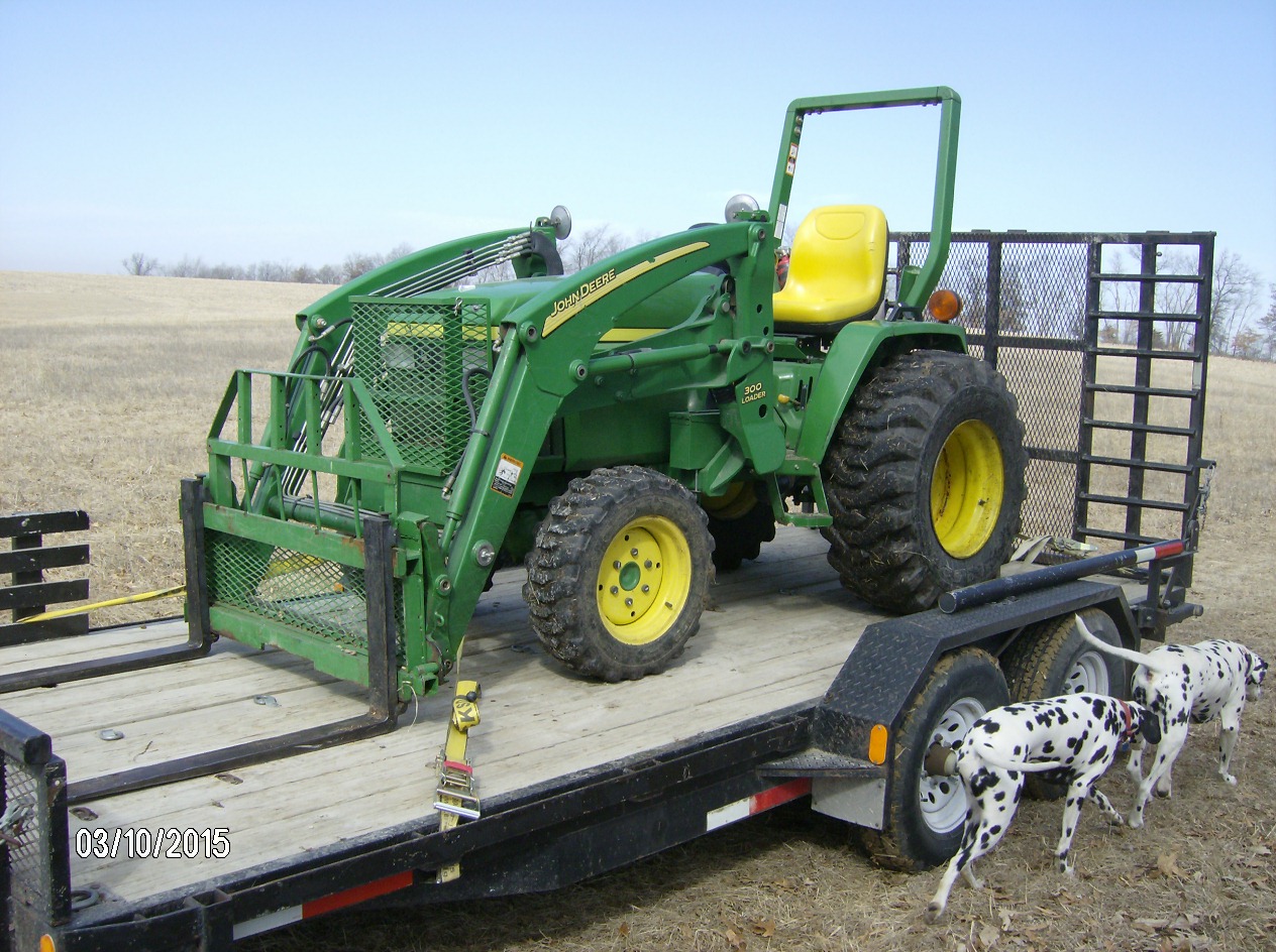

I use an 18' Maxey steel deck with a 4' dove. The 4' dove is essential, if you want to haul a small car. On the tongue, I have a toolbox with a Warn 9K winch, a dump truck battery, and all the cables/tie downs/chains, etc. It's been fantastic. It is a tandem axle, but only has brakes on one. I'ts rated at 7k lbs, but weighs around 2,250 lbs, with the toolbox. The Warn winch weighs around 100 lbs, by itself.
We upgraded all the lights to LED, which is nice. I also upgraded the coupler to a 2 5/16 by Bulldog.
I've had several vehicles on it and it pulls, like a champ.
Go bigger than you think you'll need. There have been several times when a 20-22' would be nice, not very many where I wished it was shorter. It would be nice to have brakes on both axles, but I've never felt they were incapable of what I was hauling.

I use a 20 ft flatbed that is 81 inches between fenders, two 5200 lb axles with brakes on both. This trailer handles my L3901 with front end loader and five foot brush cutter easily. There is enough room for the attachments to be flat on the deck for tie down purposes. I used the trailer to haul an Escalade 300 miles, no issues. I have also hauled 4 pallets of fresh sod on it many times.
I also own a 7' x 14' dump trailer. I can haul the L3901 with the front loader but no rear implements. It came with 6 foot heavy duty steel ramps. I have switched to 5 foot aluminum ramps because of the weight issue. The aluminum ramps are rated at 10,000 lbs so no issues loading the tractor. While the dump angle is quite steep, the tail is so low to the ground that material can sometimes be tough to get out. This trailer tail gate opens like barn doors or the bottom of the tail gate swings open like a regular dump truck. Love this feature. This is a 14.4K GVW trailer with a payload of 9,200 lbs. It came equipped with a spare tire and a roll up cover. Load Trail.
I had two shorter flatbed trailers for the tractor before the 20 footer. Consider the extra length to be a real asset. I switch trailers at least once a day. I consider my gooseneck trailers with a king pin to be very time saving and easy to hook up when switching trailers as often as I do. May not be for you, but I love it.

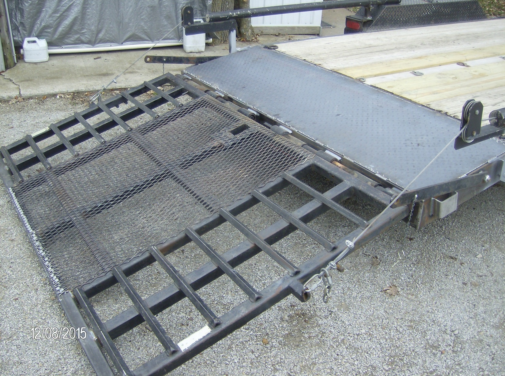

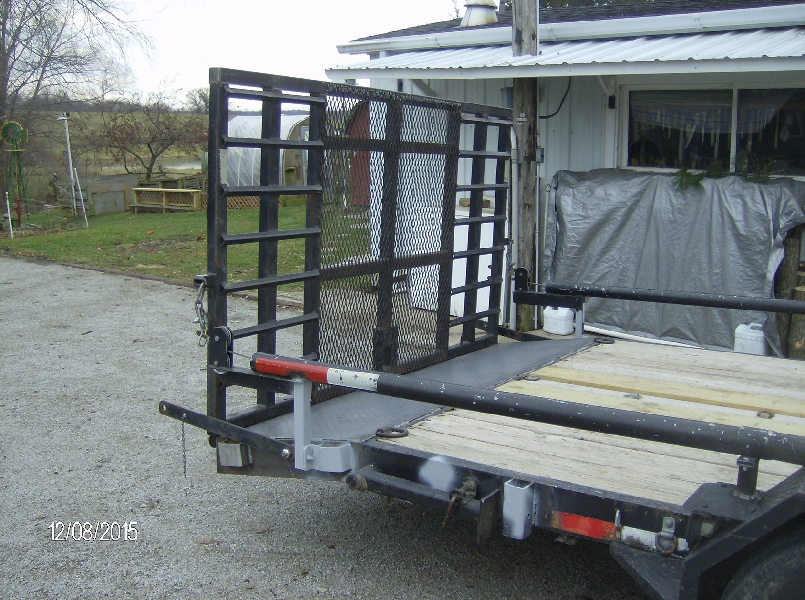

My 16' Woodworth (a local company), started out with 3500 lb axles & 5' slide-in ramps. When I brought Dad's JD 720D home, I had the builder change the axles, springs, etc. to 6,000 lb. After cancer treatments, the ramps got too heavy, so I took it back to the builder for a 5' ramp-gate: HPIM3291.JPG
When I bought the newer 5" Woods finish mower, I needed a little more room for balance. So I took the 19 year old trailer back to the builder again for some routine maintenance & to add a 2' dovetail and cut the 5' gate down accordingly: Pictures 2015 002 (7) - Copy.JPG Pictures 2015 001 (9) - Copy.JPG

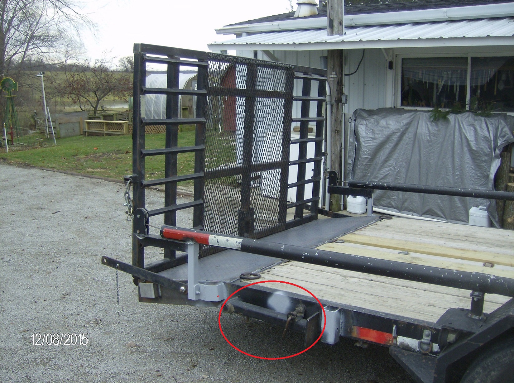

I'd definitely go an 18', for a BX25. The angle makes it kind of hard to tell, but on mine, there is room, but more wouldn't hurt. It fits about perfectly, until you want to add something else.
Here's another picture, taken the same day. The angle is very similar, but you might get something from it.
