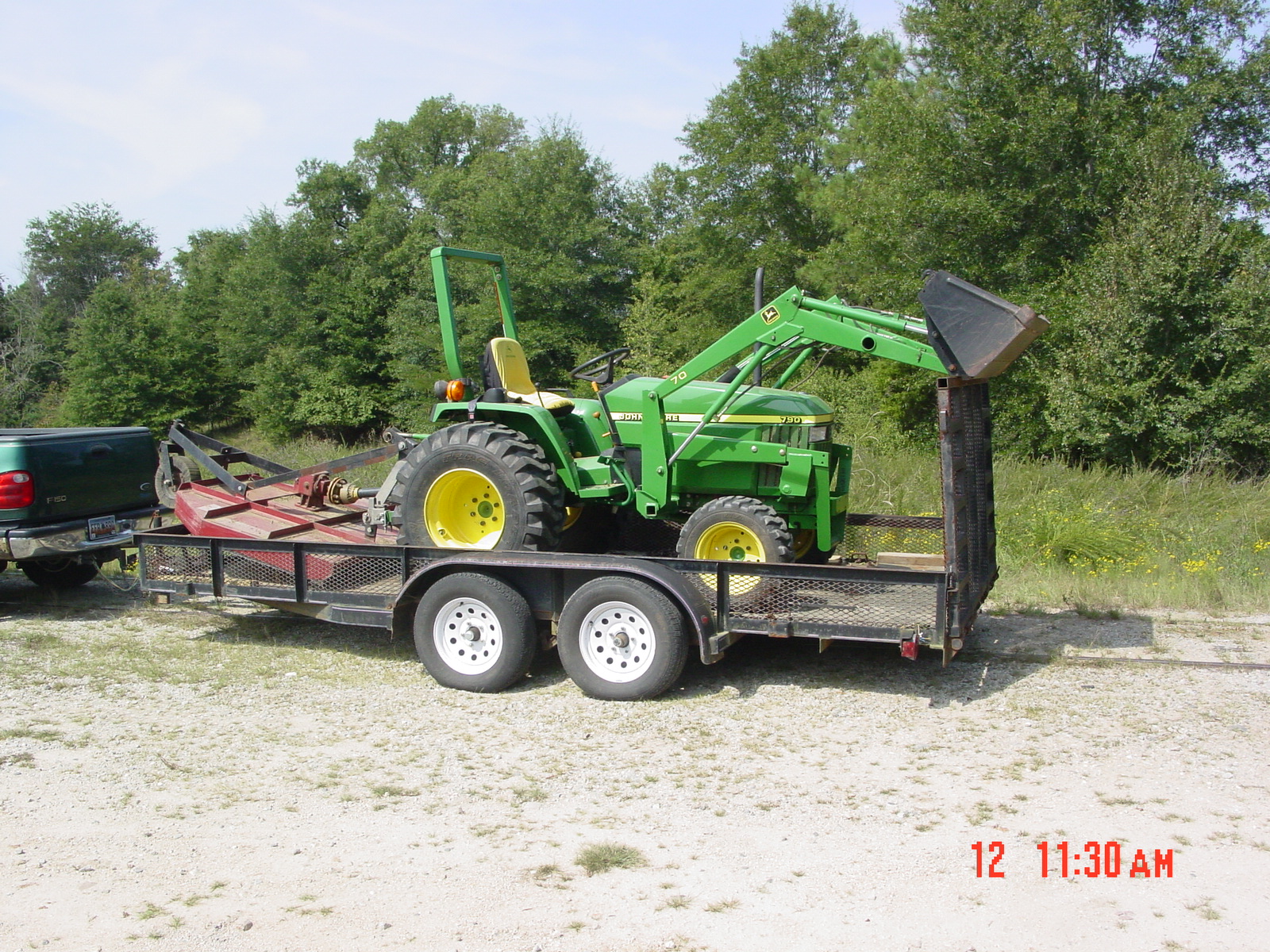

I think he'll need at least 18ft, My 790 with loader and 5ft bush hog attached is just too long to sit on a 16ft deck. I have to let 2ft hang off one end or the other, or some of both. Usually I back it on with the bush hog raised and get the heaviest part of the tractor over both axles. Then drop the BH onto the front rail (my trailer has 12" sides). Once I raise up the 4ft drive on rampgate, I lower the bucket onto the top of the ramp. Ugly but it works. I keep saying that one day I will sell this 16ft trailer and get me an 18ft, or possibly a 20ft trailer. See the pic I added (that's not my current pickup truck though).

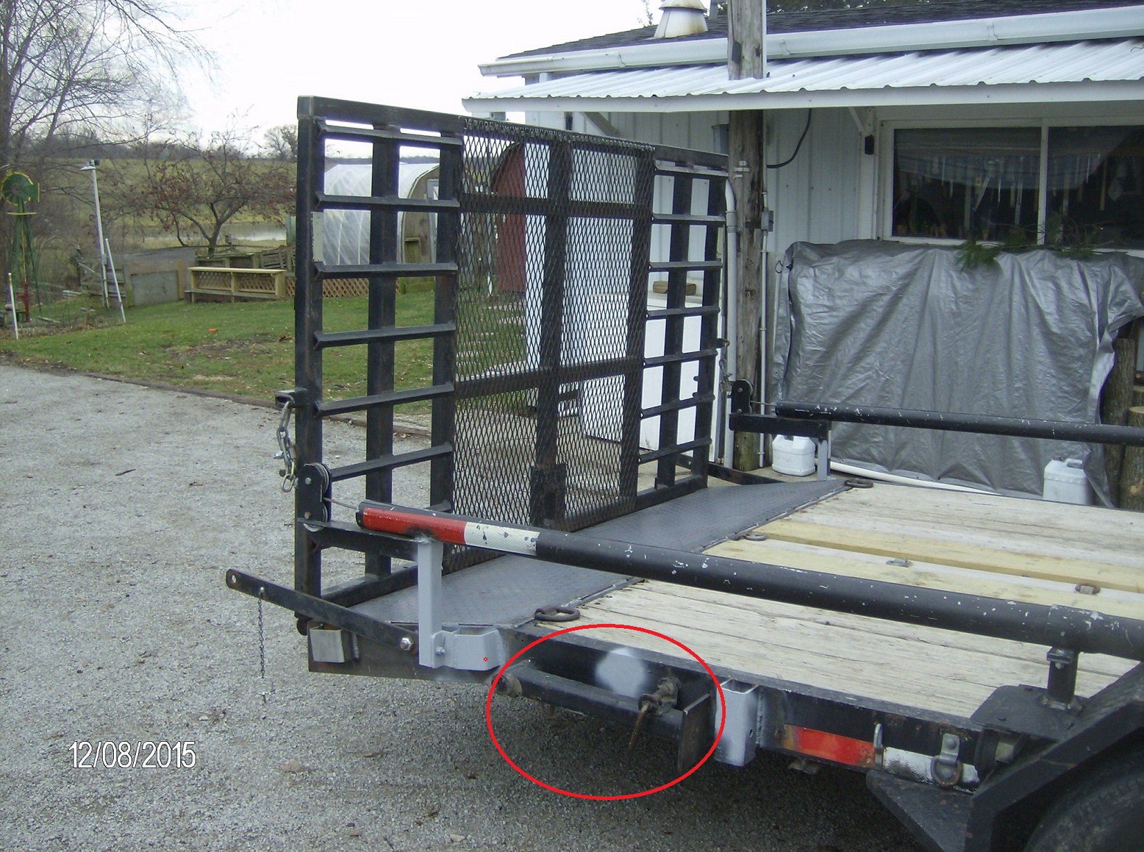

Loading legs will take care of the lift problem: Pictures 2015 001 (9) - Copy.JPG When in the down position, they're an inch or so off the ground. When loaded, just back up a little & swing them up!
   / Trailer Features - What To Look For #27
Loading legs will take care of the lift problem: View attachment 456821 When in the down position, they're an inch or so off the ground. When loaded, just back up a little & swing them up!
The trailers that are built with two ( individual wheel ) fold up ramps usually have a leg assembly welded across the bottom of each wheel ramp, for tail end trailer support while loading/unloading.
Lift assist springs (beefy coil type springs) are often also used on each wheel ramp to assist with weight, when raising/lowering the ramps for travel, or storage.
