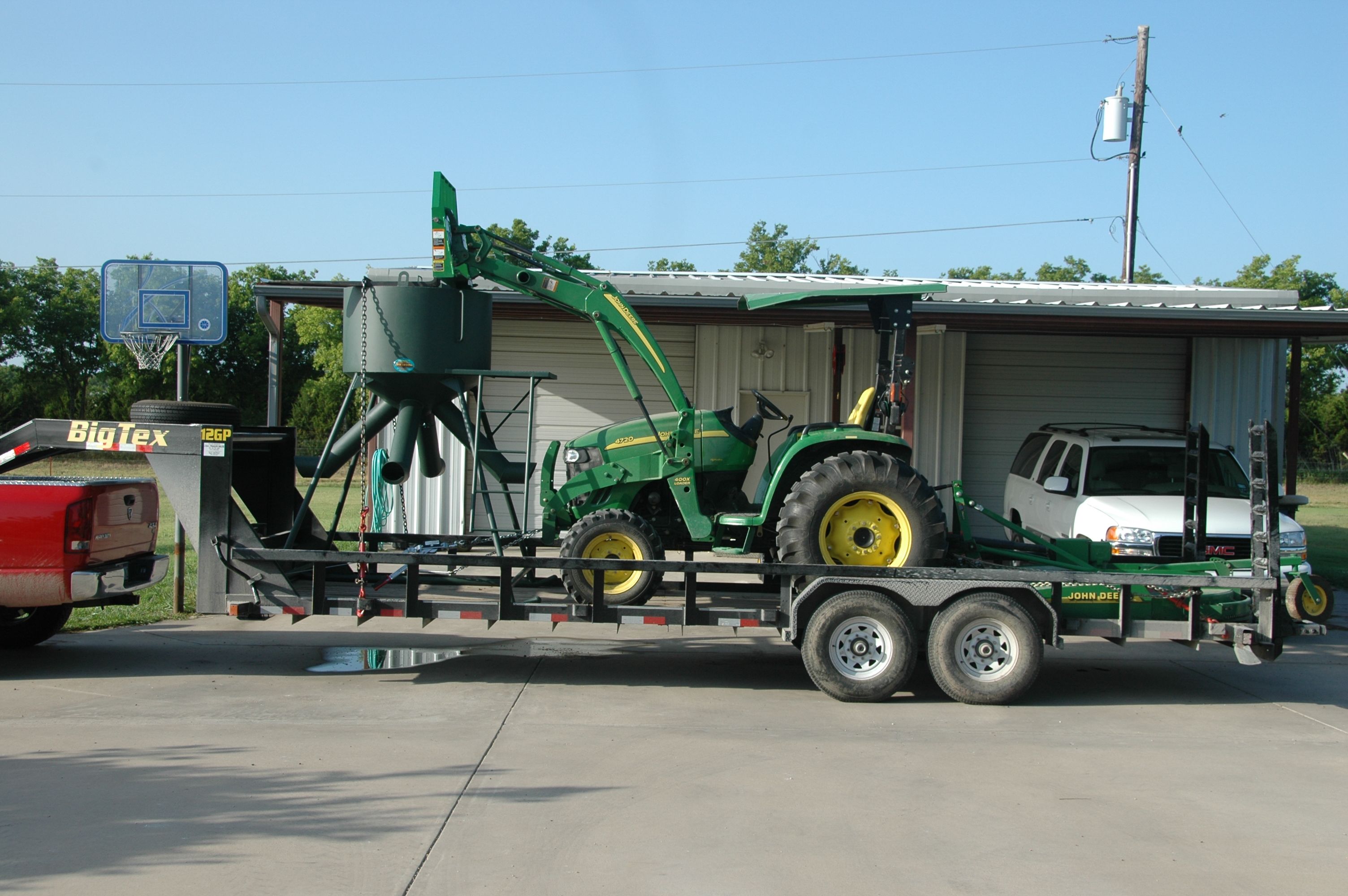

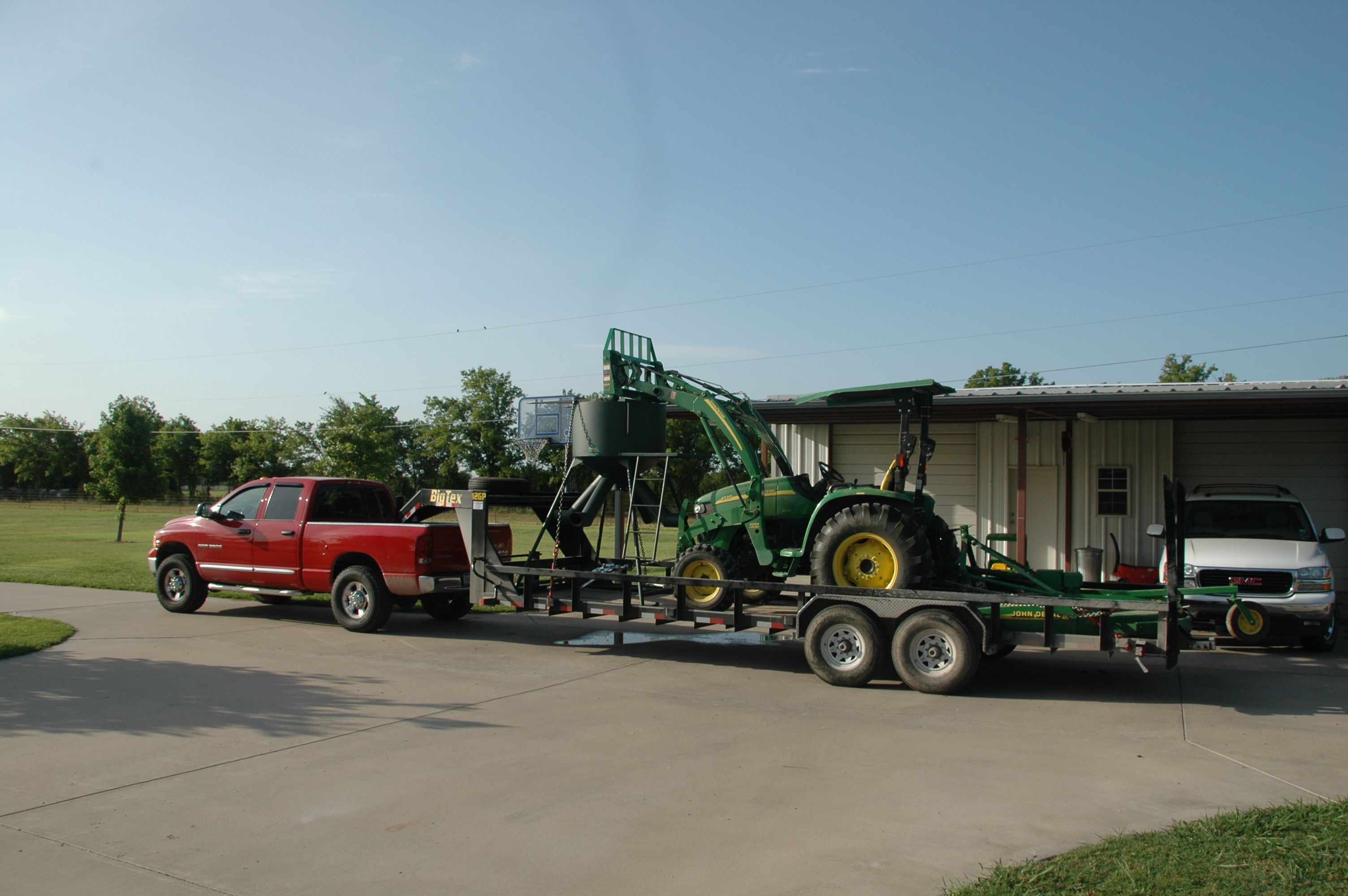

Cool deal. I have the Big Tex 12GP. I wanted the 14GP, but I could not wait for it to come in. It has been a good trailer. I have have it 3 yrs or so. I bought it when I got my 4720 tractor. I used it a lot.
D.
   / Trailer for a 4120 #25
