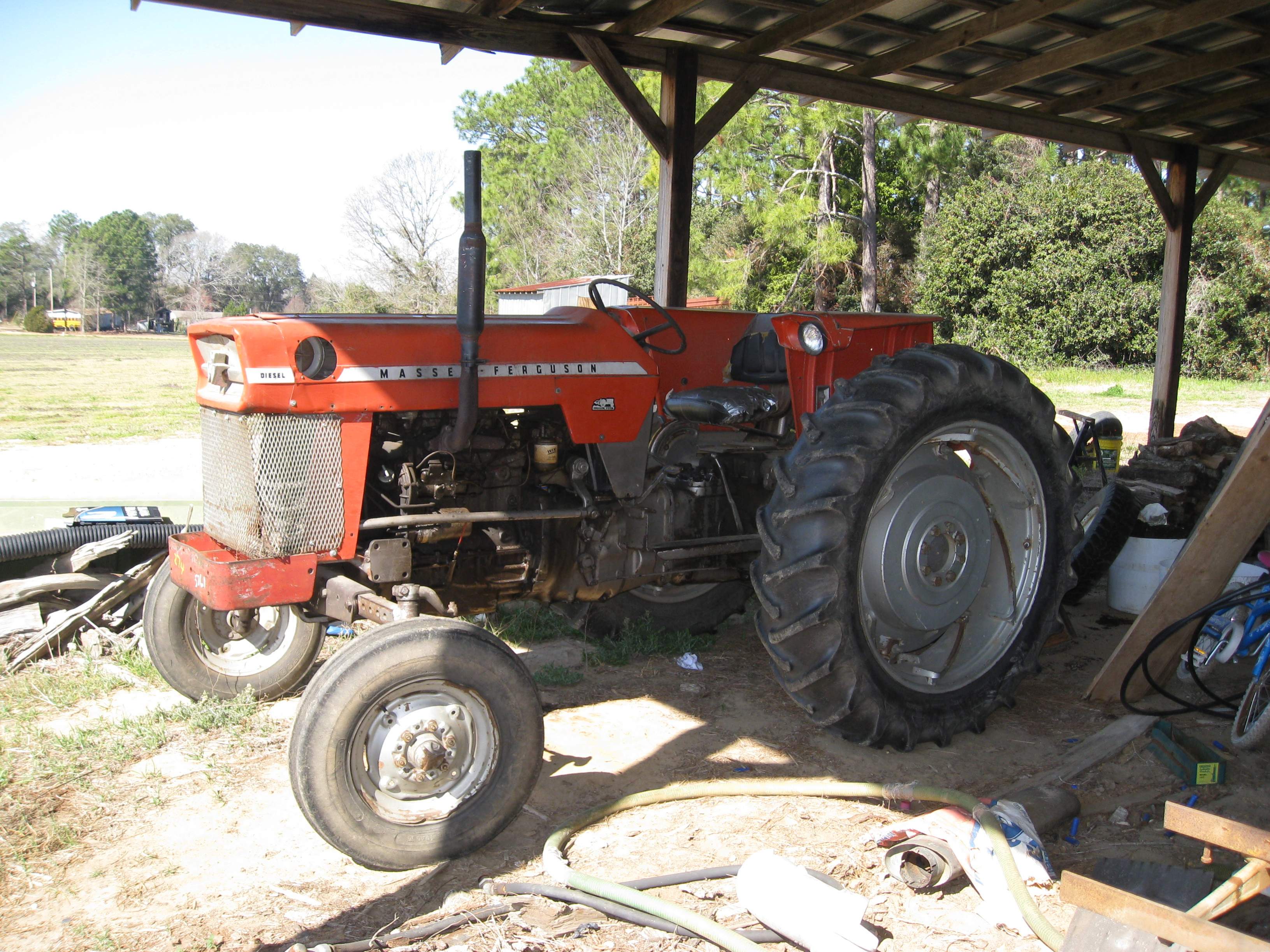

I just wanted to upload a pic of my new tractor I have yet to see in person...
