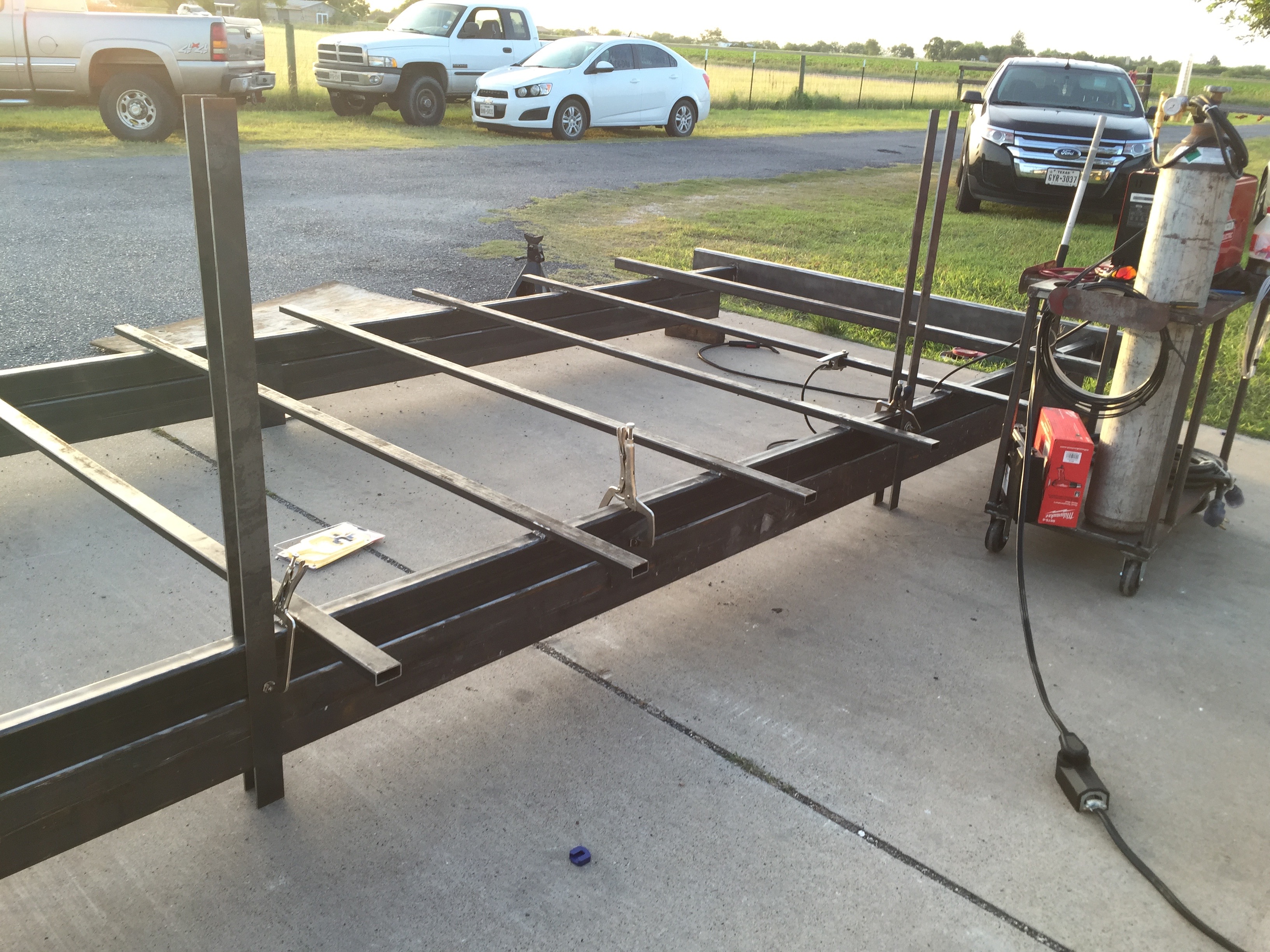

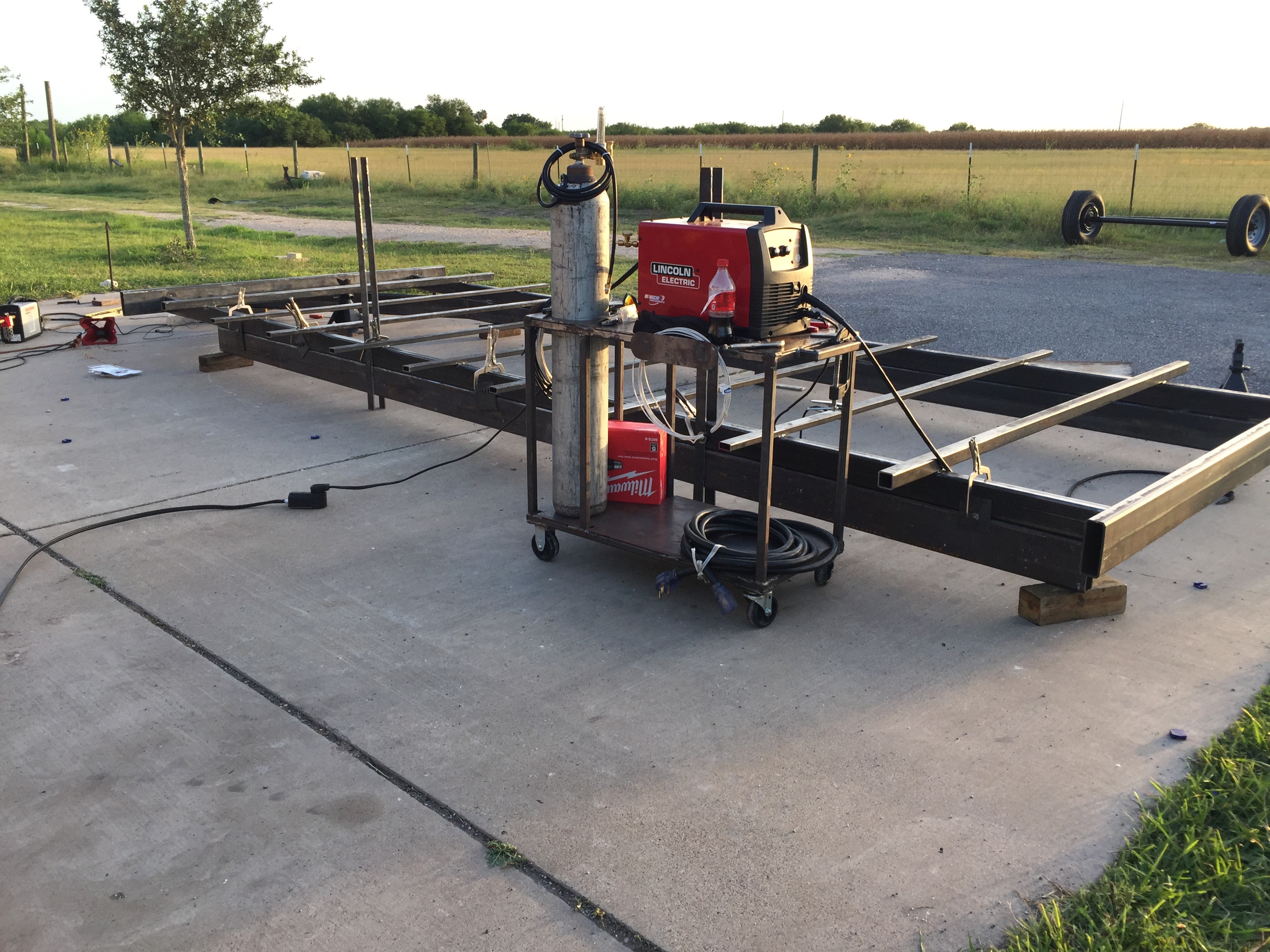

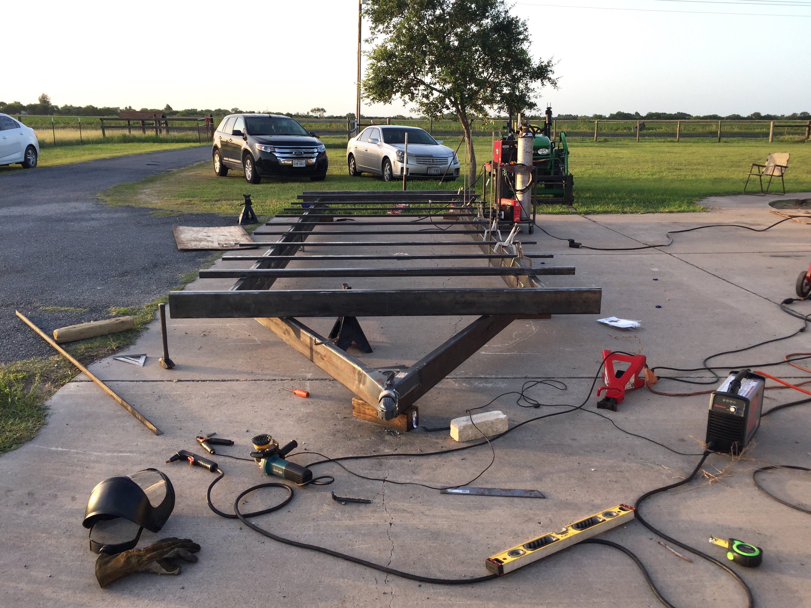

Convinced my wife it would be cheaper to just build a trailer than buy one. Decided to build an 8x20 foot trailer. Comparable trailers costs around $4,700 (Big Tex brand) at local dealer. After buying the steel, axles, tires, and everything I needed, the savings wasn't what I expected. Since steel pieces come in 24' lengths, decided to build a 20'+4' dovetail to be more cost effective. I've built a couple of much smaller projects. This is the first big project I've attempted so far.

It looks like you are on the way with a good game plan. From looking at the pictures though, are the cross pieces big enough? It looks like 1x2 tube and from the way I over load trailers I would think they are a little small, or not?
I don't want to pick on your job but it seems like for a heavy trailer like that they at least should be on edge for more load capability. Looks very nice though and good weld.
