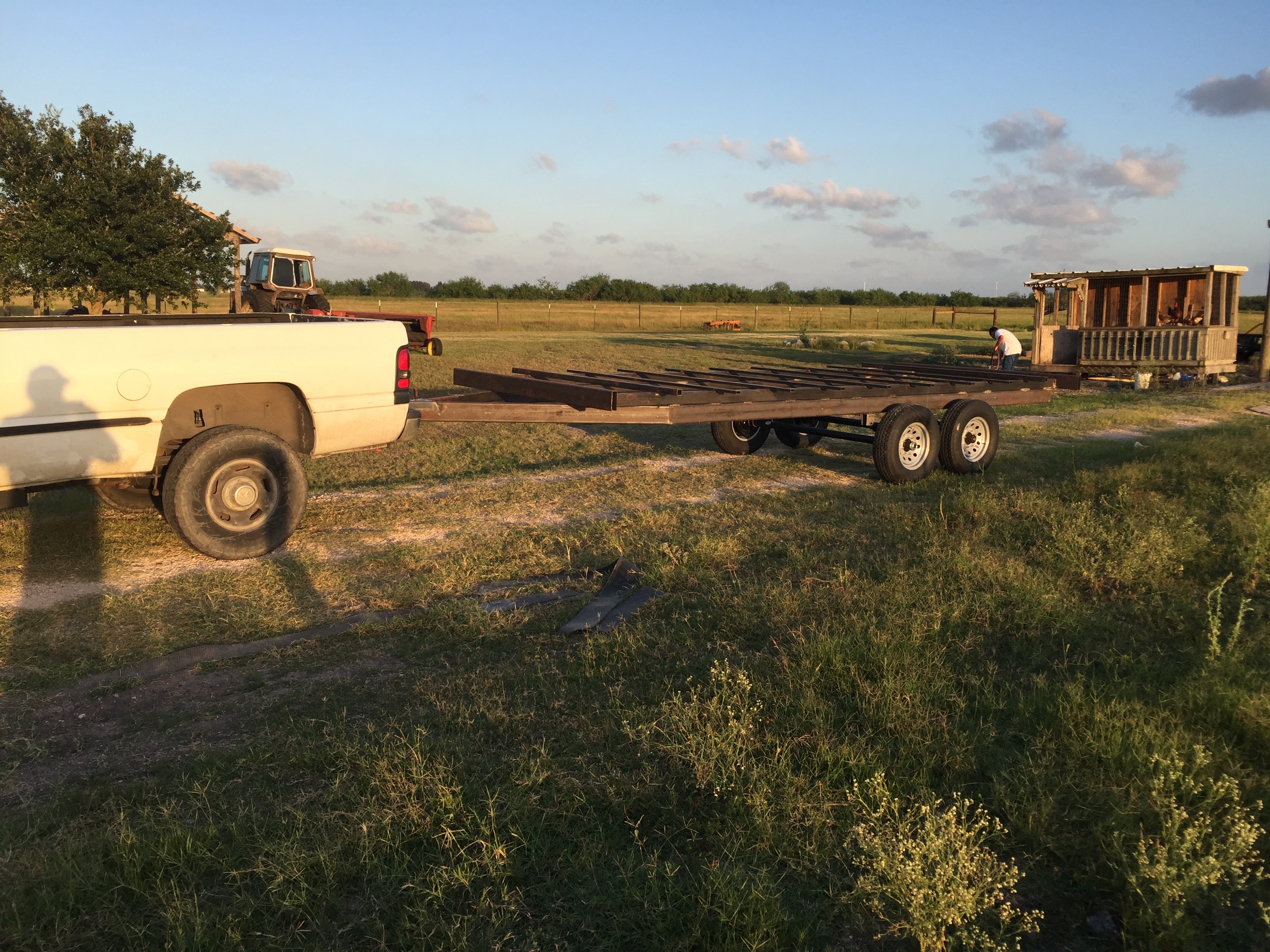

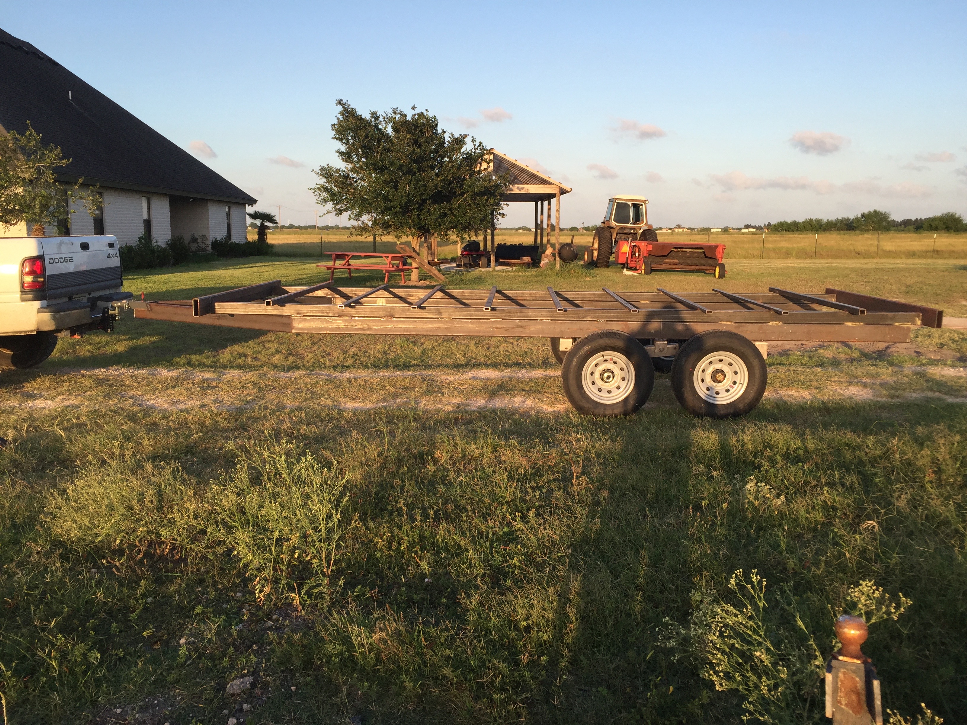

... From looking at the pictures though, are the cross pieces big enough? It looks like 1x2 tube and from the way I over load trailers I would think they are a little small, or not?
I don't want to pick on your job but it seems like for a heavy trailer like that they at least should be on edge for more load capability. Looks very nice though and good weld.
You can pick all you want. I won't get offended, and I don't have a problem receiving criticism, If I did, i wouldn't have started a thread. Trust me, I always have room for learning. The crossmembers on the outside are 2x2x3/16, The outside 2ft. on both ends of trailer will be decked with diamond plate so I can weld some D-rings on the corners, The middle crossmembers are 1x2x10ga, This section will be decked with lumber.
The long edge of the deck is 2x4x3/16 resting on 2x6x3/16 which becomes the tongue. The axles are under the 2x6x3/16. The front and back face of deck are 2x6x3/16.
I'll only be hauling my JD2520 and whatever amount of hay the gross weight will allow. I anticipate the trailer weighing around 3k, so that leaves 9k of payload, Axles are 6k each with brakes on both. Tires are 16" rated E. The coupler is rated for 12,500 lbs (Bulldog brand)
I added the tires and had to give it a whirl. Needed to know if it was centered and how it would follow my truck. It trailered nicely. Drove a couple if miles down the road at 55 (Tx Farm Road) and back. Then went down some dirt roads and I couldn't be happier.
Thanks for all the comments folks.

The 1x2" tubing laid flat will be too weak, they should be at least 1 1/2 x 3" and be on edge. 2"x3" cross members would be better. The frame will be much stronger than the deck. I would fix this before continuing.

This was a concern of mine. I'm placing gussets under each crossmember to increase strength. The crossmembers are on 2' centers. I can add more crossmembers so they can be at 1' centers for the middle section.

I wanted to make the deck go over the tires. The cross members needed to be on top to go beyond the side rails and over the tires. I think I would have had fits trying to square all the crossmembers to the side rails. Just laying them on top is so simple to square away.
For the most part, I'm building this by myself. I had no idea the time it would take to complete. Just grinding the steel to get ready for welding is back-breaking and takes up most of the day. I did have some nephews help me out when I added the axles/tires. Unfortunately, they can only help me out every other weekend. I'm building the trailer at my cousin's place, but he doesn't help in the build, just provides electricity and the space, which is more help than I can ask for. I am very grateful for this. He's just too busy doing his own stuff.
