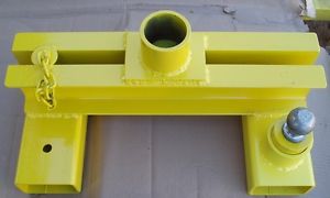

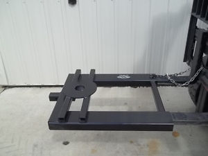

From your first post I am guessing that you have forks.
How about this idea for the 5th wheel trailer?
IMG_4280[3].jpg Receiver Hitch |
$T2eC16hHJIUFHG19(VvtBS(1US6VpQ~~60_35.JPG Forklift Tine Trailer Mover Moving Attachment 2" or 2 5 16" Ball GN or 5th Wheel | eBay
$T2eC16RHJIUFHHpjPsbnBR9s,qgUEg~~60_35.JPG New Receiver Hitch 5th Wheel Trailer Mover Forklift Attachment | eBay

xfaxman - thanks for the information. Unfortunately all these units put the lift point too far forward. As my loader has more lift capacity than my 3 point (loader at pins is 1600 lbs, 20" out is 1225lbs - 3 point at 24" behind pins - 1100 lbs) data from owners manual) I need to use the loader as close to the pins at possible.
I have been thinking of the Northern tool one more, even though it is a bit more expensive. With the cut out on the back plate, there is room of the 5er king pin housing to swivel as I turn it.
Any more thoughts on this - I want to make sure I get the correct unit for my needs.

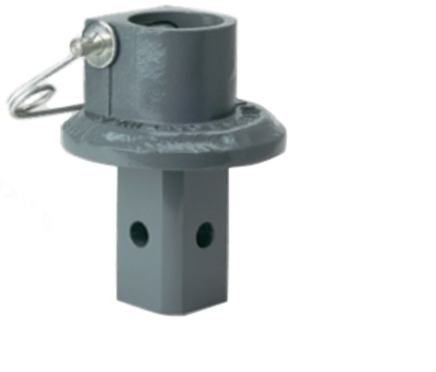

I was going to get a ball mount and get a cup welded up that I can bolt in, or just have it welded to the shank as close to the frame as possible. I might have a bearing plate as shown in one of the photos. I was thinking of a locking device, but I think the trailer weight will keep it solidly in place. Thoughts?
In all of my searches I cant find a receiver shank with the cup on it yet.
   / Trailer Hitch Receiver For Pallet Fork Frame #15
If you could get something like this and have it mounted to the top of the plate would work good. Plus this has a pin to keep it from coming loose.

countrybumpkin where did you find that photo - would be good to have contact information. Also thanks for the Fluney link - they do not have that unit on their web page so I sent and email.
Thanks for the help - it is greatly appreciated
