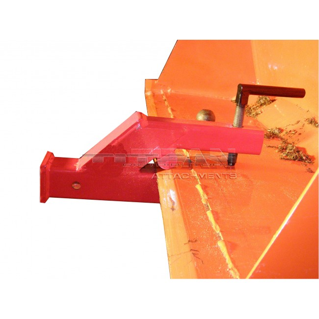

Has anyone bought or used either of these two receiver hitch attachments?
Trailer Hitch Receiver For Pallet Fork Frame
Also is there an adapter to allow me to move my 5th wheel. It has the king pin on the trailer, so I would need a locking sleeve of some sort attached to the 2" receiver.
I've got one of those that I use on the carriage of my Bradco forks. I've moved a 7x18 enclosed weighing about 5500 pounds around the yard with no problem. But then I'm using a skid steer, so I'm not worried about the weight being way out on the lift arms like a tractor's loader.
   / Trailer Hitch Receiver For Pallet Fork Frame #22
I would be tempted to have a 2" receiver welded to the inside and top of the bucket so that the lines of the bucket still look nice. If your ok with it welded on top you could do that too. Then just have a piece of two inch square with a piece of pipe welded onto it that fits over the fifth wheel pin. For a slow as you are going to move and the fact that your just moving it around the yard you don't need to worry about it falling off. The weight of the trailer will keep the pin in the pipe.
   / Trailer Hitch Receiver For Pallet Fork Frame #23
I bought this from Titan Distributors for under $100 to move my dual axle trailer around using my bucket not my front forks. It works for my needs, I don't know what you could do for your fifth wheel.
I had one of those a few years ago an absolutely hated it. Could never keep it straight on the bucket. With the least amount of pressure it wanted to kick sideways. Sold it for $25 just to get it out of my sight.
