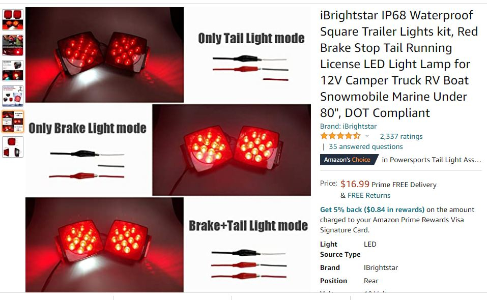

Hi NPALEN, back at entry number 76 you posted a picture of wiring that I presume came from ad, look at bottom example where it shows 3 wires coming out of fixture, if fixture only has 2 wires it doesn't have both tail & brake / turn light functions, they either gave you a bad set of fixtures or you got ONLY tail or brake / turn function fixtures; not both. the 2 wires; either brown / yellow or brown / green coming back can't be hooked together. if you can open fixture look and see if there's a third wire maybe tucked inside. There are dim and bright LED's for the 2 functions. Hope this helps,

Your wire colors were incorrect so maybe you have the the 'brake/turn' wires of the LEDs actually hooked to the running light wire?

I wondered about that so switched them and didn't make any difference. Should see a light either way though when the brake is depressed. Right?
I do understand that the lights wouldn't be as bright if they were wired backwards since only the "tail light LED's would be lighting when brake is depressed.
Will investigate further to see if I'm getting any voltage at the trailer light connector when brake is depressed. (probably not)

Check connector on truck first.... If its good, then trouble shoot trailer... IF brake pedal pressed you should have 12volts at yellow and green wires at plug on truck...
IF turn signals work at trailer the trailer wiring is good.... IF you take small 12 volt battery (battery charger or jump box) and a clip cord to connect trailer plug ground wire to minus (-) side of battery supply and use another clip cord to put 12 volts from battery plus(+) to each of the corresponding wires (yellow/green/brown) and proper LEDS illuminate on trailer, all your problems are in truck....
At trailed plug using just a 12volt battery (or battery charger)
put ground on trailer white wire
put 12 volts on brown wire, tail lights ( and side markers if equipped) come on.
put 12 volts on green wire bright LED for RIGHT side stop/turn comes on.
put 12 volts on yellow wire bright LED for LEFT side stop/turn comes on.
If you get these results your trailer wiring is good..... PERIOD...
