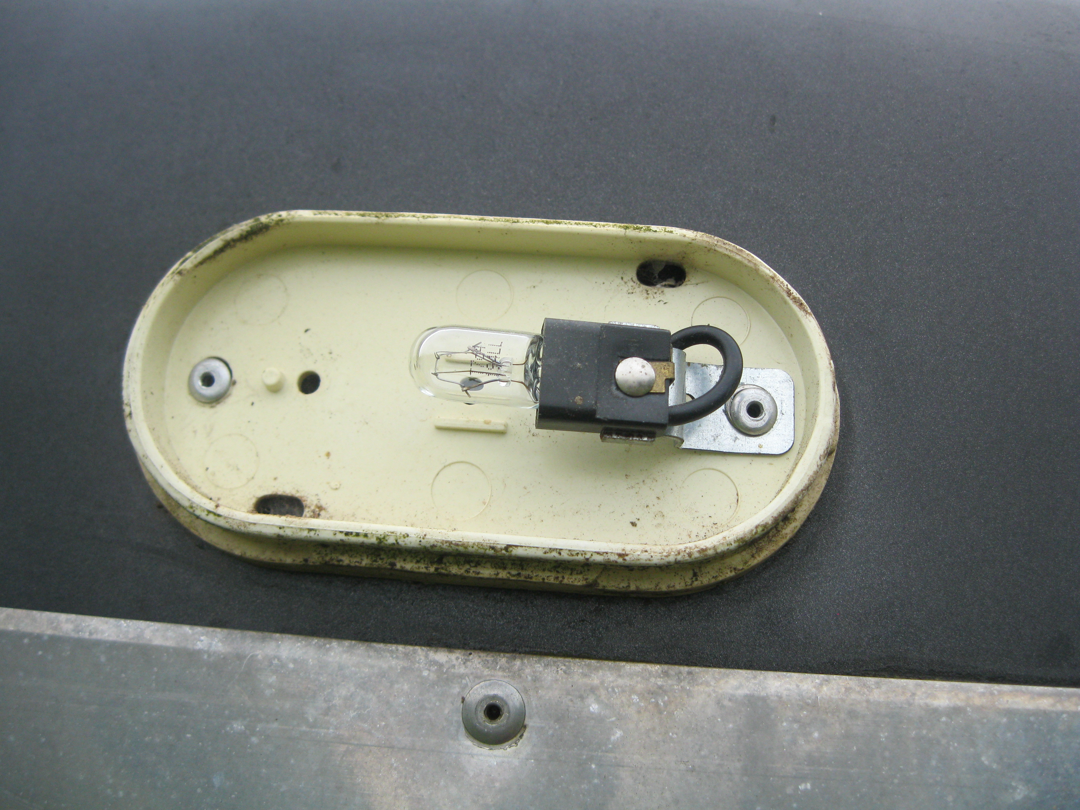

A couple of questions on rewiring, where do you ground all the wires to, trailer frame? Also, on lights like these, where the rivet is the ground, where do you attach the ground wire to light?
/ trailer lights #10
Does that fixture have a bare metal back where the ground contacts the frame, how does it ground normally? Maybe a ring terminal trapped between the backing and the trailer frame? As I understand it, the most common way of running separate ground wires is not wire OR ground through frame, but wire AND ground through frame, in other words don't take any extra steps to isolate the light grounds from the frame, just provide a better dedicated electrical path in addition so as not to rely on the frame ground.

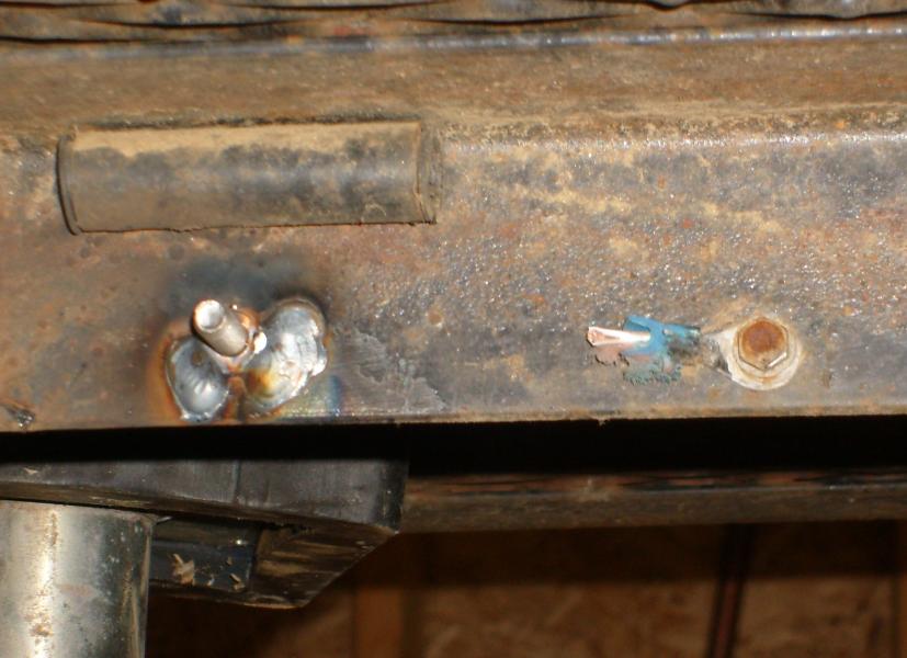

/ trailer lights #18
Do you have a small mig/ wire feed welder? Do yourself a favor and get some 1/4 stainless steel bolts and weld them to the frame near each light and near each axle (if you have brakes). Then run the ground from each light to the bolt. It'll never loose ground again. Counting on a metal contact touching the steel frame on a trailer will sooner or later fail as the bare metal needed for contact will rust. A number of trailer lights use the mounting studs as a ground as well. If possible I replace the steel bolt they use with a stainless bolt and then make up a short wire to connect the ground stud to the bolt I welded on the frame. While it's more work that running a ground wire to each light it's often easier on larger trailers.
/ trailer lights #19
Interesting solution, to say the least! I am wondering why you stipulated a mig/wire feed welder? Any welder capable of welding stainless should work fine to weld the bolts, I would think.
