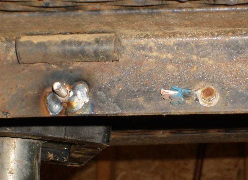

Do you have a small mig/ wire feed welder? Do yourself a favor and get some 1/4 stainless steel bolts and weld them to the frame near each light and near each axle (if you have brakes). Then run the ground from each light to the bolt. It'll never loose ground again. Counting on a metal contact touching the steel frame on a trailer will sooner or later fail as the bare metal needed for contact will rust. A number of trailer lights use the mounting studs as a ground as well. If possible I replace the steel bolt they use with a stainless bolt and then make up a short wire to connect the ground stud to the bolt I welded on the frame. While it's more work that running a ground wire to each light it's often easier on larger trailers.
Interesting solution, to say the least! I am wondering why you stipulated a mig/wire feed welder? Any welder capable of welding stainless should work fine to weld the bolts, I would think.
David from jax
   / trailer lights #20
David from jax
I think it would be difficult to weld with a stick, being such small bolts. A TIG would work just fine but less people have them where as wire fed welders are pretty common now. As long as you paint it you don't even need to use stainless wire.
