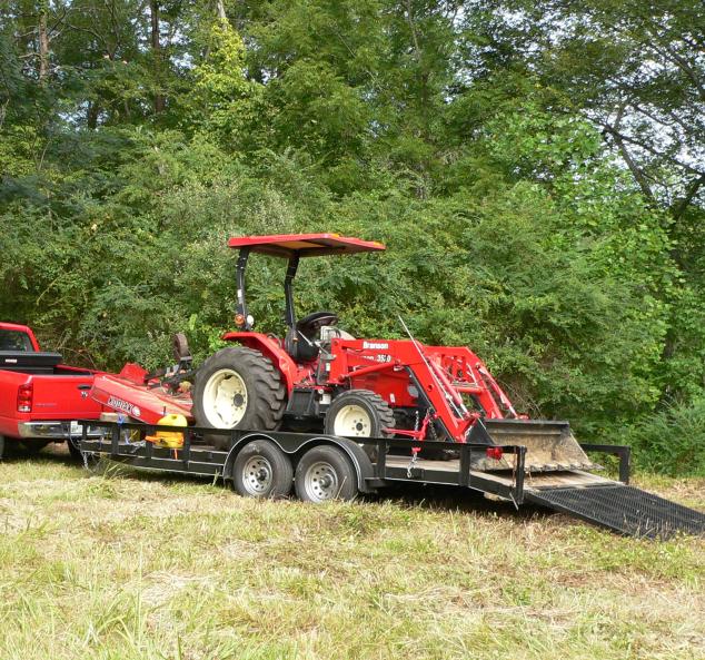

   / Trailer north or south #15
You can generally find a way to load it in the direction you want, while maintaining safe balance.
   / Trailer north or south #16
SnowRidge,
Did you scale that load in that configuration? It looks like it is not well balanced with too much tongue weight and probably too much weight on the front trailer axle. (It's real hard to tell from looking, super hard to tell from a pictue - so don't take it the wrong way. The only way to KNOW is to run across a scale)
   / Trailer north or south #17
john_bud said:
SnowRidge,
ROFL. No, I did not scale it. No scales between here and where the picture was taken. Precious little straight or flat road, either.
The truck is rated to pull 12,000 pounds. The trailer, tractor, and implements total around 7,500 pounds. The trailer axles are rated at 5,200 pounds a piece, and the truck sits nice and level with that load. In the photo, the front end of the truck is starting up an incline, which may make the back appeared to be squatting.
It tows beautifully. And yes, I do know what an imbalanced load feels like.
   / Trailer north or south #18
Ahhh, that explains it! Truck sitting up high in the front will make the tongue sit lower. Like I said, real hard to tell from a picture!
Funny, but my impression from the picture was of a larger heavier tractor. My Kubota L3410 looks about the same on it's trailer and with the Woods BB600 cutter, filled R4's, tire chaines, FEL, full of fluids the load is 9350# including the 2500# 18' tag trailer.
I like the way you have it chained down. Then again, I also use the ratcheting binders. They are nice and easy to adjust tighter after a short time on the road. Have you ever gotten any "guff" from the men in blue about the cutter? Around here some would jump on you where others wouldn't even take a second glance.
   / Trailer north or south #19
No, this is Tennessee. :p
The law is pretty reasonable. I have never seen anyone around here who is hauling farm equipment stopped. Not saying it doesn't ever happen, but I have never seen it.
The 7,500 lbs is an estimate. My tires aren't loaded, the trailer weighs 2,400 lbs. The cutter doesn't weigh as much as a Woods, I'm sure. I could be off a little. No more than 500 lbs, though. Still well within ratings. It is a 10K trailer.
