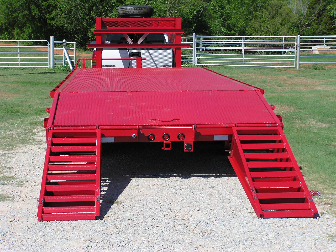

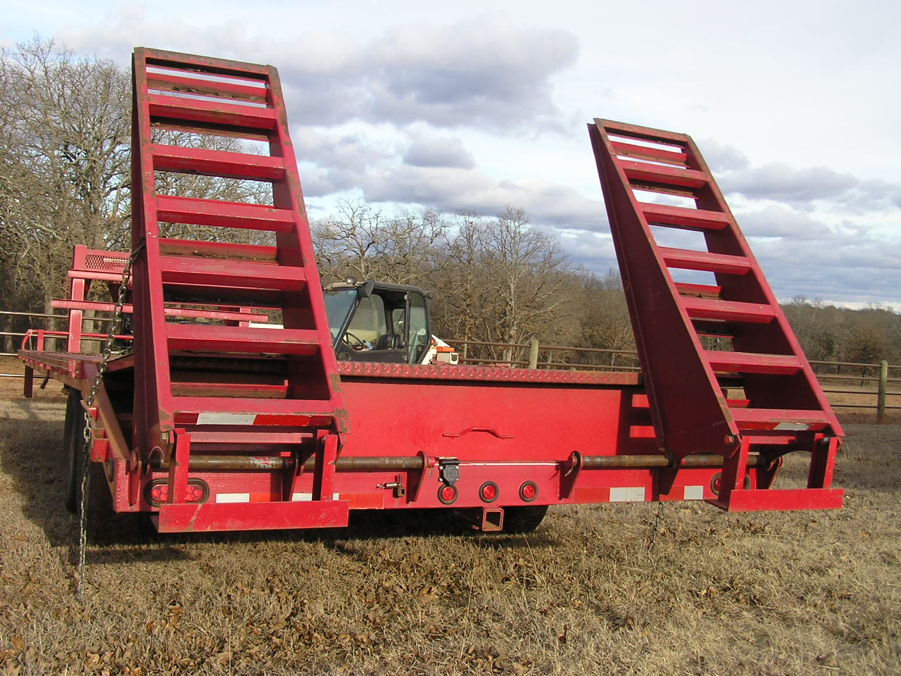

From looking at Xfaxman's trailer He must use that plug often for aux. lighting. The ramp support brackets are blocking the view of the taillights from the rear.
/ Trailer plug adapter #11
But if his ramps are slid towards the center of the trailer, the lights will be visible. Jon
/ Trailer plug adapter #12
Never had to use aux lights. The second trailer's lights are visible.
And the ramps do slide over.

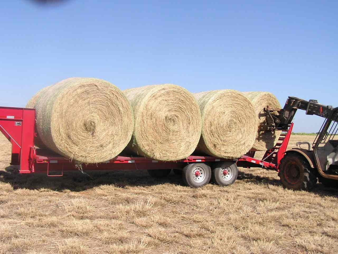

/ Trailer plug adapter #13
I agree that if the ramps are slid toward the center or flipped over completely the lights are visible. In the one pic posted they would not be visible if towed like that. I'm sure he must know that.

/ Trailer plug adapter #14
Yep, he does. :D

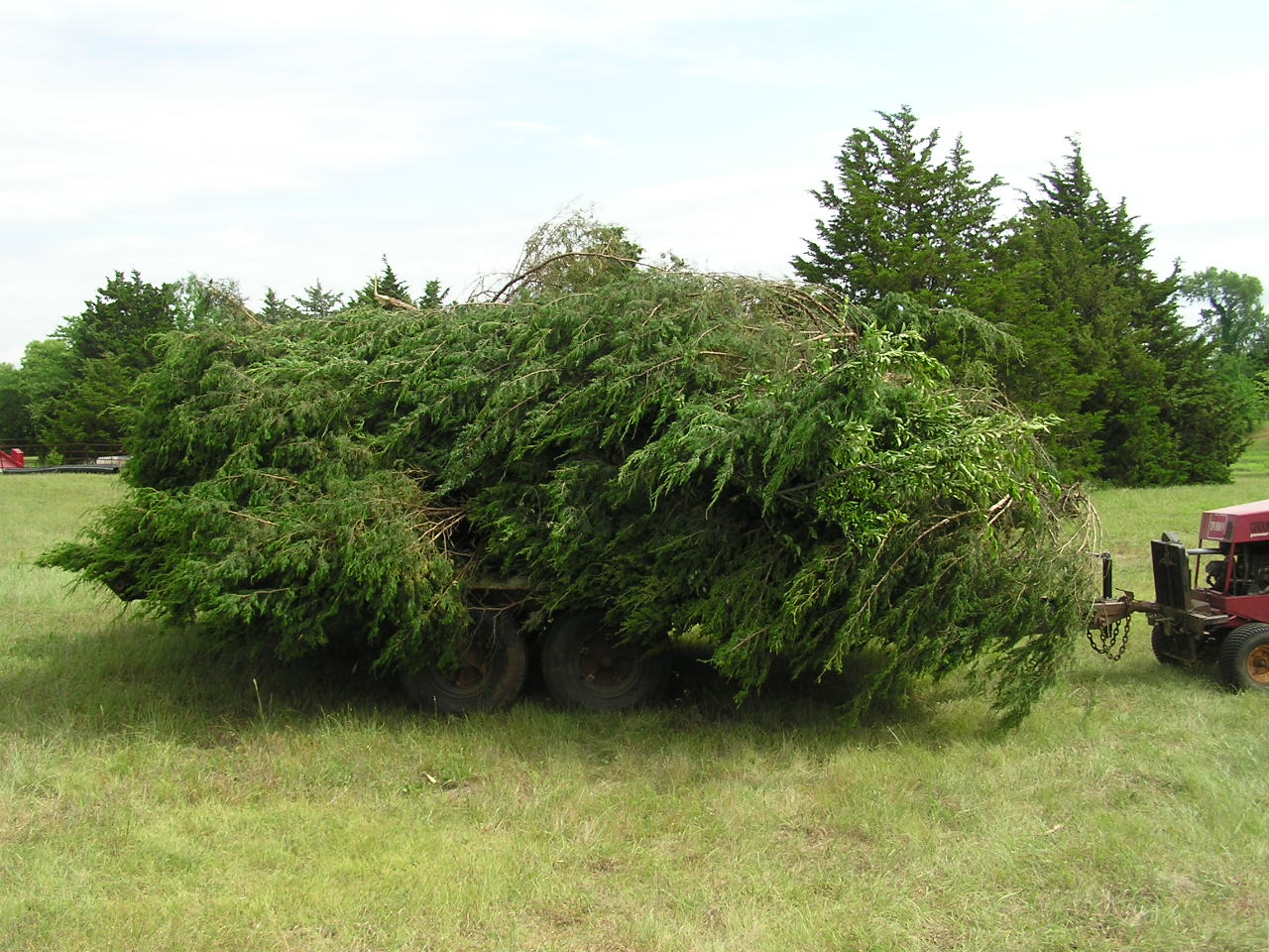

This is the second trailer that I hauled 6, 5x6 round bales on the 8'x16' deck.
It has tail lights.
This is what it was hooked onto.
Loading the seventh bale room for one more, About 11,000 pounds on the deck:
/ Trailer plug adapter #15
Yep, he does. :D
It has tail lights.
I am curious. Have you ever scaled individual axles when both trailers are loaded with bales? Dad pulls a fifth wheel camper plus a boat behind. I don't think he has ever scaled the axles out, but I know he has concerns on overloading the rear camper axle from the boat trailer tongue load. Jon
