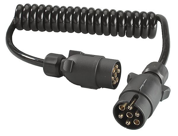

Put the same kind of socket that is on the car on the trailer, they are usually better protected with some lid Then use a short removable coiled cable with a plug in each end for the interconnection, and remove that and store indoors or in the car when not in use. All new trailers use that principle here now. Easy to change, easy to repair. I keep a spare in the car as well.

Good yo know SB and thanks for the info. I "Battery Saver" sprayed the internal connections after I inserted them in the plug terminals with some grease on the twisted wire. I then squeezed some black, flexible gasket maker where the wire goes into the socket. After a month of steady use, it is holding up nicely.
