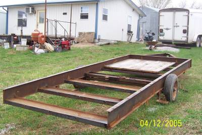

I've looked at 18 ft flatbeds and they run about $2600. 8 Lugs wheels.
I'm in the process of building mine. 18 footer. So far I have about $20.00 in mine, plus welding rod and gas for welder. I've just had to buy the spring hangers.
The axel on this one is not going to stay. I'm just using it to keep it in the air for know. I'm either going to use the axels off of my horse trailer that I don't use any more. ( just use for storage) or spend the money and get a couple axels. The only thing with the horse trailer axels is that I would have to lengthen them. Not big deal though as I've done that several times on other trailers.
I forgot to add that the formula for placing the axels is the front axel is placed 3inchs back of dead center. You can move it accordingly if you want more or less tongue weight . some even say 1 ft back of center but I liked it there.
that is my 2cents worth. mark

Thanks everyone. This is all good stuff.
I am well aware of the cost factor relative to purchasing, I just thought I might make a project out of it. I should have mentioned; I have most of the steel laying around, a degree in mecahnical design, a strong backround in steel fabrication and welding and have build smaller custom trailers in the past. I know how we all enjoy sharing in each others work so I will keep you posted on my progress, if I continue. I will probably create a whole set of working drawings that I will also share with anyone interested. At your own risk, of course.
