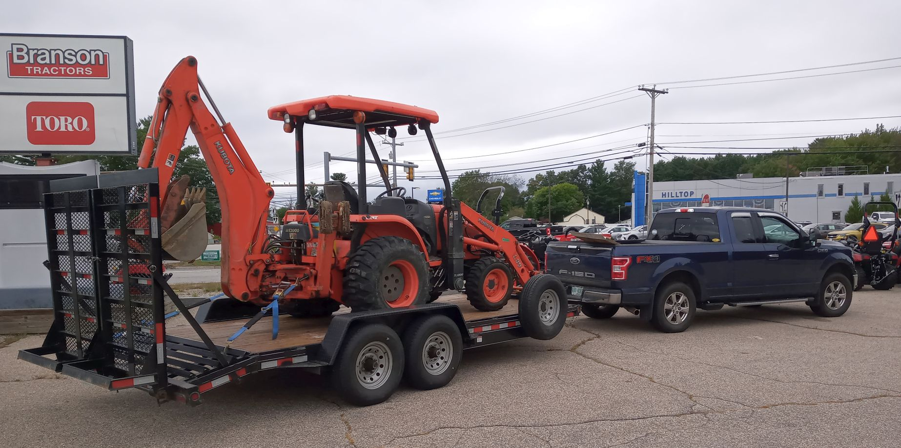

Photo of +11,000 Lbs. combined tractor & (12K rated) trailer with load towed by factory ordered F-150. Only18-20 psi in the air bags. This truck compared to older F150's, is totally different animal. However if doing on daily basis, a new 3/4 ton or 1 ton would be much better.
