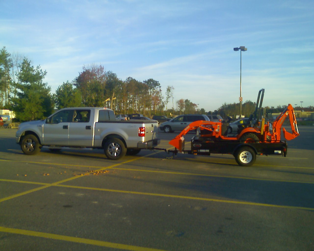

I have attached a photo of the new BX25, just after it was loaded on the trailer after we bought it. As you can see, it fit on the 5' X 10' trailer quite nicely, and with the extended receiver hitch, there was enough clearance in front of the FEL so that the truck would not be scratched when turning a corner. As well, the trailer os low, which keeps the center of gravity low, and thus it was very stable on the road. (We just went a little ways, to my cottage, but it felt very good with my F150 as the tow vehicle.) :cool:

OKay, so here's how I fit my BX25 on a 5' X 10' trailer, with room to spare for the ramps.
Yup...that's about how I remember it fitting in my 5' x 10' 3,500# trailer.
Not that it isn't great and all...I do remember being able to shove around my old trailer by hand (an absolutely impossible thought with my big trailer,as Mr. RobJ points out)...but seeing that picture absolutely reminds me of why I got the 20' long trailer.
At least you have brakes...that's a big plus. And having the dump is wonderful. I'd have to take two trips to the dealership to have my mower deck serviced...that was a pain. And I never figured a way to make the trailer feel "good" behind my truck (2005 Expedition) with the tractor loaded. Wandered too much. Tires were too "squished".
Looks like you have a 5 foot long draw-bar on your truck (I'm exagerating, but that sucker has got to be at least 2 feet long...), maybe that helps with the "feel"...funny, though. I never had a problem with the possibility of scratching the truck. When I got my backhoe, I'd load it the other way, though. Seemed to load my tongue better than FEL first.
Dunno. It's just me, but I just wasn't comfortable towing my $20,000 machine on a trailer that 'just made it'. As nice as yours looks and all.
I'm just a fan of the safety factor...150%...towing a 3,000# machine means I MUST have a trailer capable of being loaded with 5,000# of payload...add the trailer weight and you are right there at 7,000# every time. And you get two whole entire extra tires added to the mix to boot.
