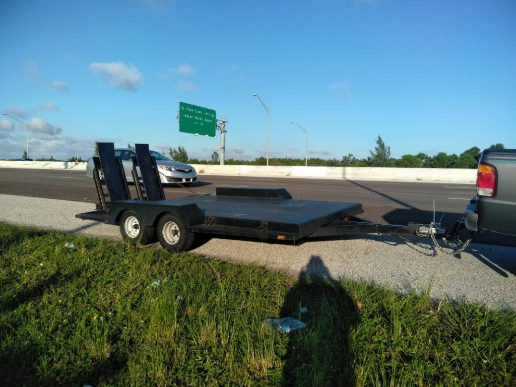

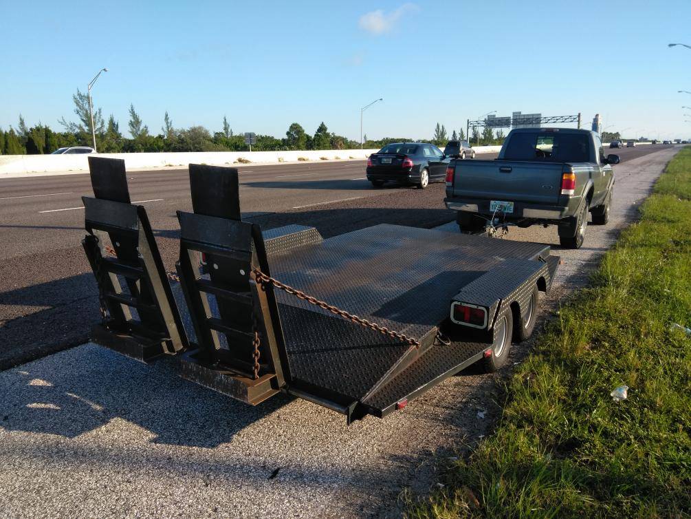

Some months ago I bought a trailer off Craigslist.
On the way home with the trailer empty and hooked up to my Ford ranger it started swaying from side to side really bad.
So bad I had to stop get out of my truck and scratch my head.
I got the trailer home, put new tires on it because the tires were worn on the inside terribly, that made no difference.
It's a very heavy duty trailer commercial grade.
I can't post pictures now because they're not saved on my phone, I'll post some tonight
Dual axle it was built to haul one of those high reach machines
I'm thinking that because the two ramps on the back are so heavy and stand straight up that the windflow going down the road is just picking up the back of the truck and causing the problems I'm having.
At this point the ramps the way the trailer was built can't be positioned any other way..

My understanding is that trailer swaying is the result of inadequate tongue weight. I doubt the wind flow around the ramps was the cause. Other experts will be along shortly.

A properly designed and maintained trailer should tow fine empty. I think you are on the right track to suspect axle problems, particularly when considering the poor tire wear.
There should be 10-15% of the trailer weight on the tongue. I personally use a hydraulic scale (Sherman?) to check the tongue weight, then marked the trailer bed for various loads. For one time loads I listen for the metal clunk when the trailer hitch comes down onto the ball, then move forward enough to see the truck squat a little bit.... Not very scientific, but at least I know there is some weight on the tongue.

Worn on the inside could mean the trailer was ran overloaded. Possible bent axles.
/ Trailer questions #6
As the others have said usually needing more tongue weight.
bent axles from overloading or running with loose wheel bearings

Post some pics of the trailer when you can.
10" wheels? Sounds kind of small to be hauling your tractor.
Is this a homemade trailer? Axles may be placed too far forward not allowing enough tongue weight.
All 4 tires worn down on the inside indicates axles may be bent possibly from overloading.

You talk about the HD trailer, made to move bigger equipment.... and your pulling with a Ford Ranger. God bless that little Ranger.
The empty trailer is typically light on the front compared to when loaded, so very little down pressure. The trailer is HEAVY if it is like you have me picturing. The empty trailer could be anywhere from 1,800 to 3,000 lbs alone. Likely nearing the capability/capacity of a mini truck!
Backing your tractor on the trailer is preferred especially if the trailer is shorter and you do not have deck to allow you to drive the rear axle at least to being centered between the tandem trailer axles. You do always want to "front load" a trailer a bit, so if pulling the tractor on, getting your tractor rear axle centered over the pair of trailer axles would center your heavy rear end and the front axle weight (not nearly as much) would be transferred partially to the tongue/truck. If the rear axle was behind the trailer axle center line, my opinion is that it was loaded wrong.
If you back it on the trailer you are pretty much ensuring that you are front loaded... or heavy to the truck. The problem here is (not trying to be offending at all) you do not have a truck sufficient to handle much front loading weight. You'll squat the bajeezus out of and possibly bottom out that truck pretty fast. I had a 2001 Nissan Frontier that I once thought I could MOVE my 24.5' car hauler with in my driveway. I was wrong. I screwed the trailer jack up and the trailer frame smashed my truck until the trailer sat on the asphalt! It was not a "real truck", and I suspect that your Ranger is facing the same dilemma!

That is a very unique looking trailer. I suspect that you are on track thinking that the lack of tongue weight is causing your problem.
How much does the tongue weigh when the trailer is empty? Is it something you can pick up by hands or do you have to use the jack? Will the ramps flip forward any further then you have shown in the pictures?
Generally speaking, a tractors front to rear center of gravity is right about where the steering wheel is. As such, you would want to have that be just forward of the front axle on the trailer. Most of the time that means that you need to back the tractor on to get the center of gravity in the right place to make sure that the trailer has more weight on the tongue then on the tail.
I like to use a tape measure to check and make sure that I have tongue weight, I measure the distance from the hitch of the trailer to the ground (or the back bumper of the truck to the ground) and from the tail of the trailer to the ground.
Both should be closer to the ground but the tongue should go down a little bit more than the tail does.
if you look on a tires, do they have a weight rating listed on them? I agree with those who suspect that the axels may be bent to cause wear on the inside of the tires.
When the trailer is level side to side, if you stick a short level on the side of the tire does it say that the tires are level?

Trailer axles are actually cambered positive (top of tire outward) at the top while unloaded, or the tube is arched upwards to the center. This is so that as you load the trailer the axles take the load and deflect, thus giving up that camber and being somewhere nearer to level across the wheel/tire. It's a poor place to use a level because empty it should not be level across the tires. At some load weight, it could be perfectly level.... pass that up and you go camber negative (top of tire leaning inward).
The inside edge of tire being worn is an indicator that the axles are not running true, be it bent or worn brackets/bushings. But the tire is "scrubbing" sideways, I bet the tread blocks are pulled and have a sloped ramp like wear pattern? If so, you have issues. What they are would be tough to say as a keyboard warrior who can't inspect the bolts, brackets and bushings for wear. Something is not being maintained in alignment though.

Whipping or swaying is almost always caused by inadequate tongue weight. The axles look to be placed correctly so the tongue weight should be sufficient when empty. Before going to replace the axles, just remove those massive loading ramps and take the trailer for a spin to see if it still whips. Those things are large enough to act as a sail back there to pull the weight off the front of the trailer. Being as massively heavy as they look, and the full plate decking on them, they are going to offset the tongue weight considerable especially at higher speeds when wind resistance starts to lift the front of the trailer.
The tire wear could be just from hauling overloaded and not necessarily bent axles (although that could be another problem). Unless you are going to be hauling massive equipment (which would overload the axles anyway), get rid of those super duty fold up ramps, build some slide in type (maybe use a portion of the ones on the trailer minus the sheet metal) that fit under the rear of the trailer so as to avoid the wind load which really eats on your fuel mileage.

A few things come to mind.
1. Your truck is way, way, undersized for that trailer.
2. That is a very heavy trailer. 2500 to 3000 lbs.
3. If you can easily lift the tongue, the weight distribution is off.
Even if you get the weight distributed perfectly on the trailer, your truck is still undersized. Any small movement from the trailer will push your truck around. Your Ranger is far too light.
