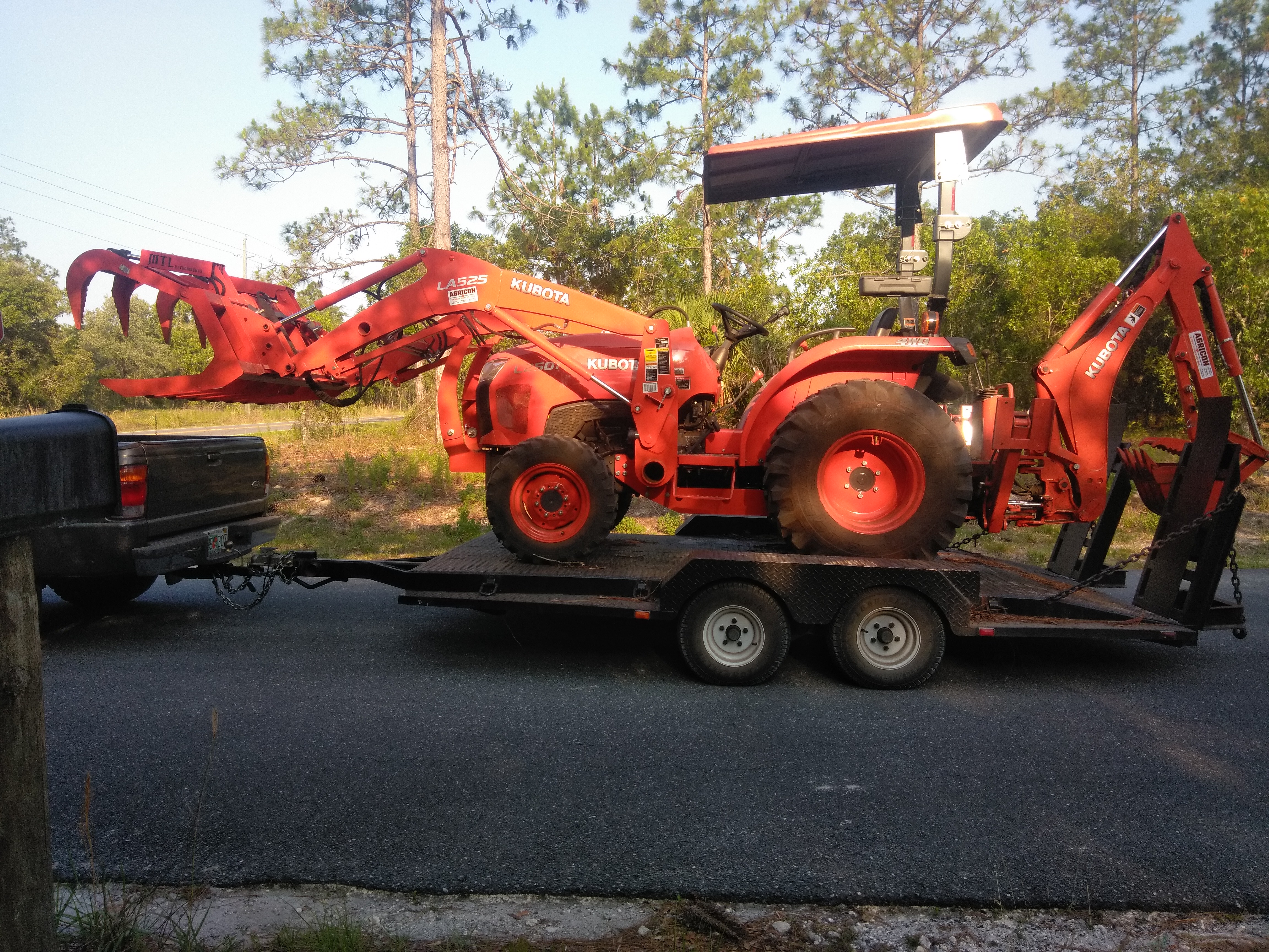

I tow my 18ft car hauler with B2650, la534 loader, BH77 backhoe, with my 2006 4.0 L V6 Toyota Tacoma, tow package springs and shocks, I believe 6500lbs rated. Calculated about 5500lbs trailer and machine total. Rides beautifully! It's a way lighter trailer than yours, about 1800lbs, but my "compact pickup" does just fine. No rushing, properly weighted tongue, properly adjusted dual electric brakes, properly inflated tires... Etc... I don't have a scale to check the tongue weight, but I compress my truck rear springs to put the truck axle to about one inch of the rubber bumpers.
/ Trailer questions #27
Your trailer definitely needs some attention. I don't know what's wrong but I know your little truck should be able to pull that trailer empty. Your trailer looks a lot heavier than mine though, so I can't say you should be able to tow your tractor on it.
I used to tow an L2650 (2500 lb tractor + another 2000 lbs for loader and backhoe) behind a 1995 S10 ZR2 without trailer brakes (extended cab, 4WD, V6). The trailer registration says 2100 lb empty. I tow it with my 2016 Colorado with trailer brakes now.
I will say I go slow and just let the engines rev up on the hills, but both trucks have handled it fine. And other than the trailer bouncing straight up and down while empty, it's never swayed side to side on me. Here's a picture of it behind my Colorado: IMG_20160515_171133794.jpg

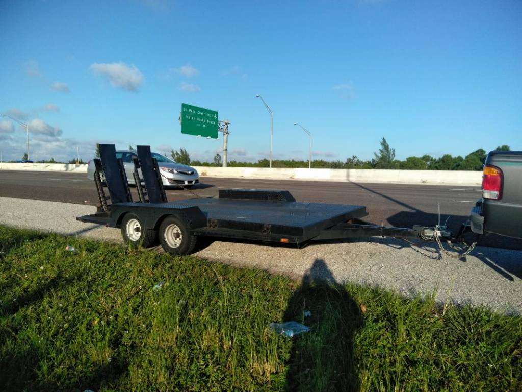

The build is actually awesome .The frt/back ratios look OK to my eye.
Here are my thoughts.
The ramps being full plated might be the actual cause as they are more or less wind catchers.
I'd be very tempted to remove them (if easily done) and try another speed run.
My 2 cent guess is the problem lies there.
They act as wind anchors, so to speak.
Otherwise the ratios look good.
And, please let us know of the results.

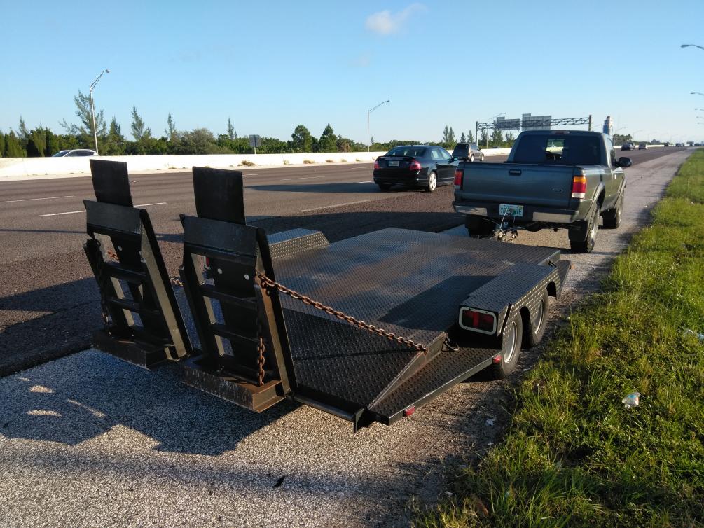

Boy you found the button for flushing out expert opinions ! Appreciate your candor in the OP saying you don't know how to load a trailer. You now have north of 30 posts telling you how to do things, acting like safety experts, etc. In there somewhere are several very good pieces of advice and worthwhile assistance. I'll stick my nose in and summarize (which is OF COURSE my opinion.)
[Note: I wager this trailer was pulled behind a dump truck in the past, hauling some sort of heavy gear by people who would never notice if it were fishtailing, could not see back there, would get the load about right just by eye ball in less time than reading this & couldn't care less...]
1) Yes, too little tongue load is why you were fishtailing whether loaded or empty.
2) At legal highway speeds aerodynamics was never a part of your problem and won't be.
3) There are too many rabbits mentioned to be chased. One at a time. The faults in the trailer, the light loafered truck, the which-end-goes-on-first, etc. All rabbits to be chased or in some cases discarded as irrelevant.
Easy one first: It flat does not matter which end goes on front or back. Any way is OK as long as you have adequate tongue weight. As another suggested, yank those hefty looking ramps off, tie them on the front of the trailer and it better tow empty without fishtailing. If not, stop until you find out why.
Two: Trailer fault is unlikely -- tire wear may be abuse or they may be the worst tires pulled off 3 other trailers before the thing was sold to you. Worry about that last.
Three: That poor little maligned Ford Ranger. As described so far, your task is non-commercial, occasional, hauling an L2501 which weighs around 2500lbs. No, the loader is not adding 1000 lbs. No, that trailer probably does not weigh 3000lbs. Go weigh it if it seems important. Assuming you tow the empty trailer OK now, I say you can also tow the L2501 with loader on it provided you get the CG far enough forward.You might have to back on to the trailer in order to get decent tongue weight. I suggest use a yardstick and measure the hitchball to ground distance first with empty trailer and then with the "initial try load position." Aim for a drop of around 5 or 6 inches at your hitch. Whatever leaves the rear axle of the truck at least an inch or so (as another guy suggested) from the rubber stops. Play with that a little moving the load fore and aft until it is lowering the hitch to the level just described. You will then be just fine towing with the Ranger in "easier terrain," staying out of the bigger mountains, etc. Either have good brakes on the trailer and a well-adjusted brake controller on the Ranger or else leave 15 extra car lengths between you and where ever you plan to stop.
Fourth: If all this "let's try it" fails for some reason (I don't think it will...) then you said you have bigger trucks. Use them. End result may be using the Ranger for short hauls and lighter cases and switching to the heavier trucks when you have extra load, longer hauls, steeper hills to pull, etc. You'll figure that out.

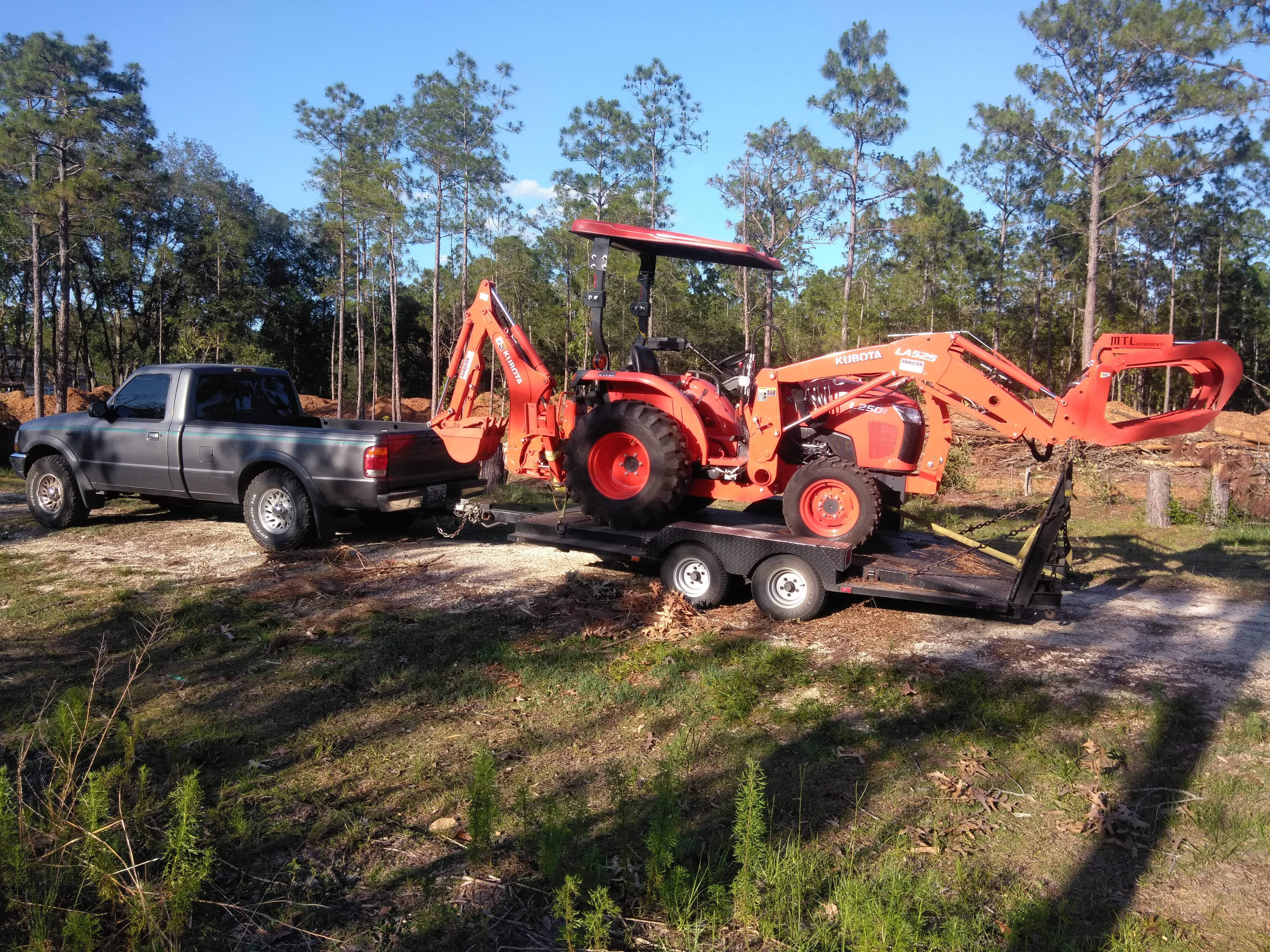

I appreciate all the comments, just got home now and am back online, I brought the trailer home with me along with some other projects I plan to tackle before going out to the property again.
I drove the trailer 130 miles home at 60 mph without an issue, Im not gonna say I never felt a little queasy but for me Im a little hypersensitive to fishtailing a trailer cause of a past negative experience.
tent
I plan to read and re read the comments in this thread and figure out what the problem is, first I will start with cutting the ramps off and making them so that they are able to fold down onto the top of the bed.
I brought home my small Kubota for some much needed love and attention. I guess the way I had things set up was just right.

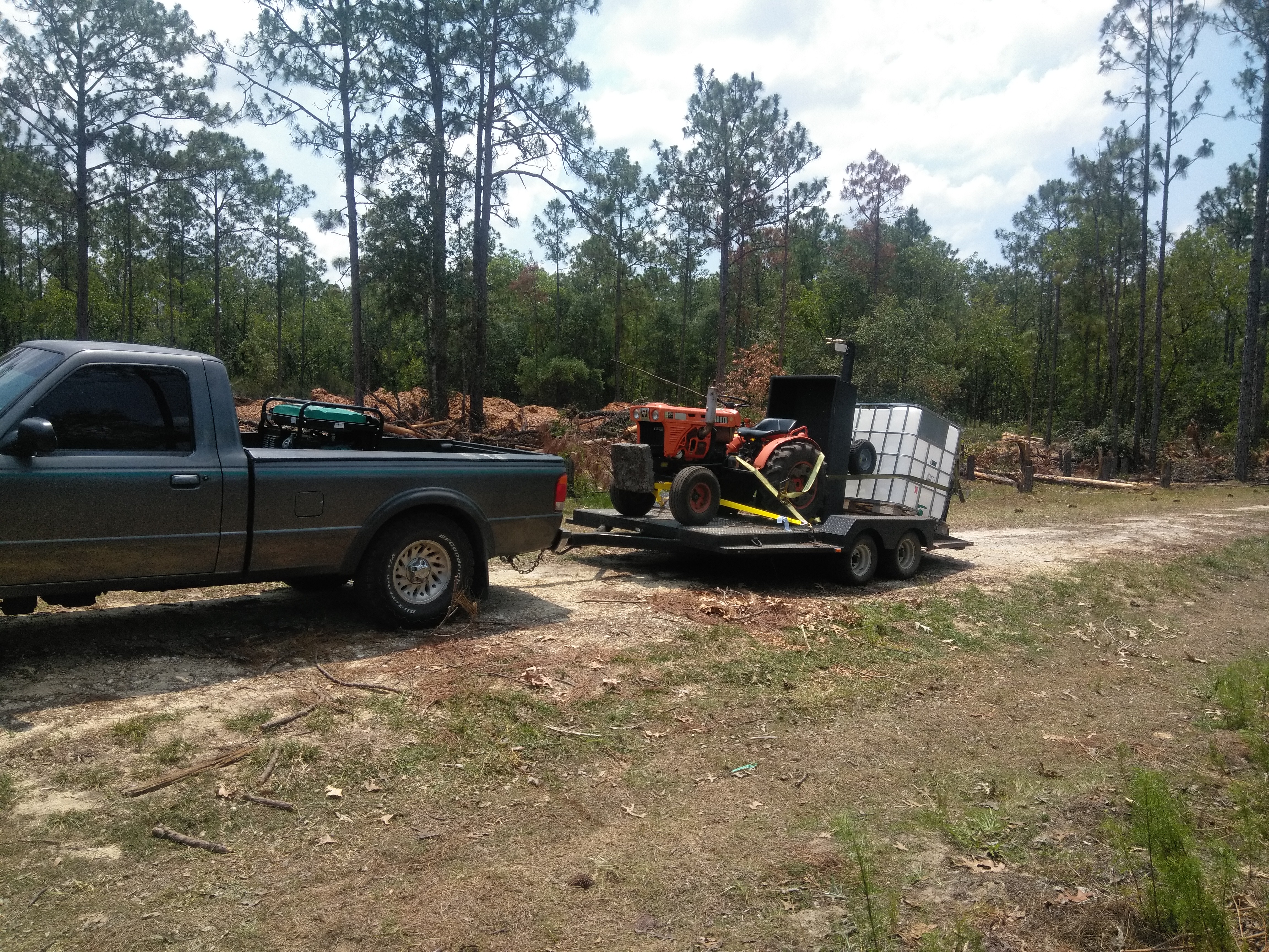

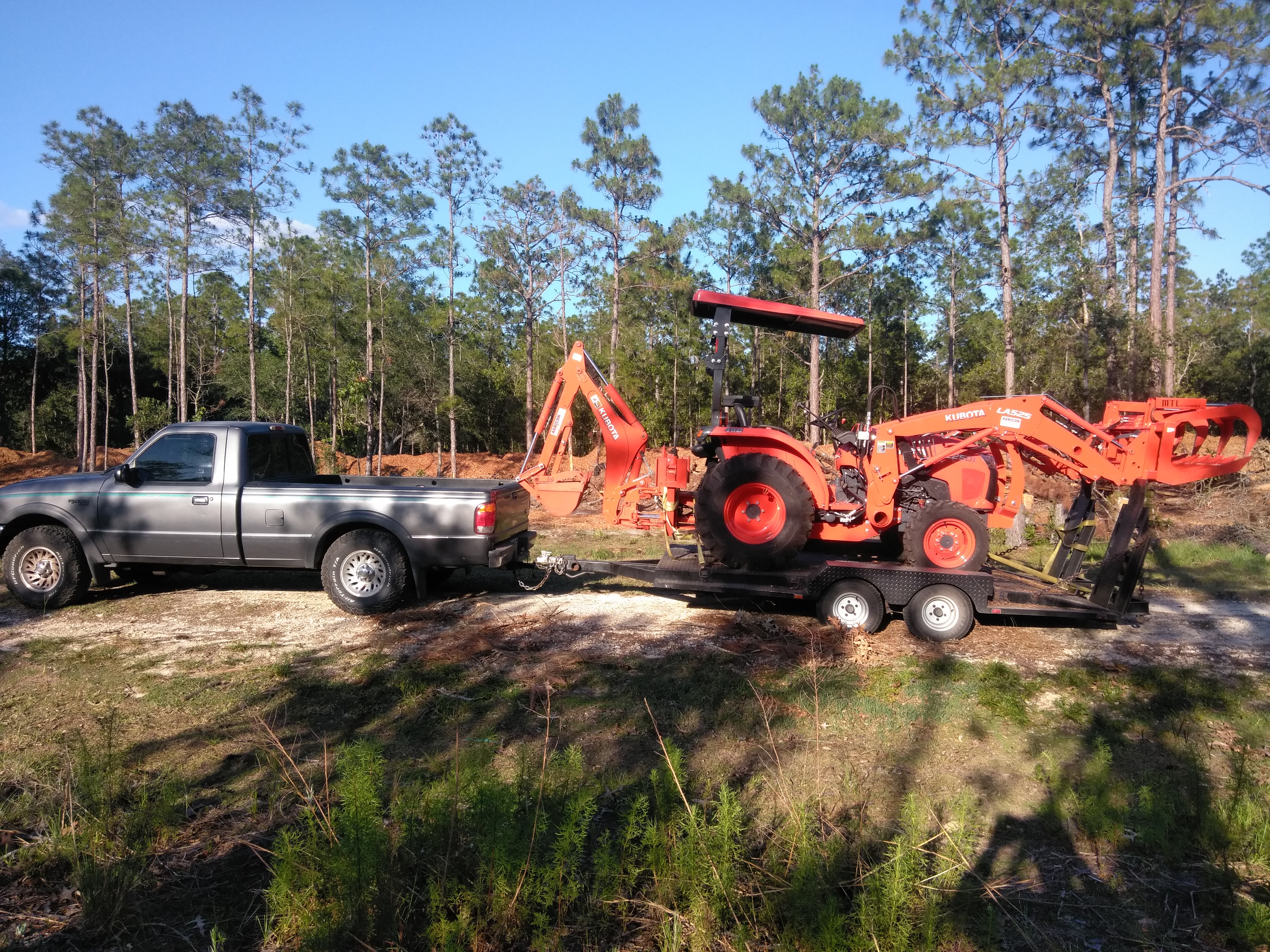

This on the other hand wasnt happening.
Taking it to a water supply down the road and anything above 20 had me changing my shorts
The last pict is where it actually rode best, 25ish MPH seemed OK
