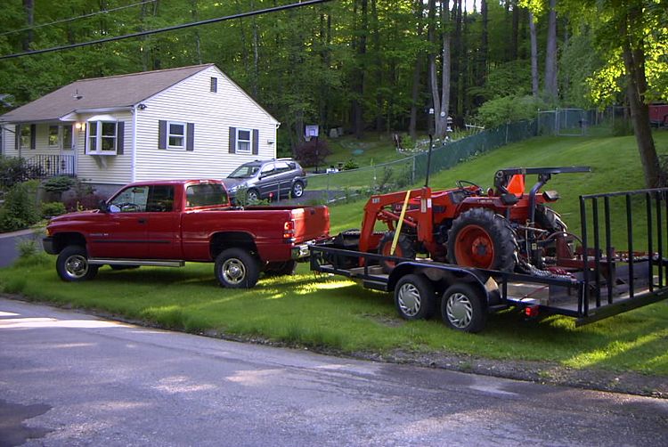

   / Trailer ramp modification suggestions #15
Greg - Hi, I've got a 16' landscape trailer with a drop down gate. Doesn't even flex when I go up it with my 3,000 lb + tractor & attachments. The "screen" was ripped up pretty good when I got the trailer, so I use a 3/4" sheet of plywood instead - works great.
