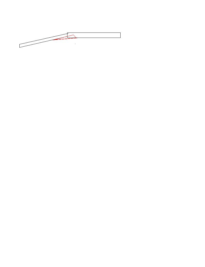

I also think you should add a little more plate or bracing on the bottom where your addition meets the trailer. I attached a rough (very rough) drawing of where to add plate / bracing in red.

BTW I do plan on welding braces under the dovetail for added support.

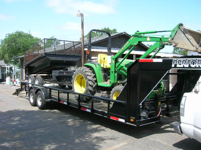

That's why I changed from this 18' flatbed bumper pull to the 24' G/N. Now, it'll also let me transport a couple of attachments along with the tractor with room to spare.

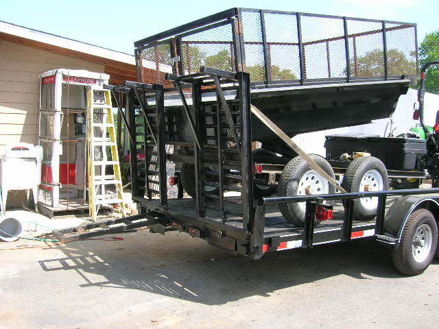

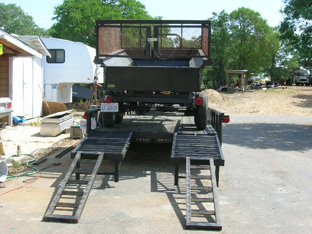

   / trailer ramps for dovetail #29
George2615 said:
I also think you should add a little more plate or bracing on the bottom where your addition meets the trailer...
Well I decided to modify my dovetail to a fold up ramp. The reason is that I couldn't double tow the hydraulic dump trailer behind the gooseneck trailer.
Originally, I had an EZDump bed rated at 3tons in my dually pickup. Then when I bought the 5th wheel RV, I had to remove the insert dump. I then built a trailer and mounted the insert on the trailer. Here's the results. I'll still need to tweak the bracket to hold the ramps.
As you see in the bottome pic, the original ramps stows underneath the trailer.
When there's a will there's a way ;)
