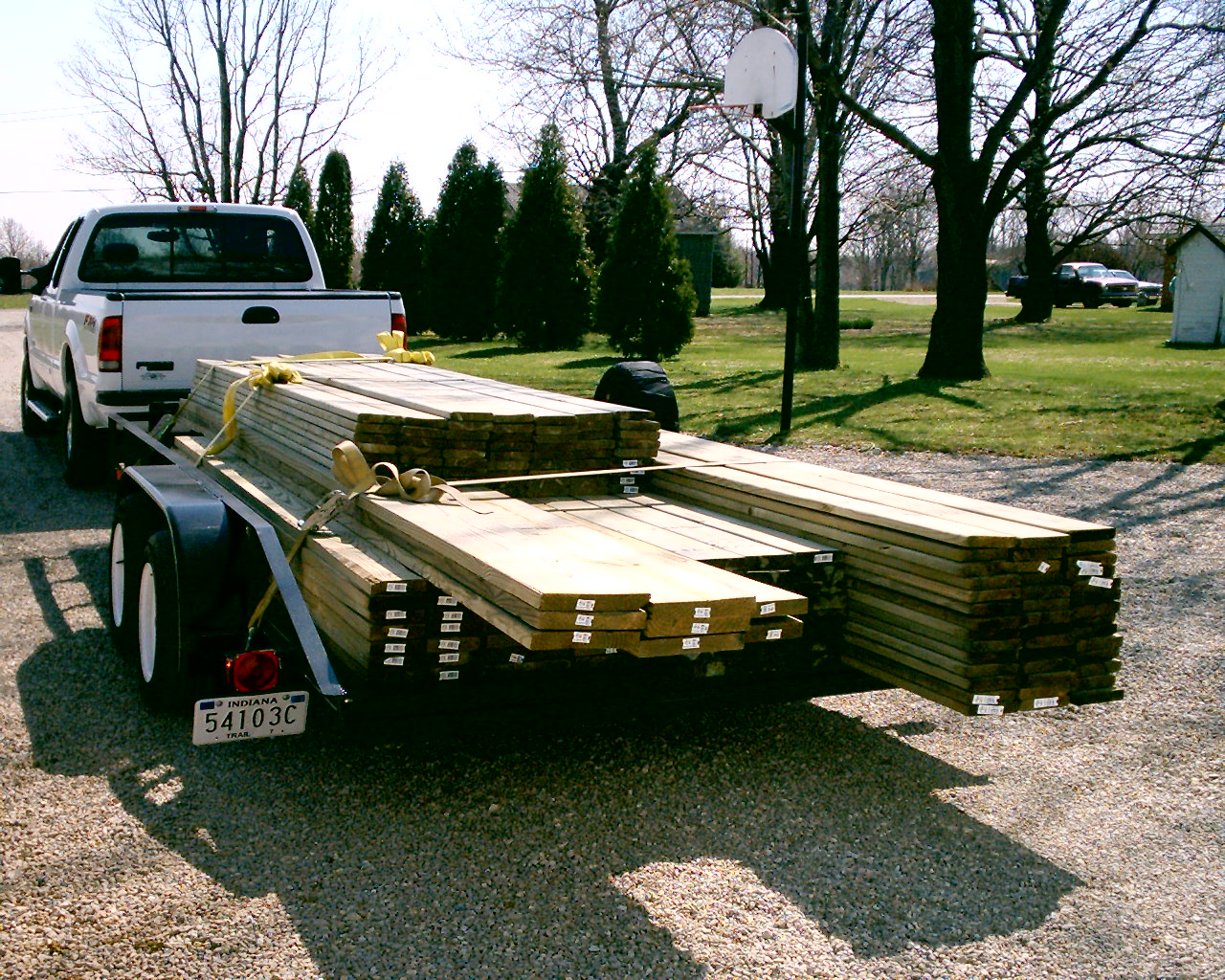

In all actuality you have plenty of truck. Get a 16' or longer landscape or car haul trailer. The landscape style is very handy for all types of task. Mine is 18' by 82" between the fenders and handles my 5,200# tractor fine. I have also hauled all types of vehicles including my fathers Corvettes and as large as a friends Suburban. As for brakes, the second axle is usually very cheap to add, around $135 from the dealers I go through. The first axle is around $250 for the brakes, wiring, plug, and break-away and battery.
Judging by your screen name I am guessing you are in Alabama. Visit there often for work. Plenty hot. Really though if you would like some info on trailer manufactures I can put you in touch with some in South Eastern Missouri if its not to far for you to drive. You will save a ton by buying directly from them.
Chris
