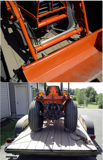

PGR, Here is how I do mine. (SEE PHOTO) I have since gotten ratchet binders, which I like much better! I use 5 /16" grade 70 chains which are rated for 4700lbs.
