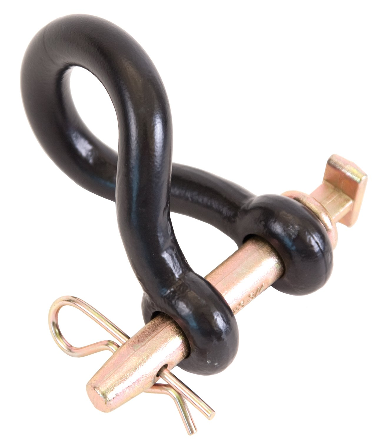

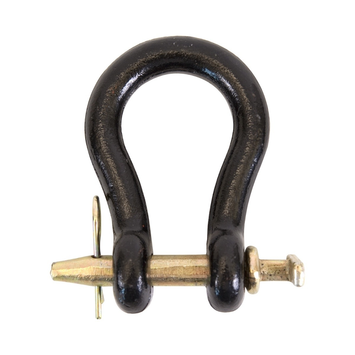

So the chain goes through the twisted clevis hook? Where did you get that?
A twisted shackle is a safer option than the twisted clevis. Rated at a much higher load because the pin isn't free to move around. Make sure the pin diameter is close to the size of hole in your draw bar also

makes sense, Does the twisted shackle attach at the lower link of the 3 point and if so mine is a category 2 so 1 1/8 diameter cant seem to find a twisted shackle beyond 1/2" I am pretty sure I dont know what i am talking about Help :)

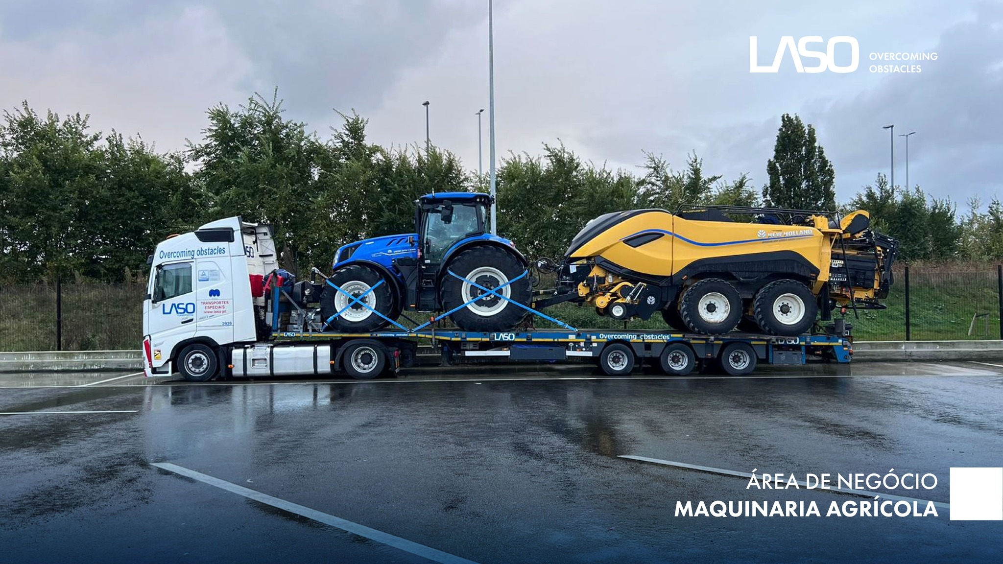

This is how they do it in my neck of the woods. Just 4 simple straps and it ain't going anywhere. (Baler is tied down too) No heavy chains to drag around or need for fancy shackles.
I often see threads where people claim that tractors don't have good tie down points or something. I don't really understand where they get that from.
Agreed, if it has tires you have tie downs, if the trailer has tie locations. Some trailers suck.

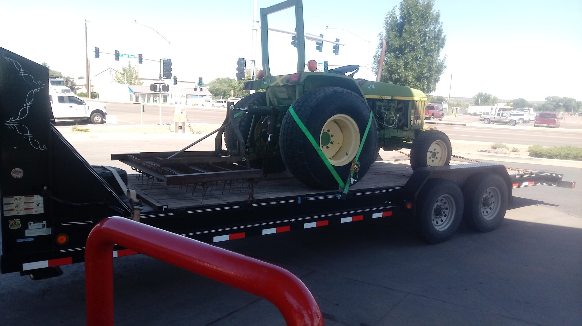

great pics and awesome info. I have been looking for bonnets for tractors and not much out there, You showed how it is done:) I do have one question. 1 post i read talked about the fact that having only 1 ratchet pulling in 1 direction would be an issue as pulling a trailer you have stress when your starting in one direction and stress in the other direction when you are applying the brakes.
I guess a guy could take and cut off the end and add a second ratchet so it is pulling in both directions. I like how you were able to secure the back tires as well.
I am probably over thinking this but I know myself and If I lost a load and injured or even killed someone i would not be able to live with it.
Yes, if you look close, you will see a chain front and rear pulling both directions. Then the strap is doing the same thing.
